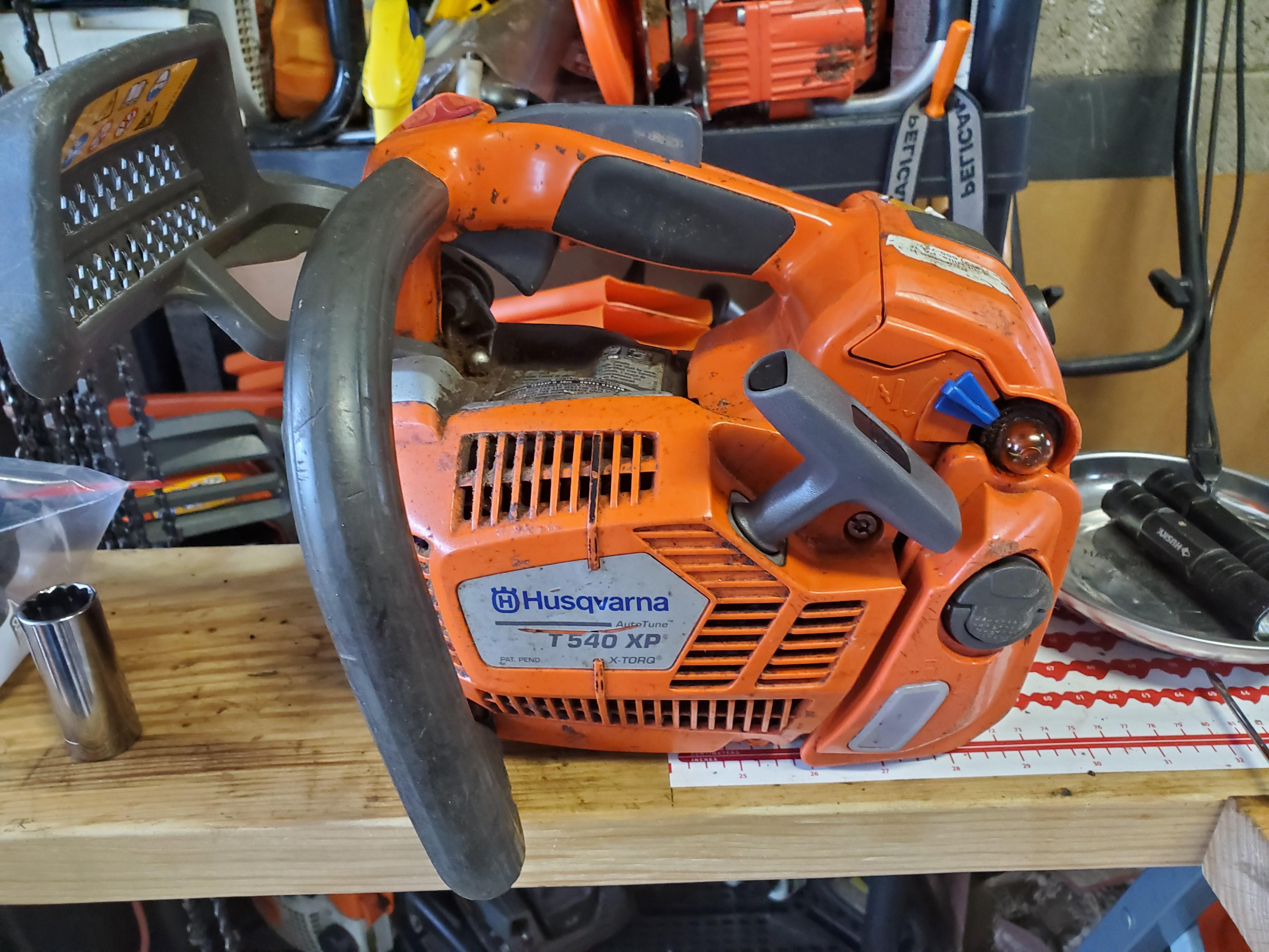

Got the last of 3 t540xp's on the bench now. Getting a new plug, fuel line and filter, impulse line, recoil rope and handle. Its also getting a much needed cleaning as well as a muffler mod and timing bump.
