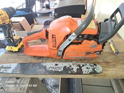

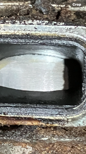

2007 husqvarna 353 from fleabay. Listed as having "low compression." I read that as "needs new top end."
Always nice to get a bar and chain.
I won't post the grime shots from inside the covers.

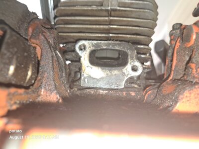

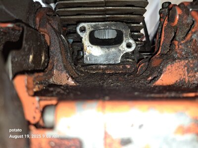

I think we found the compression problem.
Photo is terrible, but it looks like a wee bit of transfer. Let's hope that's all. Next up: pressure/vacuum test and a bath. Then its time to practice new skills, and sharpen rusty ones! Oh, and buy an ultrasonic cleaner.

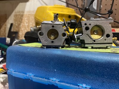

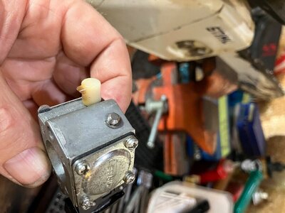

I think it's on a metal tube that is pressed into the body. You should be able to yank it out and replace it.
That's what it is. A little brass piece with "gnurling" it slides onto. Have a source? I don't care if it's one solid piece, just the plastic 90 or brass piece and 90.

Shoot. I’ve had a hard time finding 194’s. The dukes makes some clones that have worked for me.
Yeh, may go that route. Rather not over this little plastic part on what appears to be a perfectly good oem carb.
And it ain't like I don't have anything else to work on.
Think I got it. Picked up a fuel line from the dealer this morning and they gave me a couple of used carbs that had similar inlets. One of the carbs had the same body as a wt-194, but had a choke.

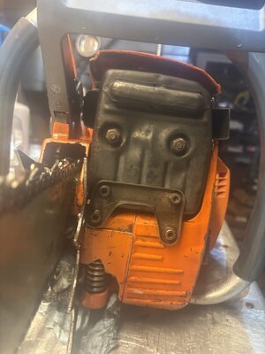

Echo cs 4910
Had 1 hr. epileptic seizure with a burr grinder. Sealed the cylinder down with hylomar blue. Got that hylomar sht in my hair, on my face, and in my nose when I went to pick a booger full of metal chips. Cleaned my hands off with old gas and had a bag of doritos. I did lick the cheese off my fingers and could taste a little hylomar blue.
14200 rpms burblin rich and burble cleans up in the cut. 12000 rpms in 16 in diameter birch.
