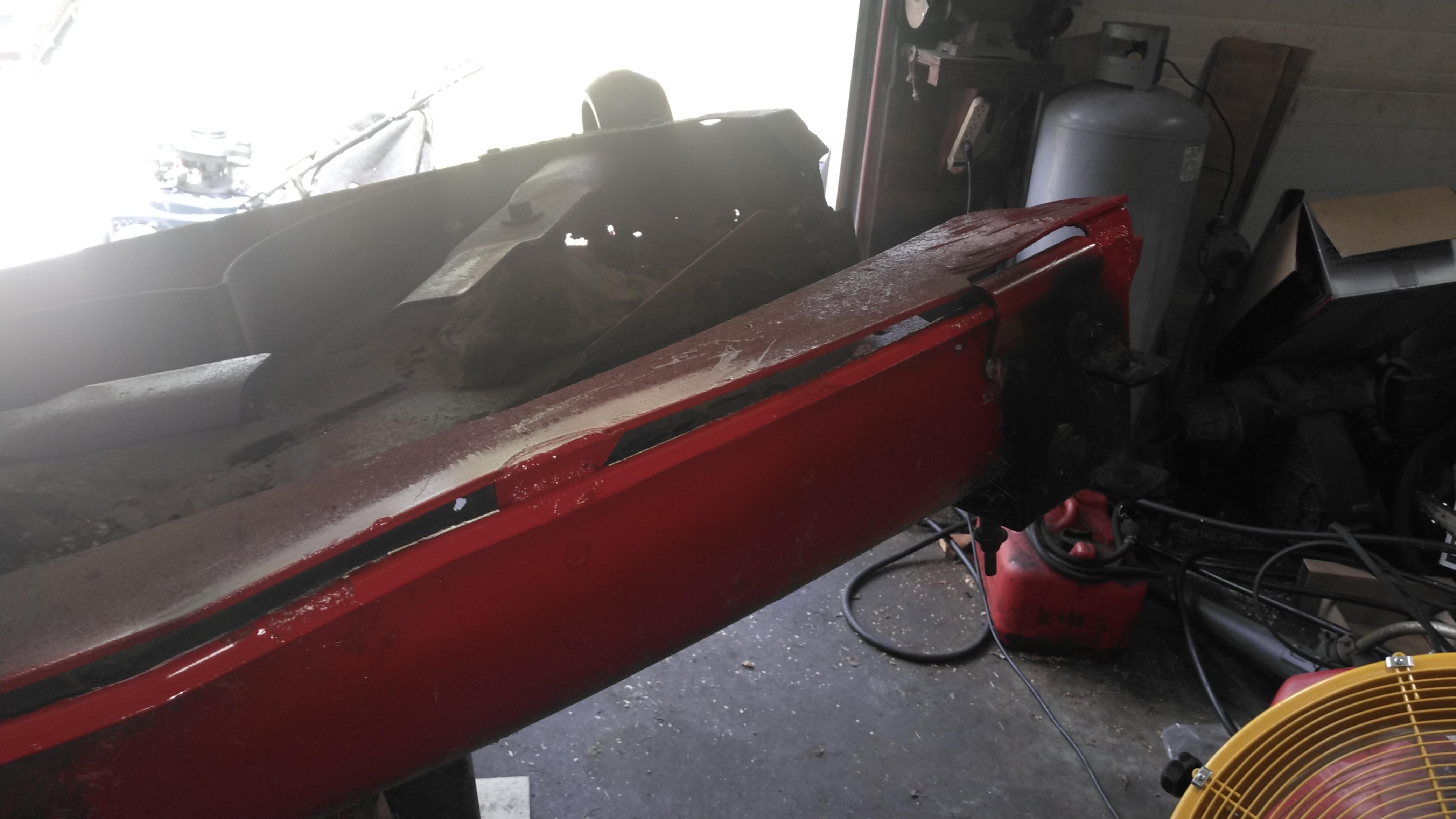

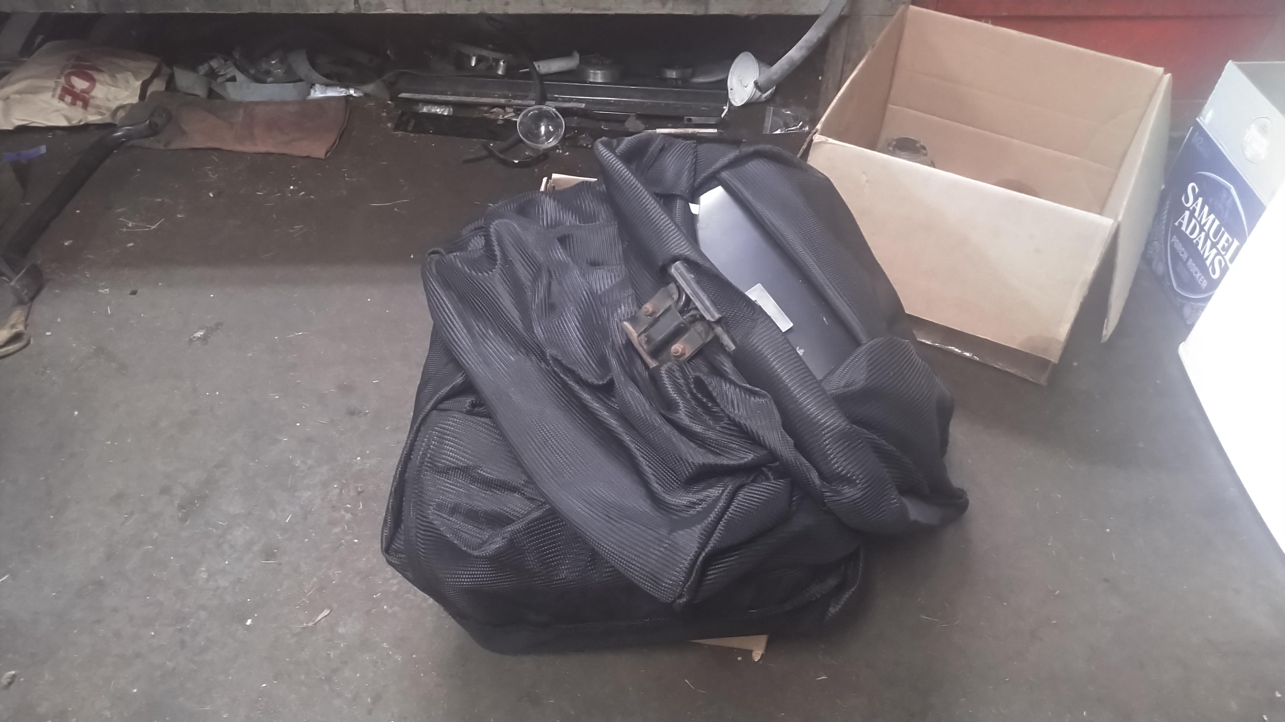

Welder buddy came over and we got the patches welded in and the front baffle reinforced. Blew some red Rustoleum on it to stop rust. Tomorrow I'll flip it over, power wash the top and prime/paint the patches to stop rust. New bagger bags installed on the frames as well. Not very pretty but functional and will last the rest of the mowing season.
