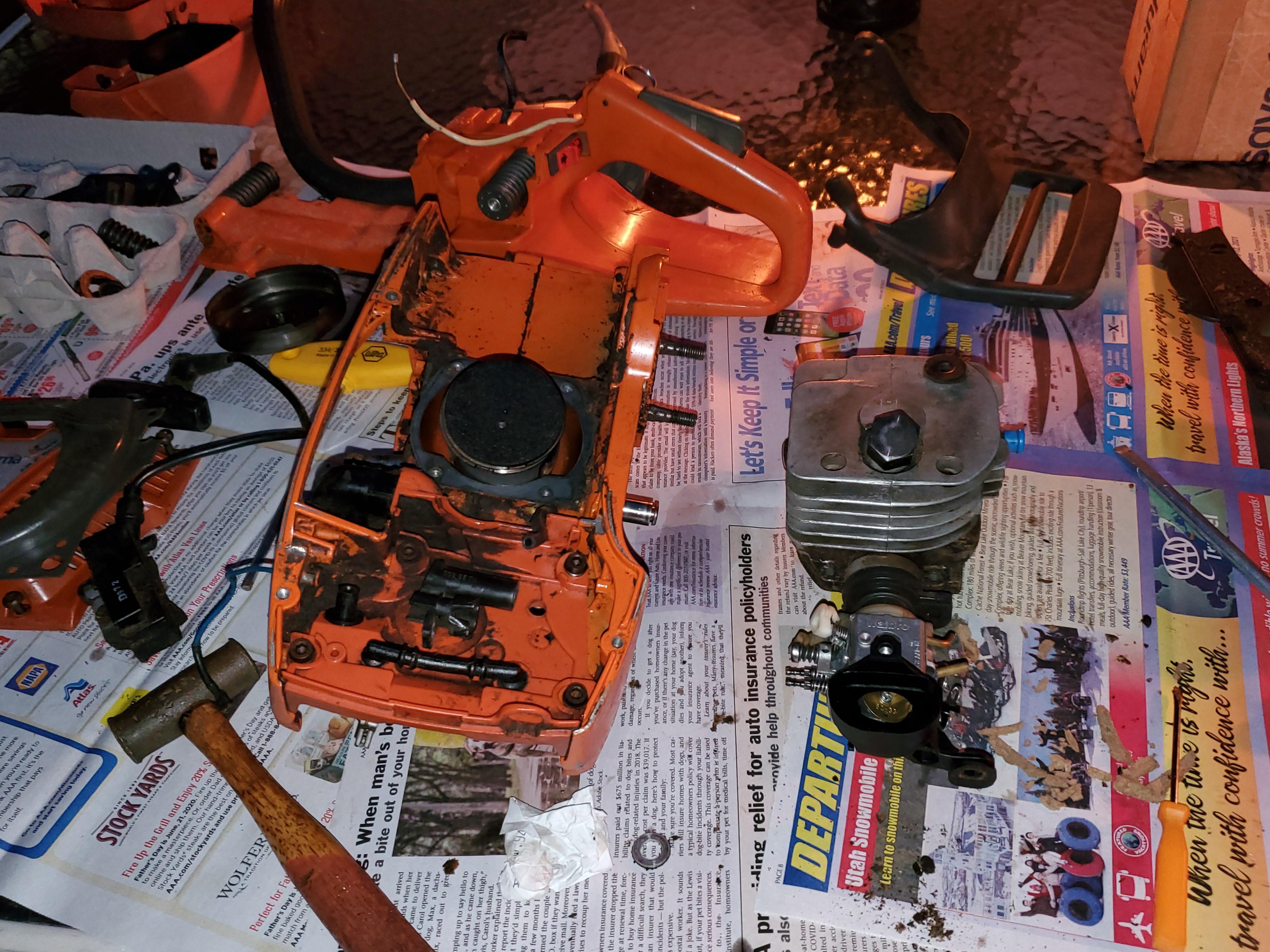

Guys 2171 on my bench he said "it's just not running like it used to, a friend of mine asked how the air filter looked I didn't even know it had and air filter!" :facepalm:
Any way 1/4 of saw dust caked on everything, stripped threads, missing screws, seals leaking, clutch broken ect. Needs a good once over, amazingly the piston looks great!

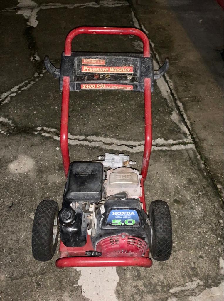

Servicing this Honda powered pressure washer I got from the curb. Strong compression, clean air filter, pump is great and works strong. Pull cord is looking a little frayed so I'm gonna replace it, new sp, and change the oil and voila.

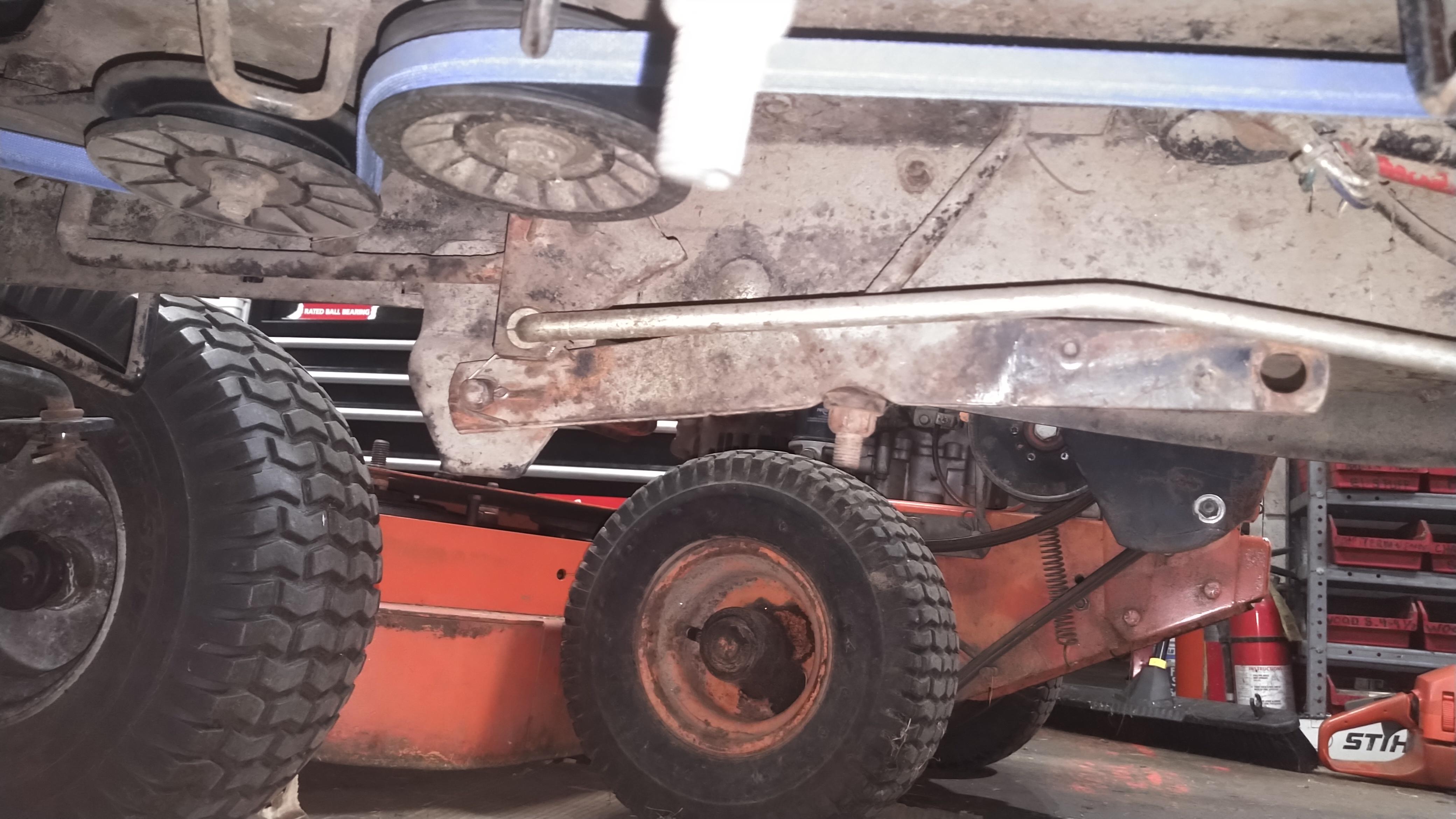

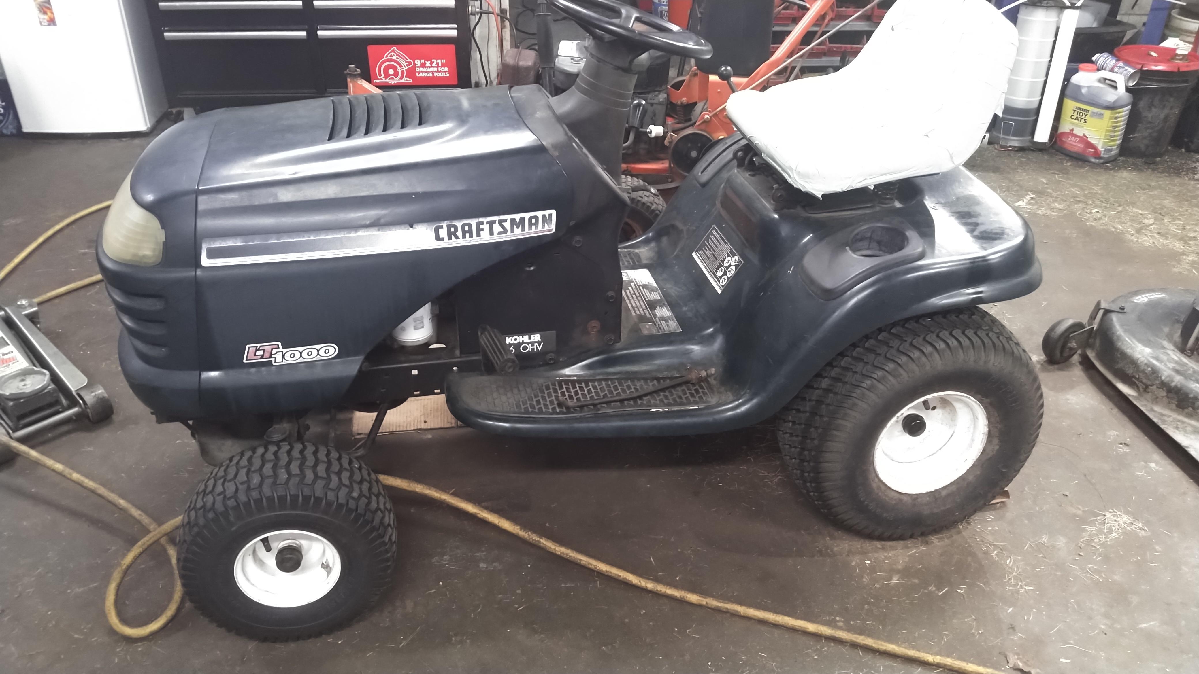

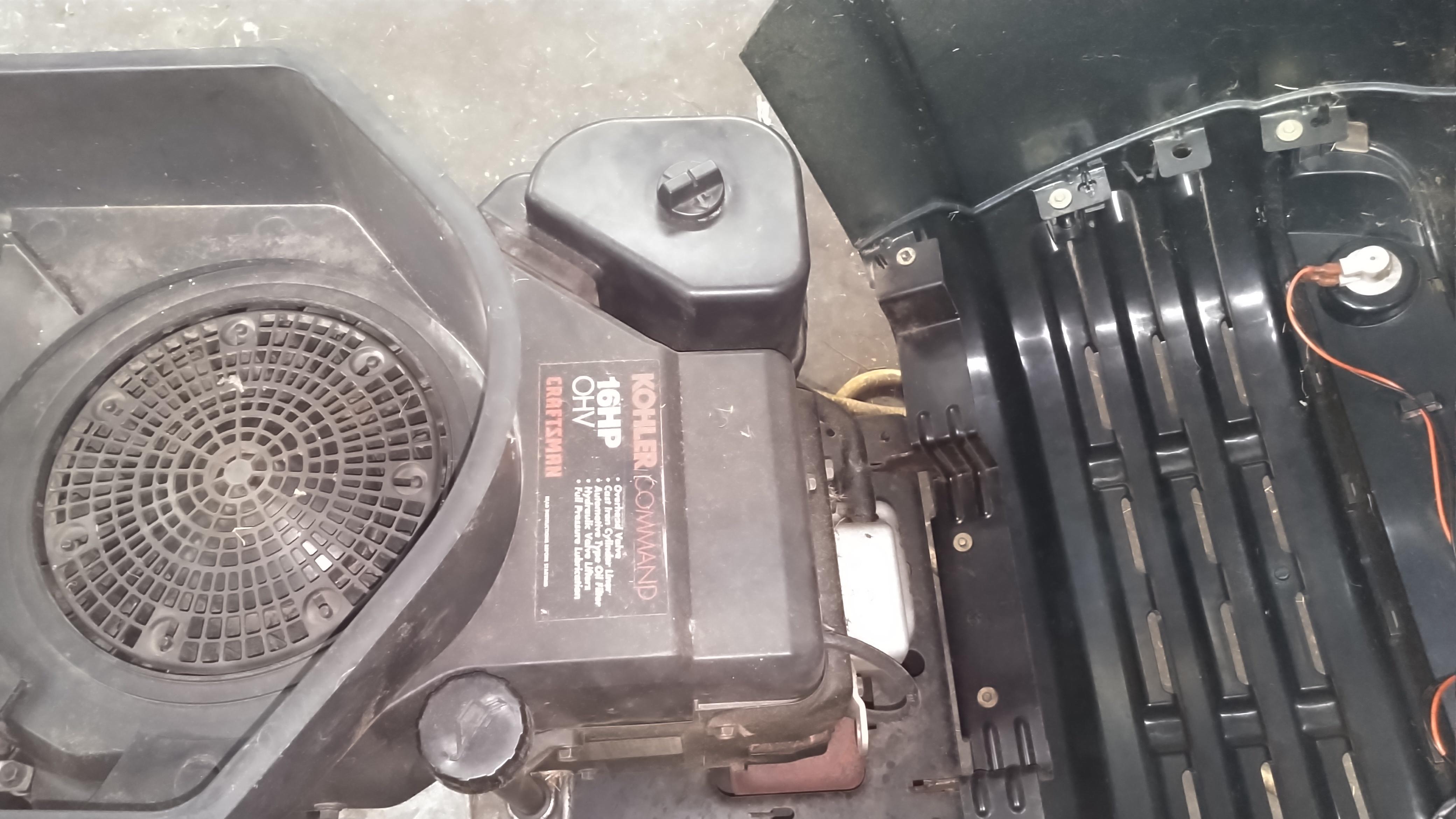

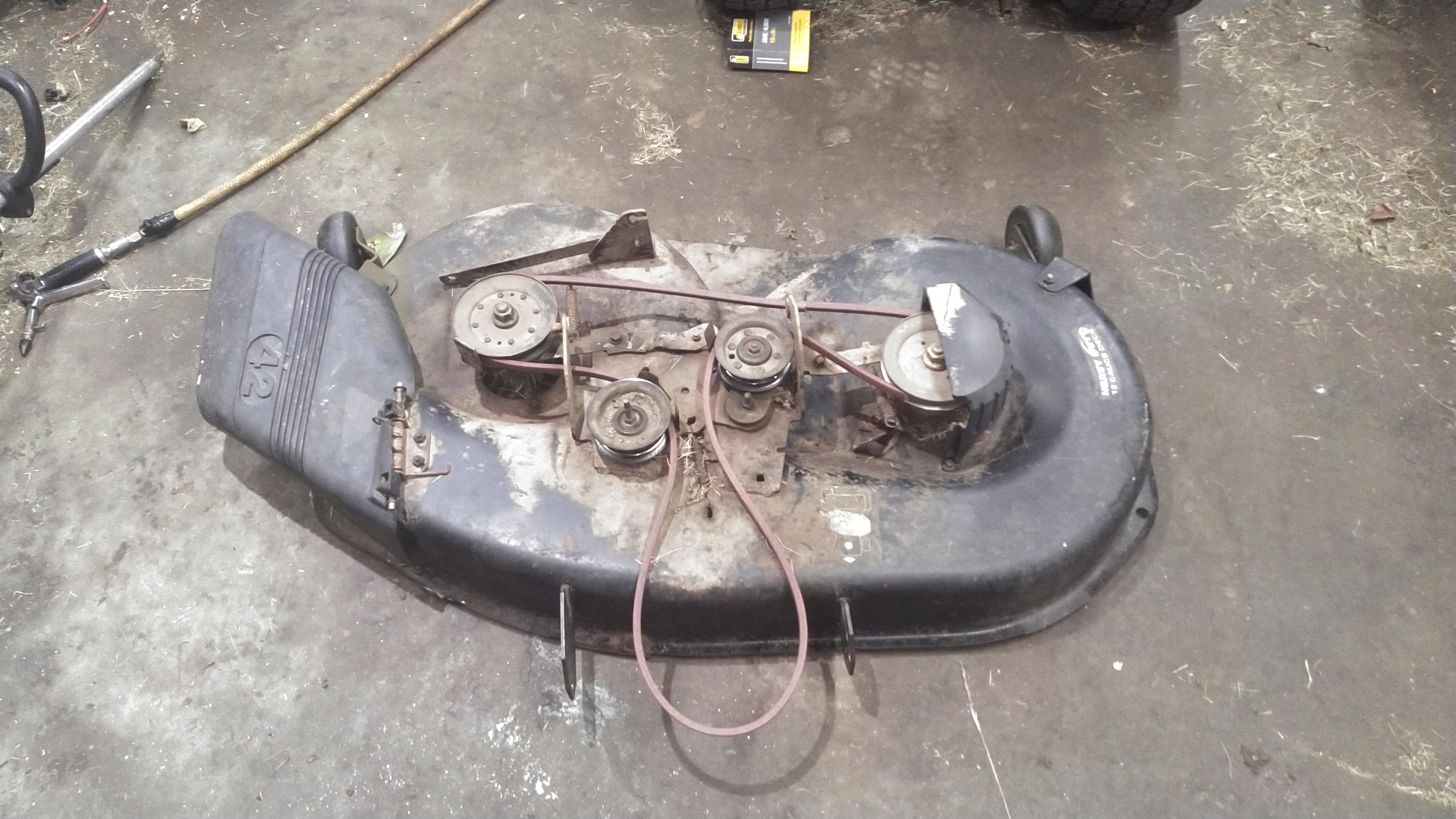

Craftsman LT1000 that was dropped off yesterday. Got new belts, mower deck leveled and put the right side lift arm back on the pin that was missing the clip....kinda surprised that they didn't think to take a quick look under the machine when the right side of the deck wouldn't stay up. Just need to reinstall deck and test mow tomorrow.
