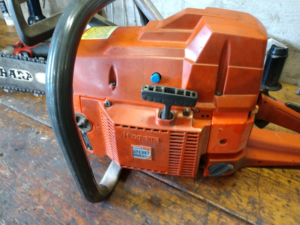

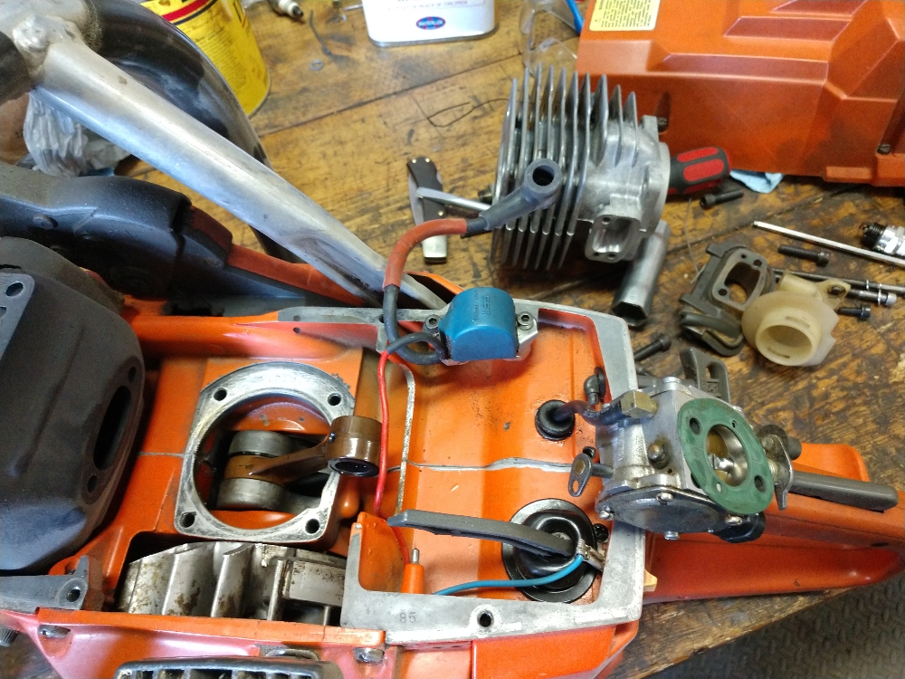

Ended up lifting the jug a little bit. Boot replacement was a success. Runs nicely now need to wood test.

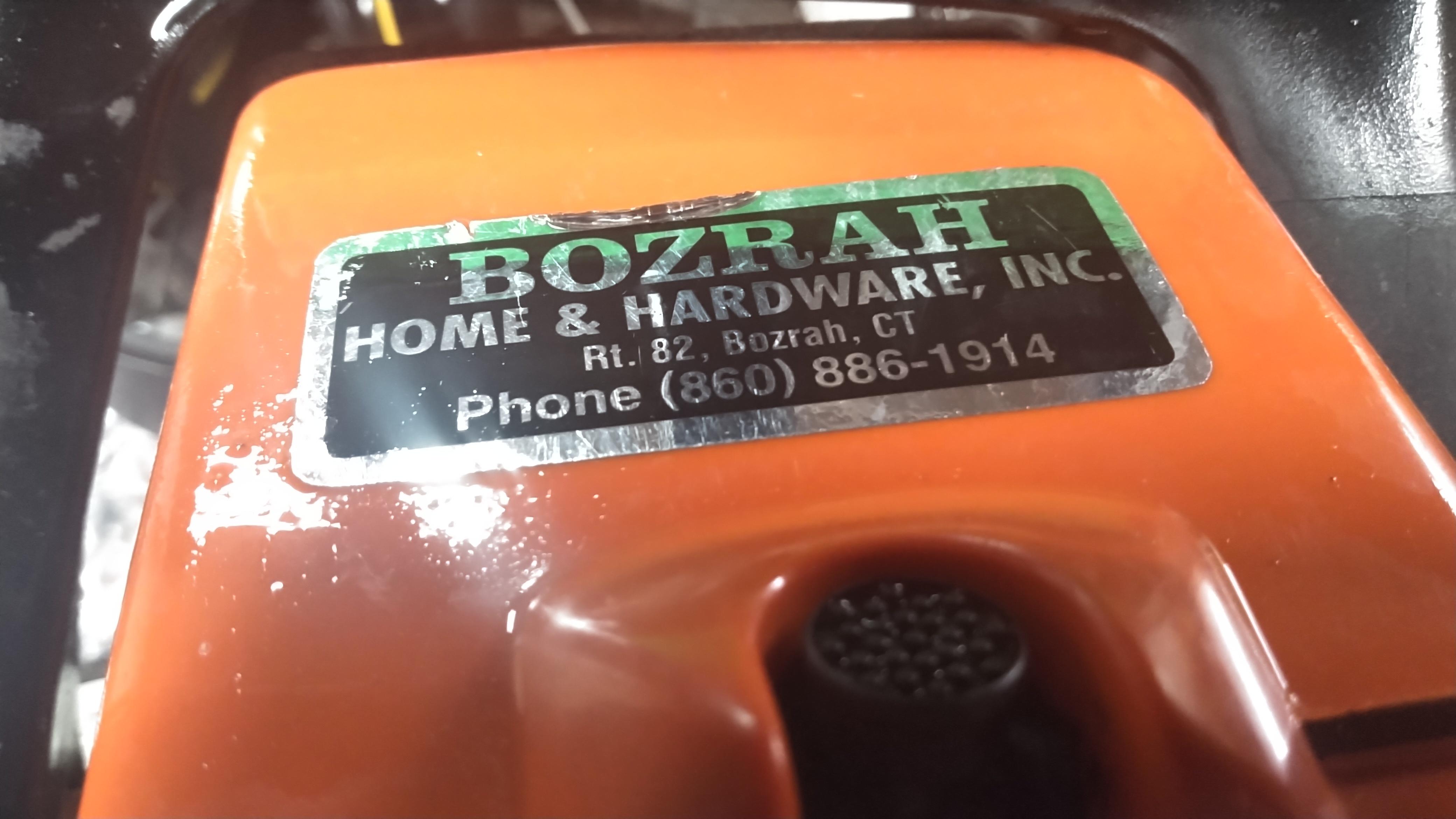

@rattler finally got around to this tonight. Better late than never.. waiting on the sealant to cure.[emoji51]
You have no idea how much it pained me to drill this top cover.
Turned out okay..
Hey DJ let me know how you like it and yes sir i do i hate doing that you did a great job

Will do buddy and thanks. [emoji106] I had a busted up cover that's drilled to compare and measure. 1/2" spade bit made a nice clean hole.

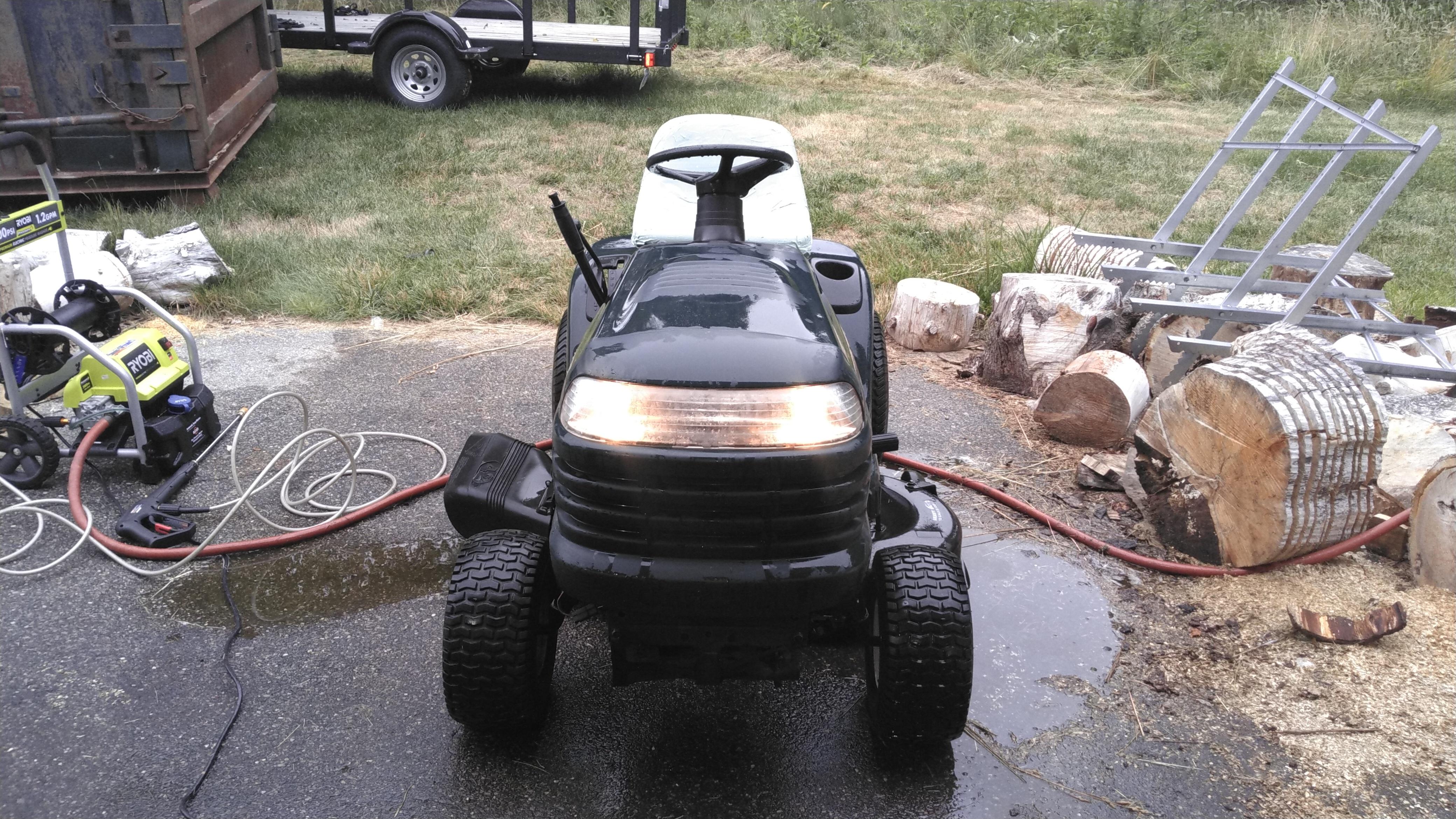

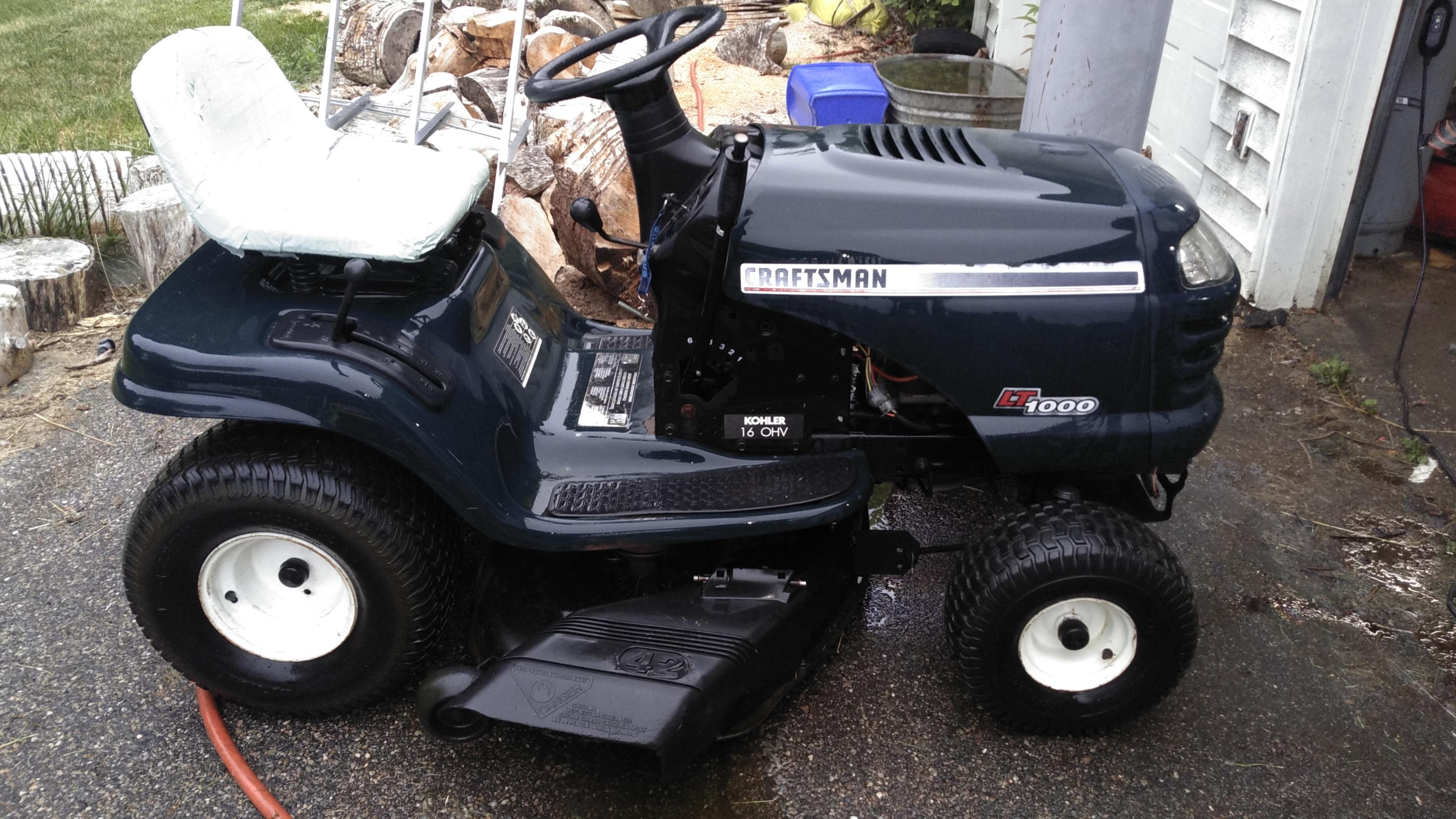

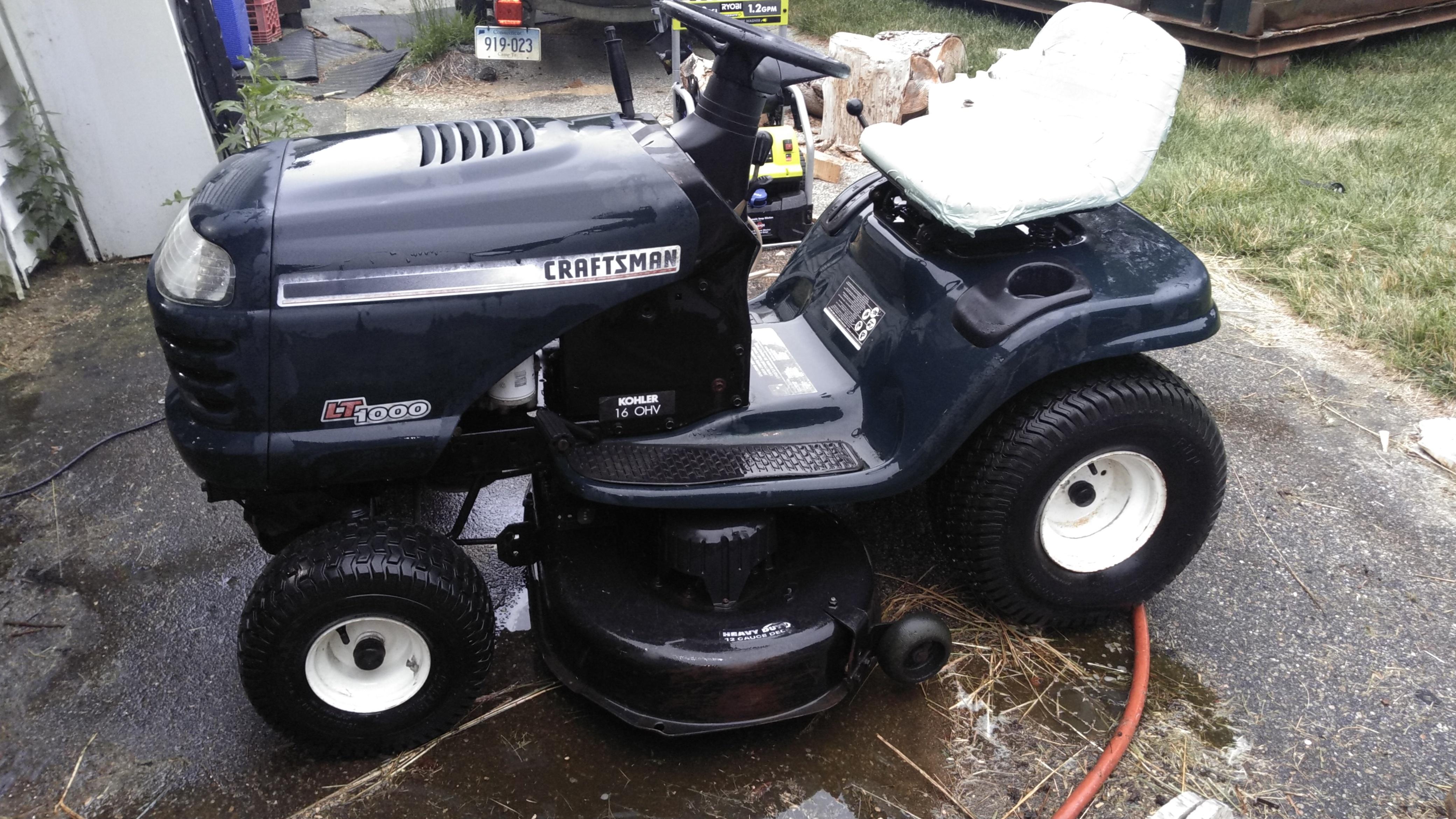

LT1000 got a courtesy pressure wash and greasing.

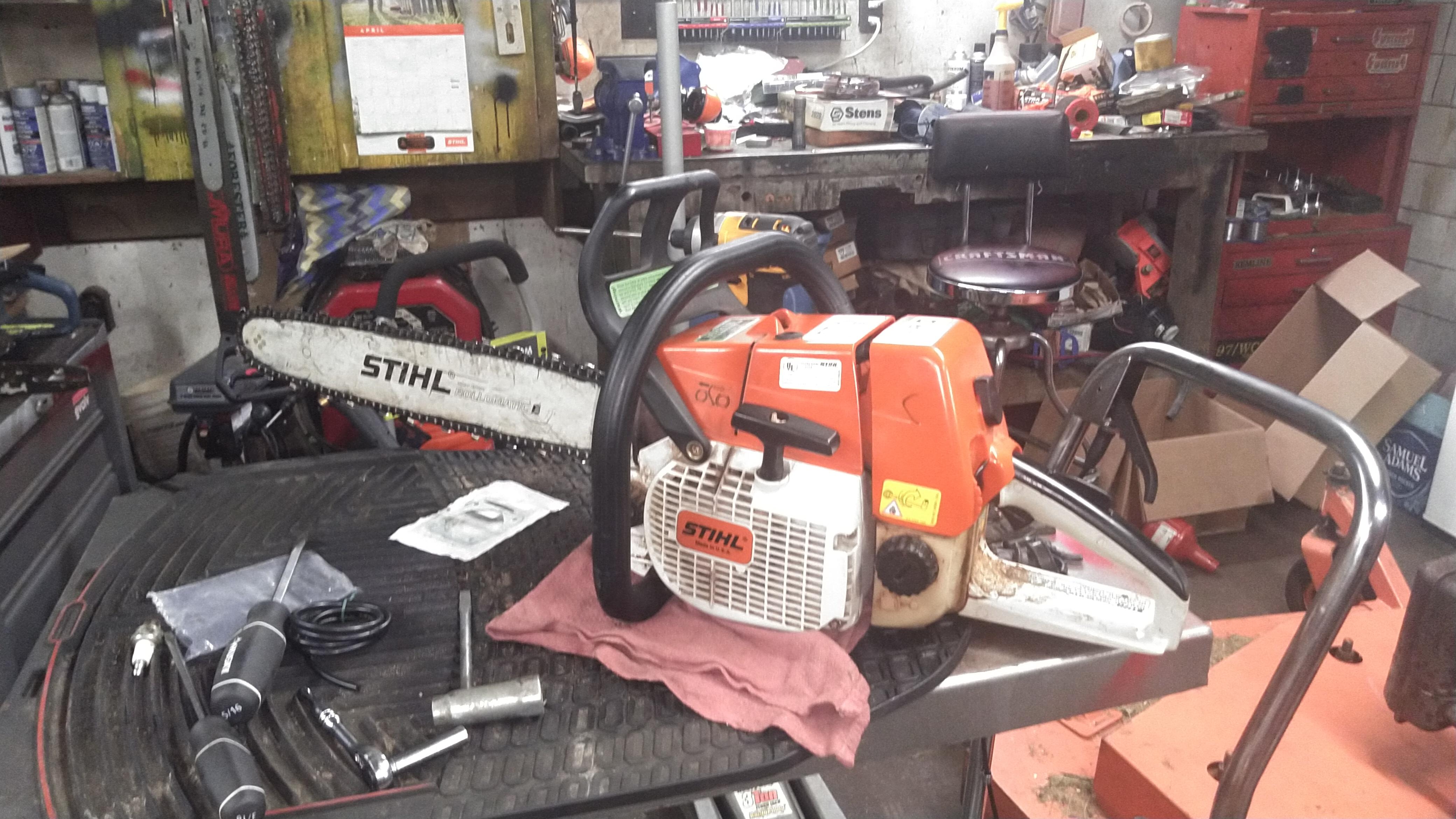

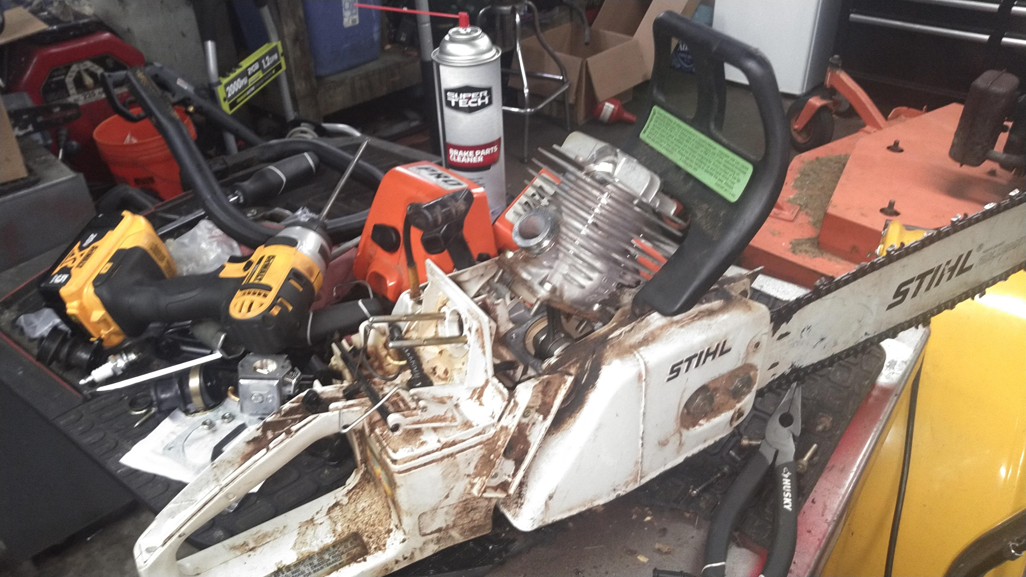

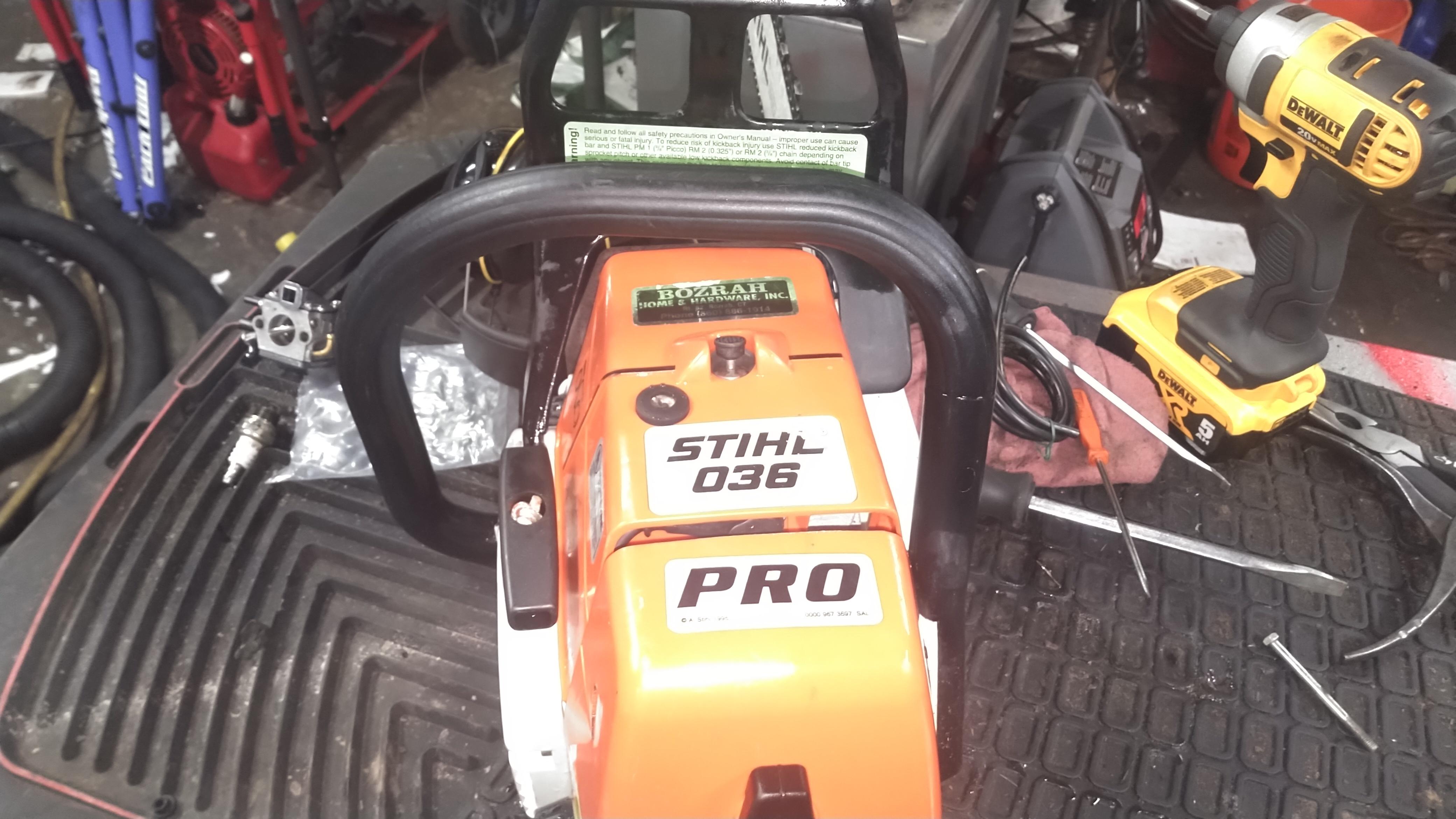

036 Pro got a wood test and final carb tweaking and pressure wash

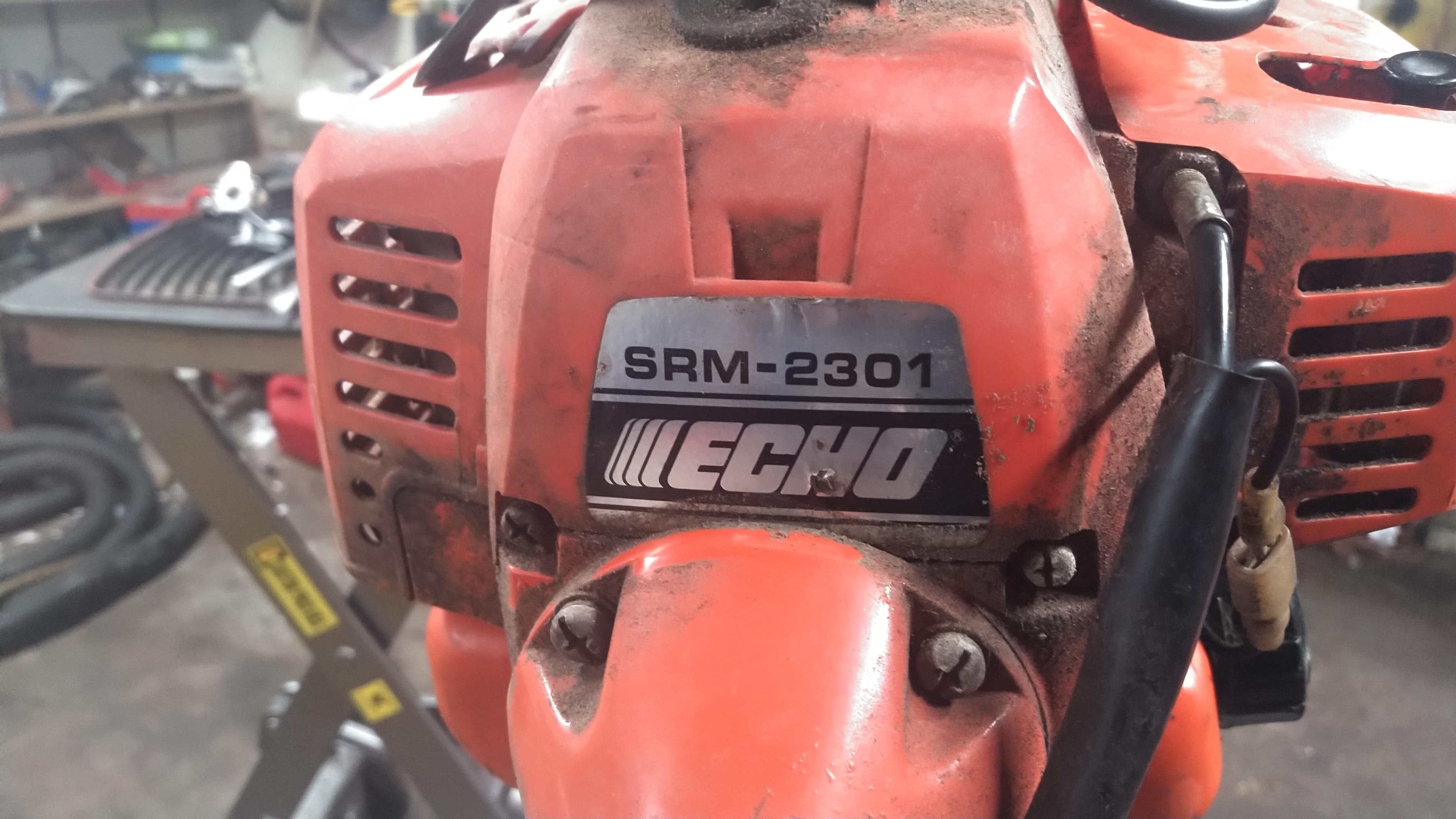

SRM-2301 got a carb kit, fuel line, filter, vent hose and spark plug. Need to test run tomorrow.

I did an xtorq boot, multiple times, was difficult but not nearly as bad as the original edition.
Yup the oe's are much more snug, one I fought with had an AM big bore not that that made any real difference other than I had to do it on more than one occasion due to the tree service that owned it melted it down a few times....

I don't know why anyone would go through the frustration of changing a Husqvarna intake boot without pulling the cylinder when it's such a simple job. Can have them tore down to the crankcase in 15 minutes.
Agreed. That's the beauty of the Husky design over Stihl in my opinion - Remove the muffler brace, air horn supports, and 4 jug bolts, and the whole assembly just lifts off in one piece for many different models.
