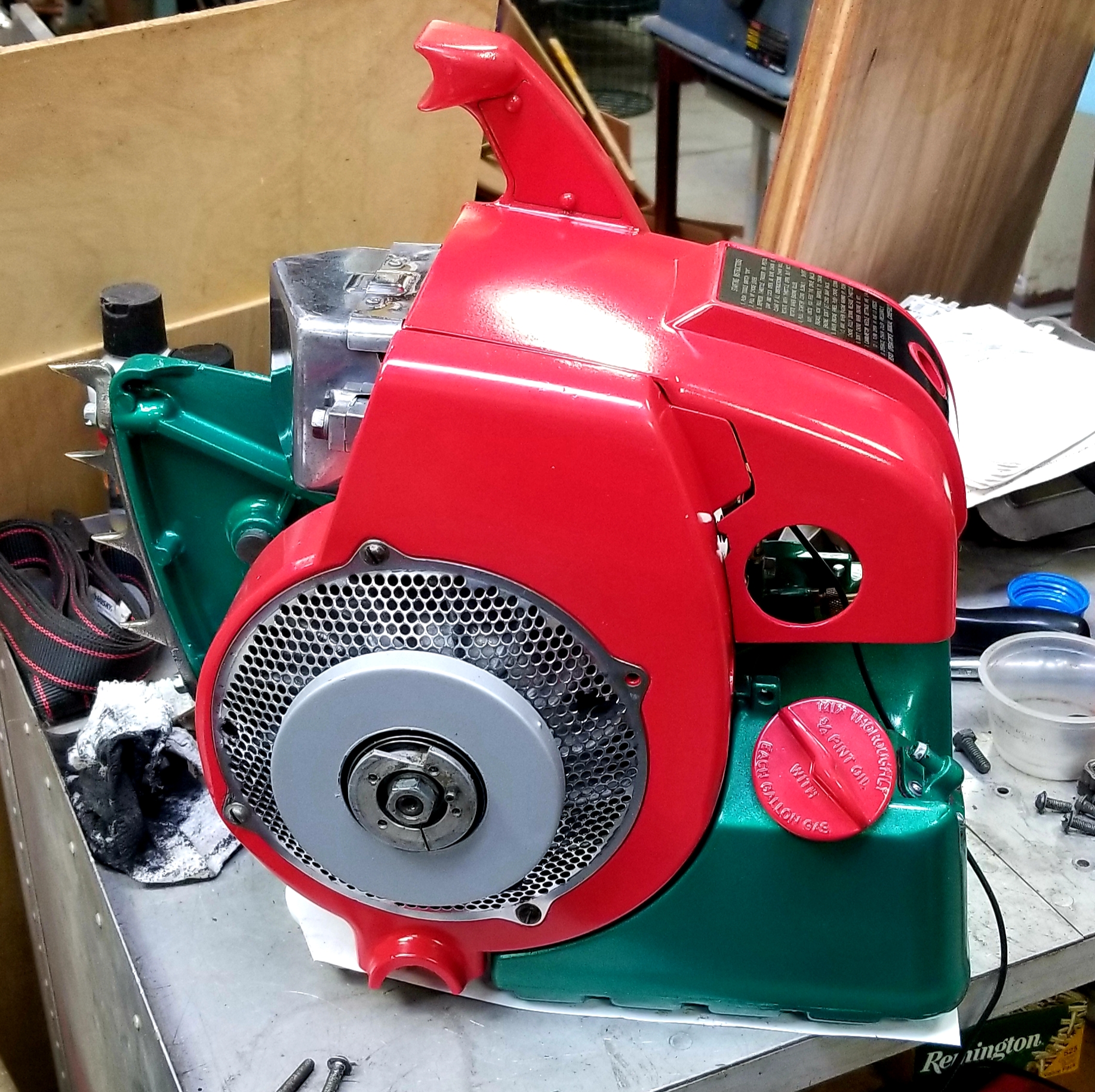

Homelite 990D.

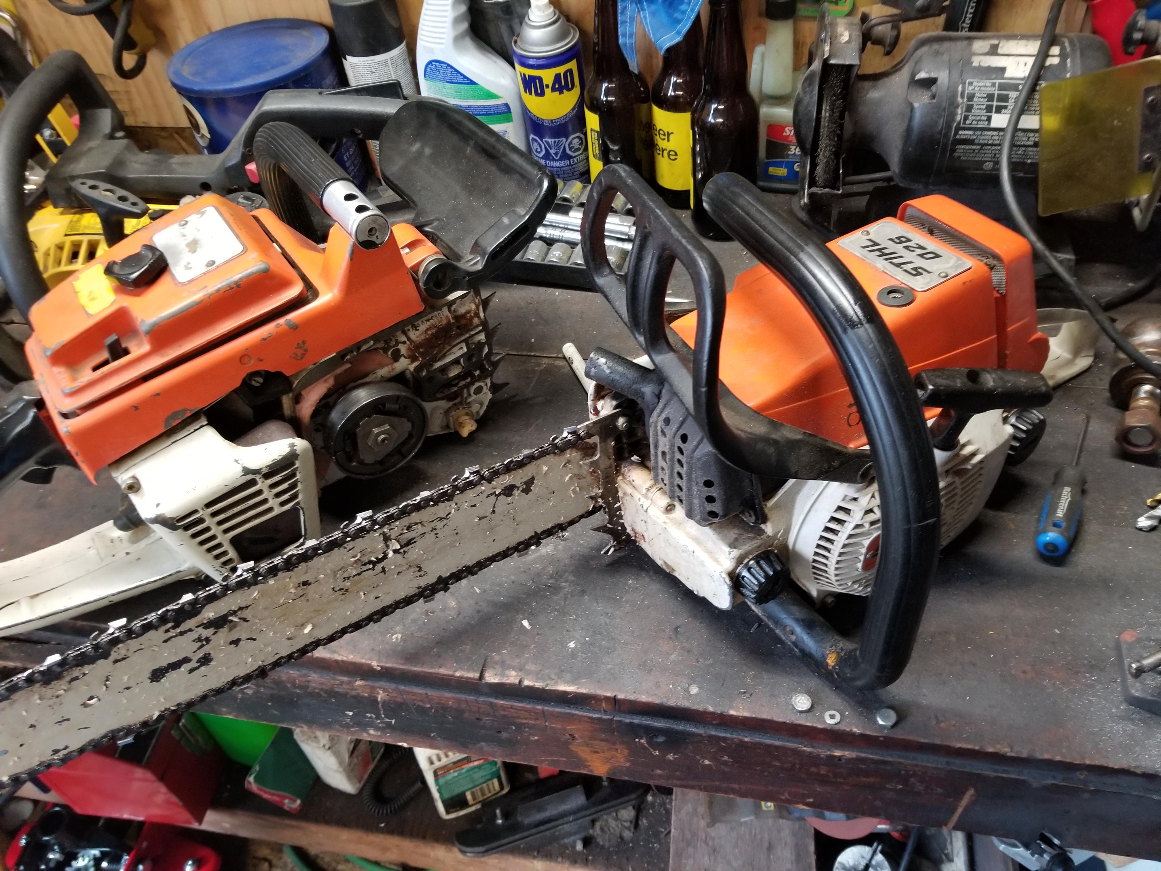

My 041 on the bench for new chain tentioner. Also neighbor of my BIL's 026 not running propper. BIL put all new seals and intake boot, fuel line impulse line and still wouldnt hold a toon propper. I brought home to have a boo at it and i think its maybe to fuel vent. I couldn't suck air through it so i took the screw out of the vent and i could. So left it out for now and gonna try it out soon whennit dries up a bit.
I had it idling for about 10 mins and gave it a bunch of throttle blips and seems good so hope thays all it is.

So i took that 026 to the bush and ran ok but it seems to go lean on its own. Can set it to four stroke WOT. Then recheck few mins later and seems lean again. Reset and same thing over and over. I pressure vac tested the case and all was good ther. Could this possibly be a carb issue? It did just have a gasket kit put in it about a month ago or so by my BIL. I pulled apart and looks good. I do have a china carb i can putmon to see if any better but looking for your thoughts on what it could be.

Could the screws be walking while running?
They didnt seem to be that i noticed. They did seem to have some resistance to turn them. I put the china carb on it to try. Only had one block of wood to test it on here. Once i git it tuned it seemed ok but only made about 8 cuts or so. Will have to get out to bush and run a tank through it to see.
