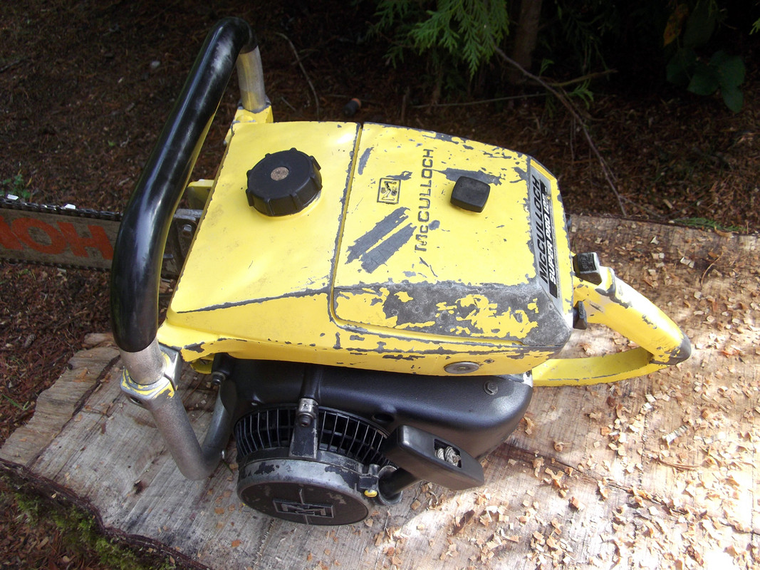

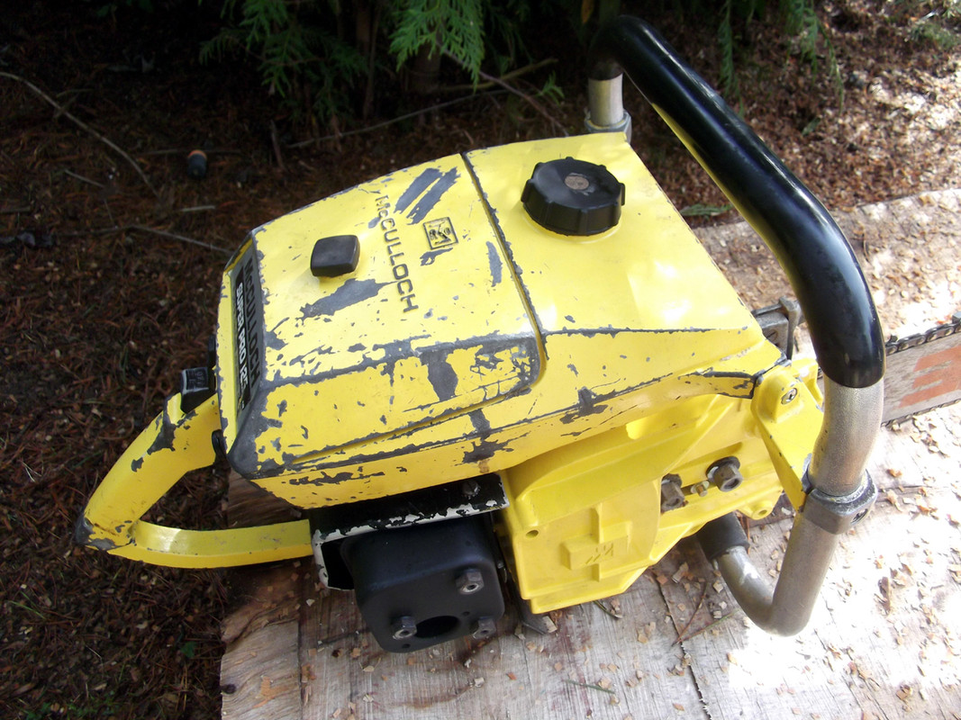

It's another SP-125, this one is bored .030" over (Saw-King bored the jug before he sold his Sunnen hone) and has a NOS 101AA .030" over "quick-time" piston.
It runs pretty good so far but I'll probably chop up a tank for it and install a V-4 Sloper intake manifold with the Horstmann "V-Max" reed cage and a Tillotson
HL-334 carb.
HL-334 carb.
Sounds like a good plan! You going to go over the swap?
