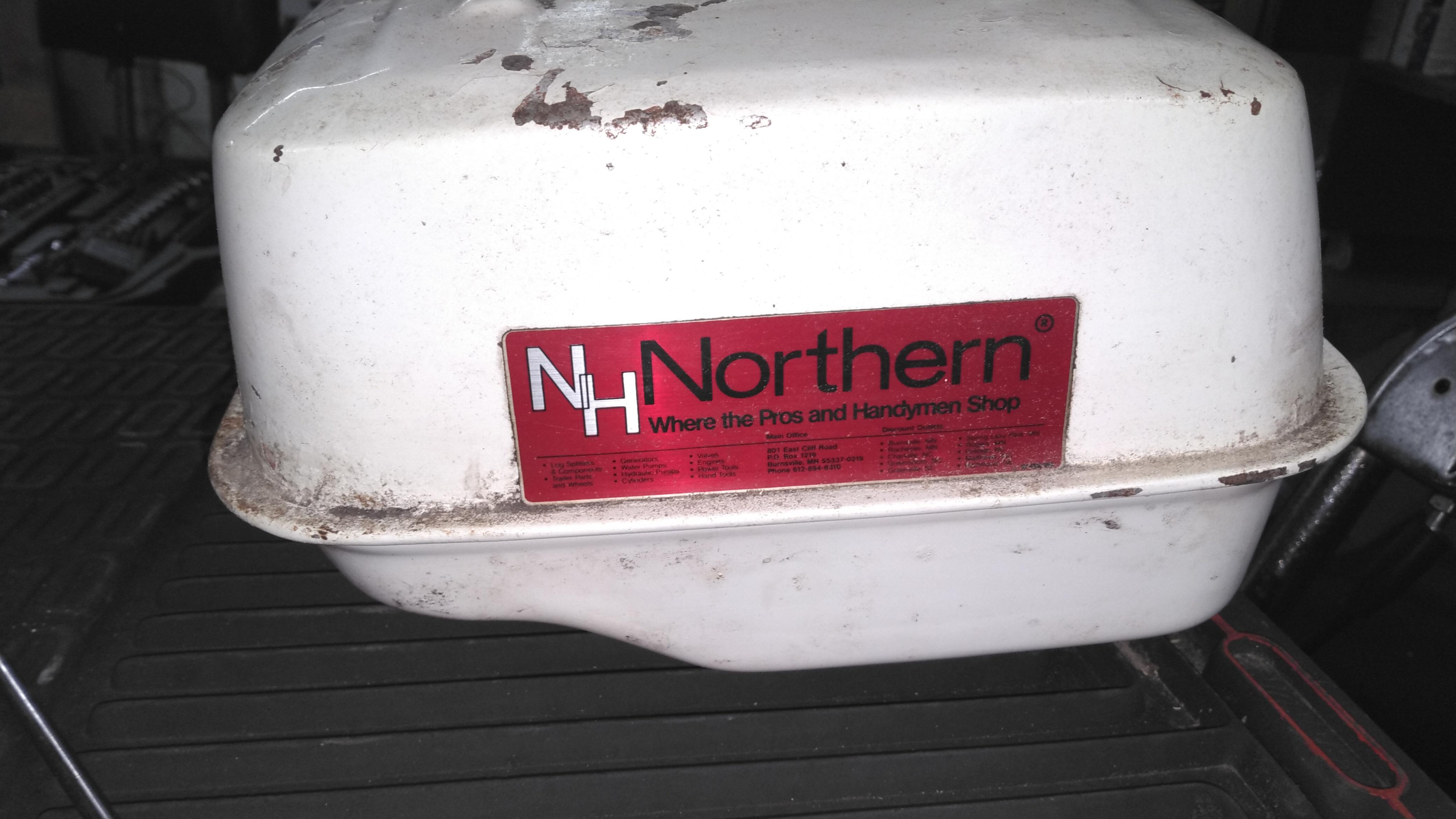

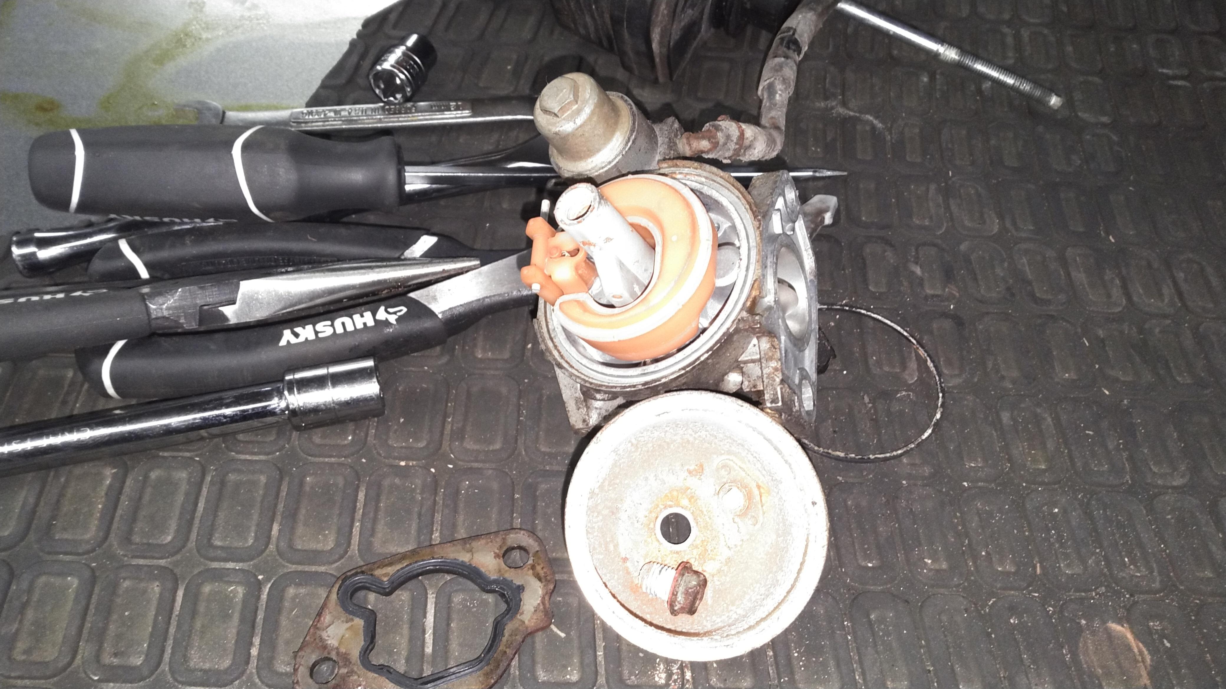

My dad's buddy's old Northern Hydraulic / Northern Tool pressure washer. GX340 11.0 HP Honda. Been sitting for a while and he wants it running and serviced. Fired on a prime shot. Looked in the tank and it was dry but had a bunch of rust particles floating around so a good blast of compressed air had it clean. Carb was not saveable, new carb on the way. If I get a carb with this much corrosion/rust I just replace it, saves me and the customer a lot of frustration. Other than a fuel system overhaul it'll be getting a new air filter, plug and fluids changed.

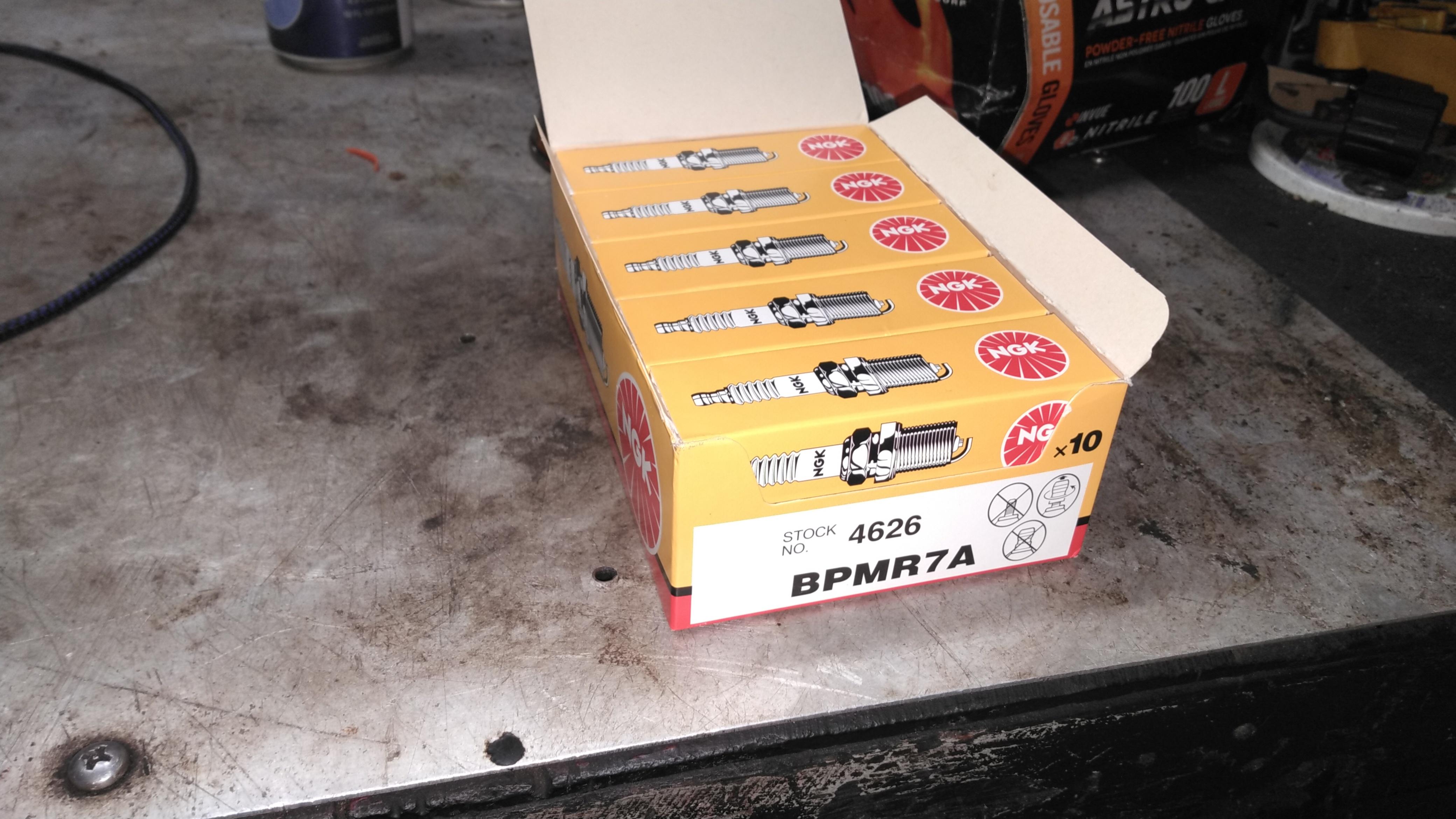

Also got my stock of BPMR7A, set for a while now.
