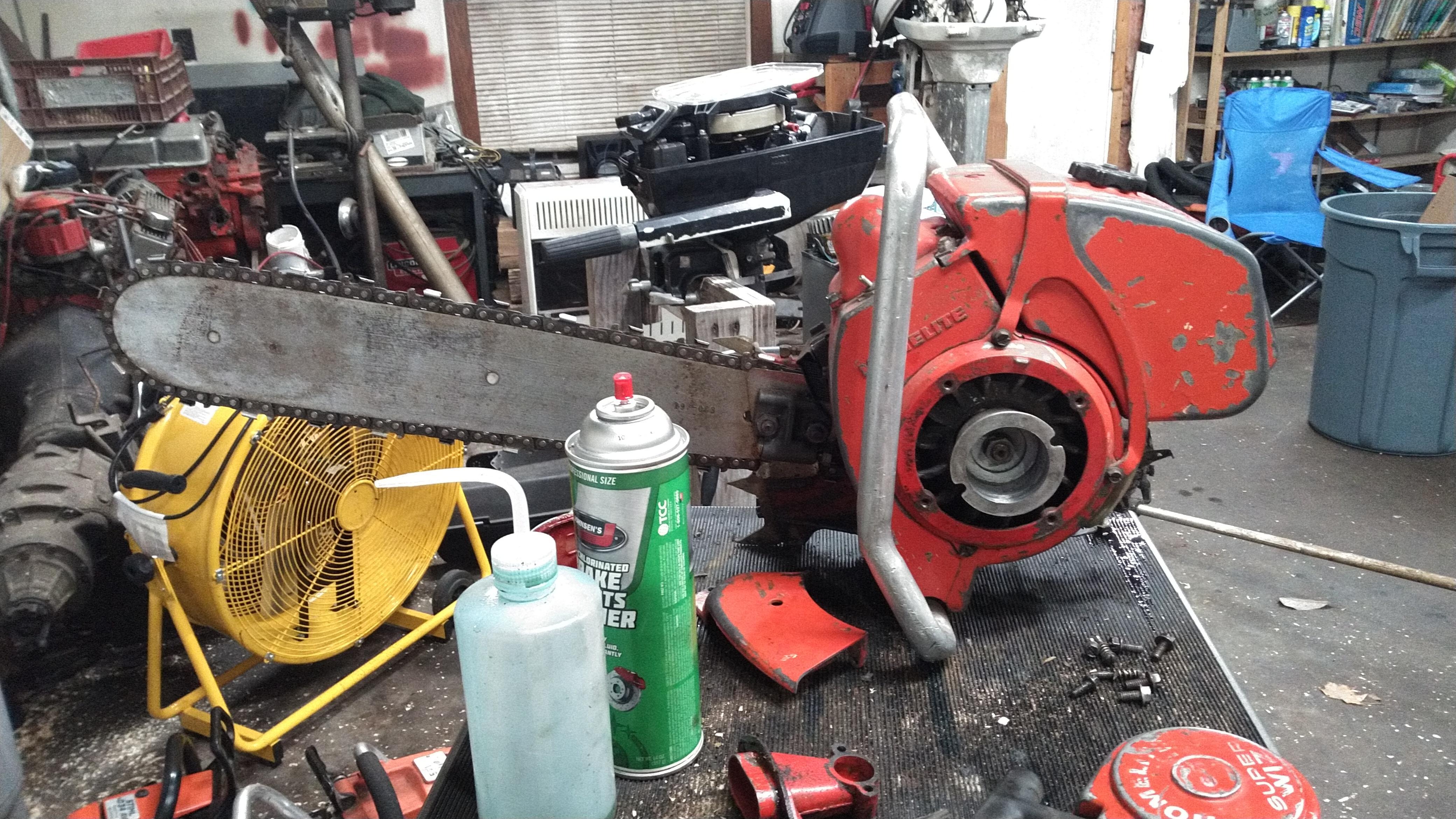

Buddy's 394 back on the bench. I got it to pass vac/pressure with new crank seals. Took it out and made about 2 cuts before it ran away again. PTO side seal is all chewed up against the crank. No visible rough spots or barbs on the crank. Bearing is tight with no play. What should I be looking for while I wait for new seals from HL supply?

The depth of that seal is key.
The right depth is just flush, right?
Just a thought... maybe it’s missing the washer that goes on before the worm gear
Amazingly, it does have the washer. The clutch was on so tight, I'm not sure it has ever been off.
I did the same thing recently. The seal needs to go slightly past flush and over the lip on the crank. It will make sense when you get the old seal out. If you don't have any seal tools the soda can trick works.
