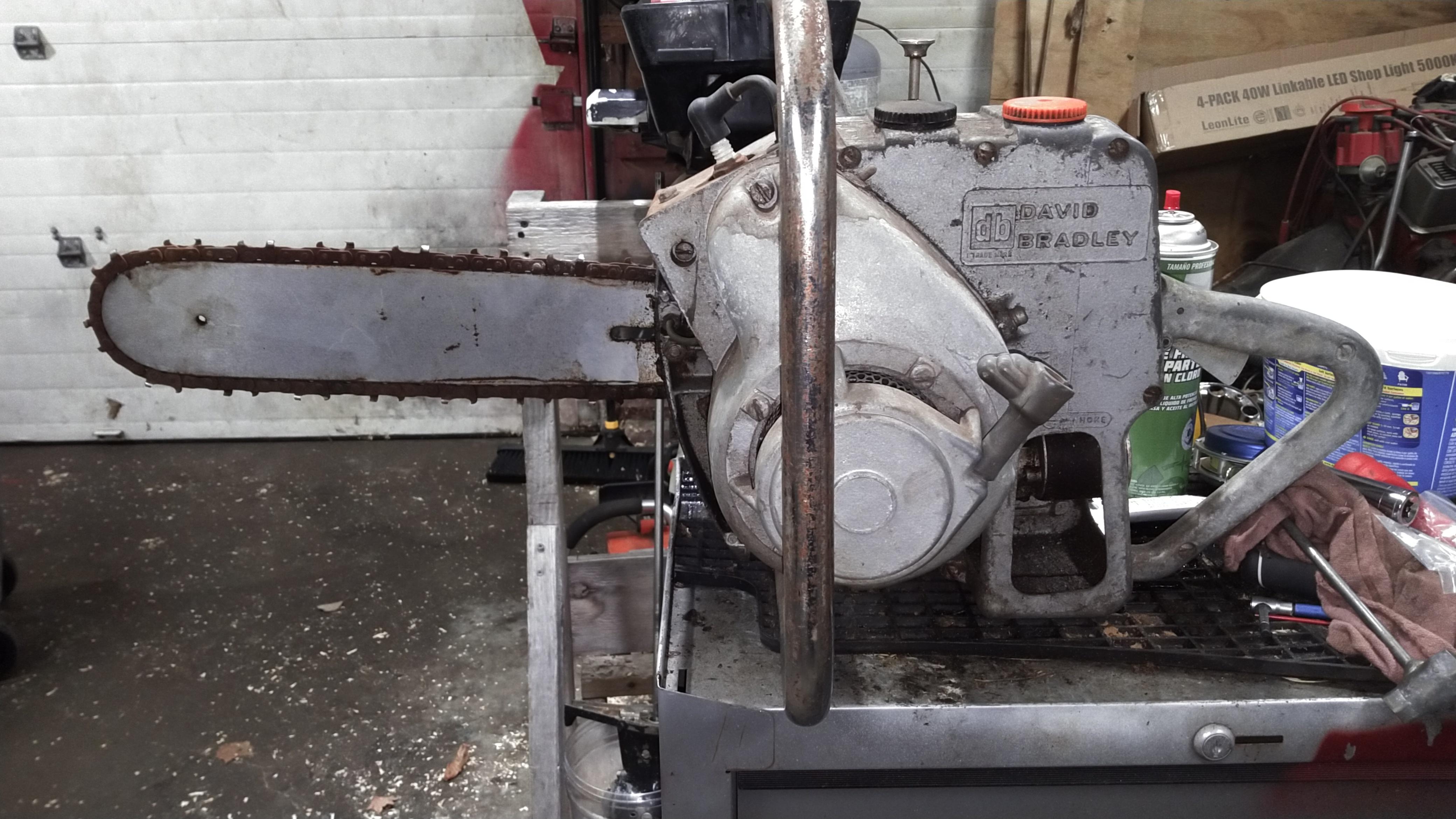

Got these 2 today.
1982 Homelite Super Wiz 66 gear drive. 77cc pulling a 20" bar with 1/2 pitch chain. Just needs a general going over.
1950s? David Bradley direct drive. 77cc with 1/2 pitch chain as well. Needs the same general going over.
