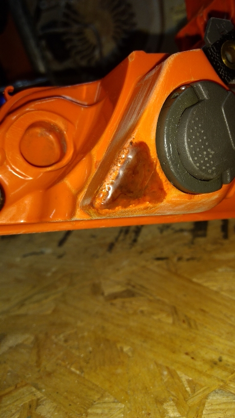

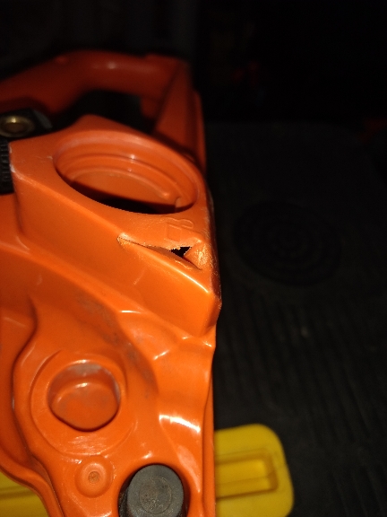

5-fiddy tank "used for traction"
Not pretty but used what I had on hand.

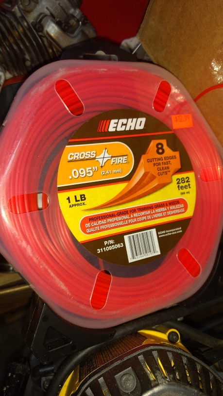

Nice fix mark.
Thanks, I used to have some orange zip ties that would keep their color and end up real close.

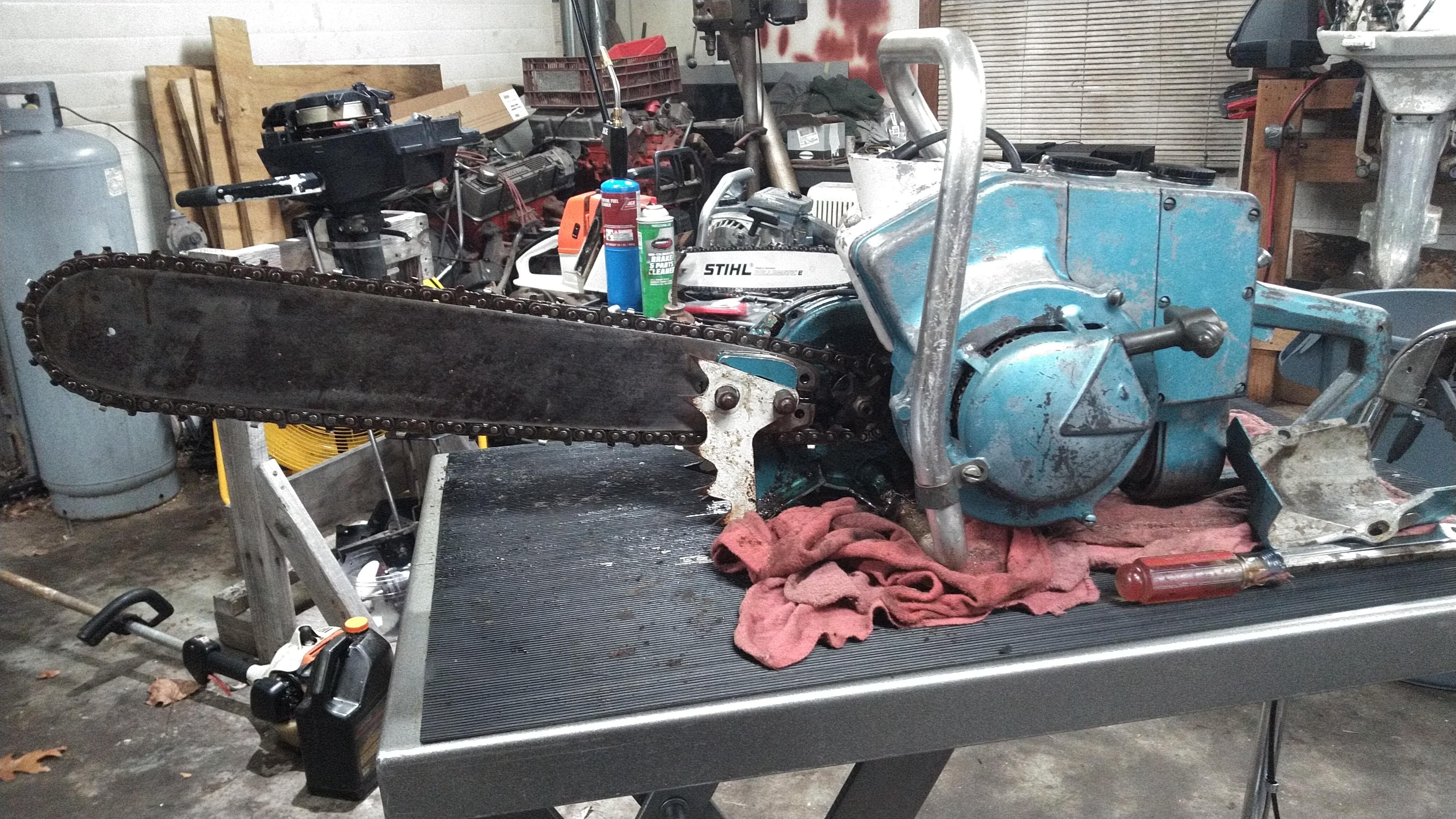

Sears 758G gear drive. Pulled the carb off last night and found a clog in the fuel inlet fitting, blew it out with compressed air and brake cleaner. Tonight after work I'll reassemble and reinstall the carb along with a new in tank fuel line and get her fired up again. Then I just need to sharpen it but need to get some 1/4" files for the 1/2" pitch chain first.

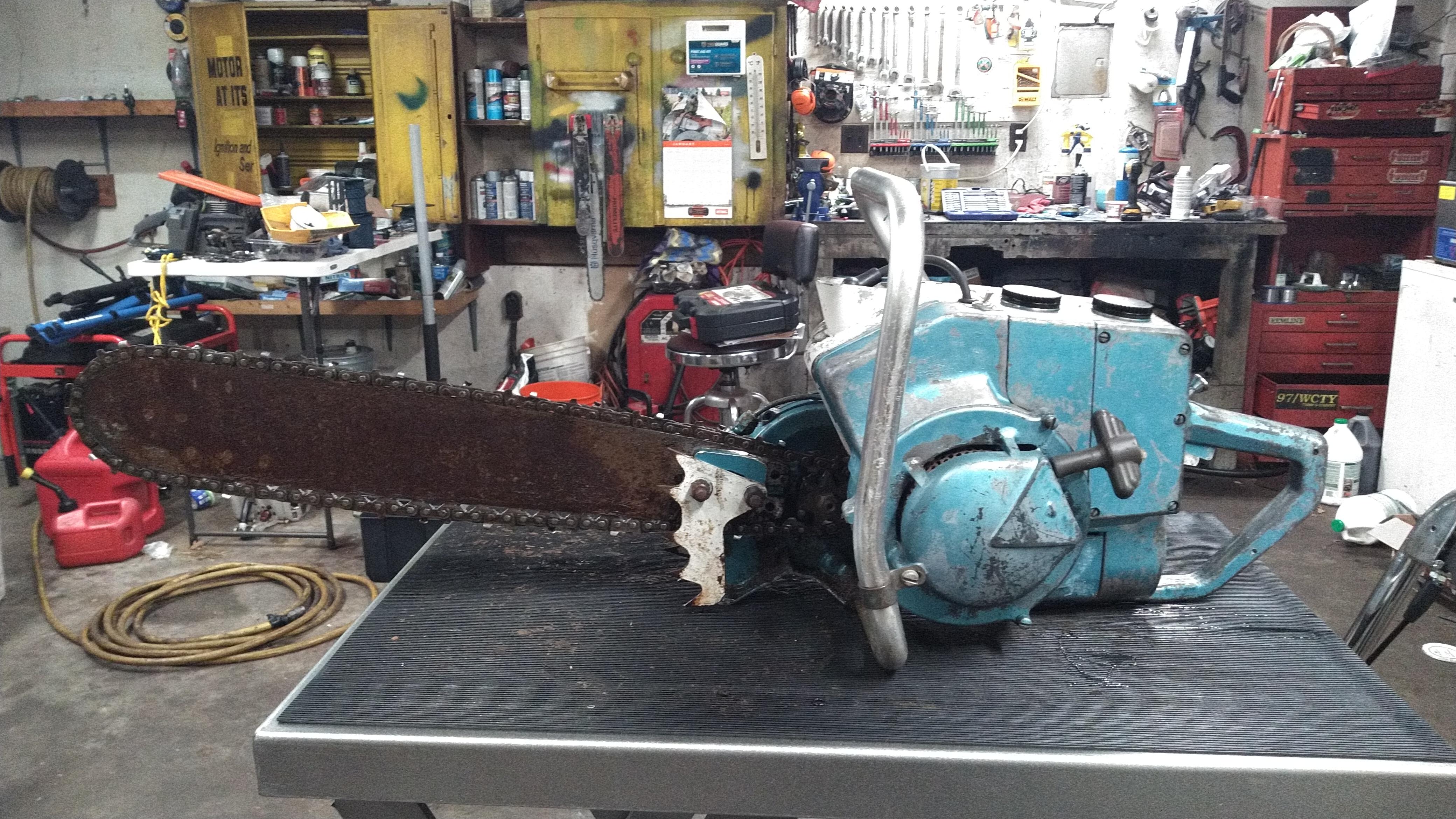

ITS ALIVE!! Fired right up after cleaning the carb again. A bit of tweaking had it running sweet. Ended up using my grinder and flap wheel to clean up the bar instead of bead blasting it. Files will be here tomorrow.
