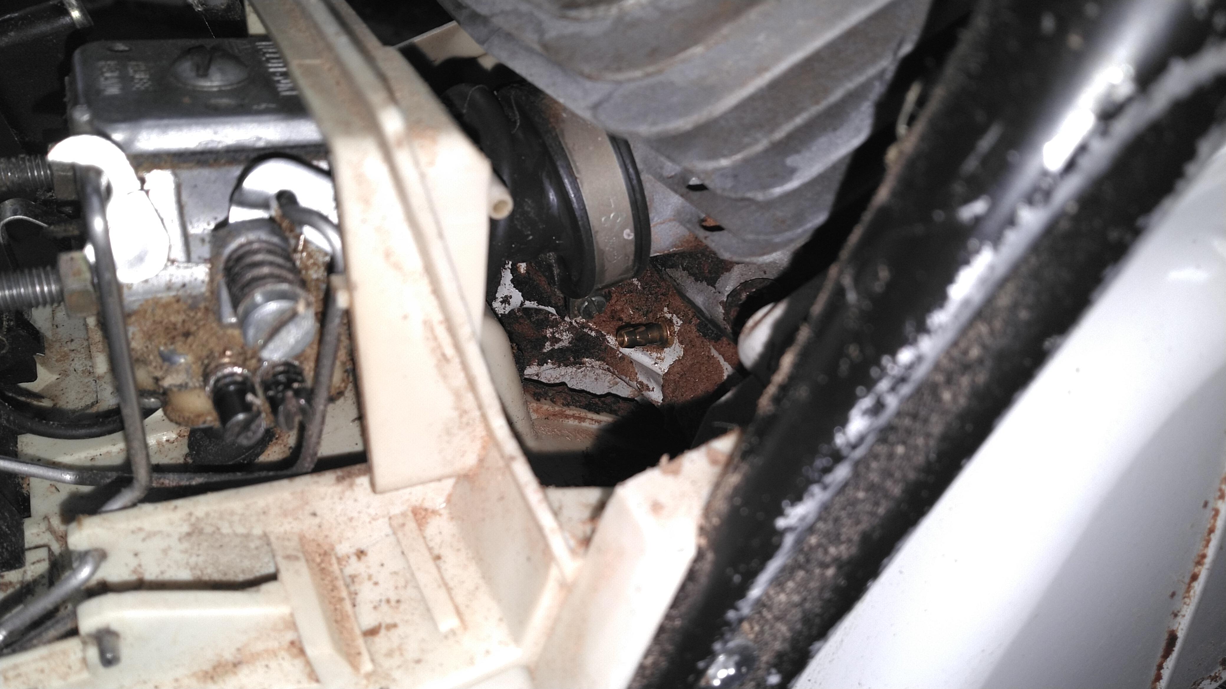

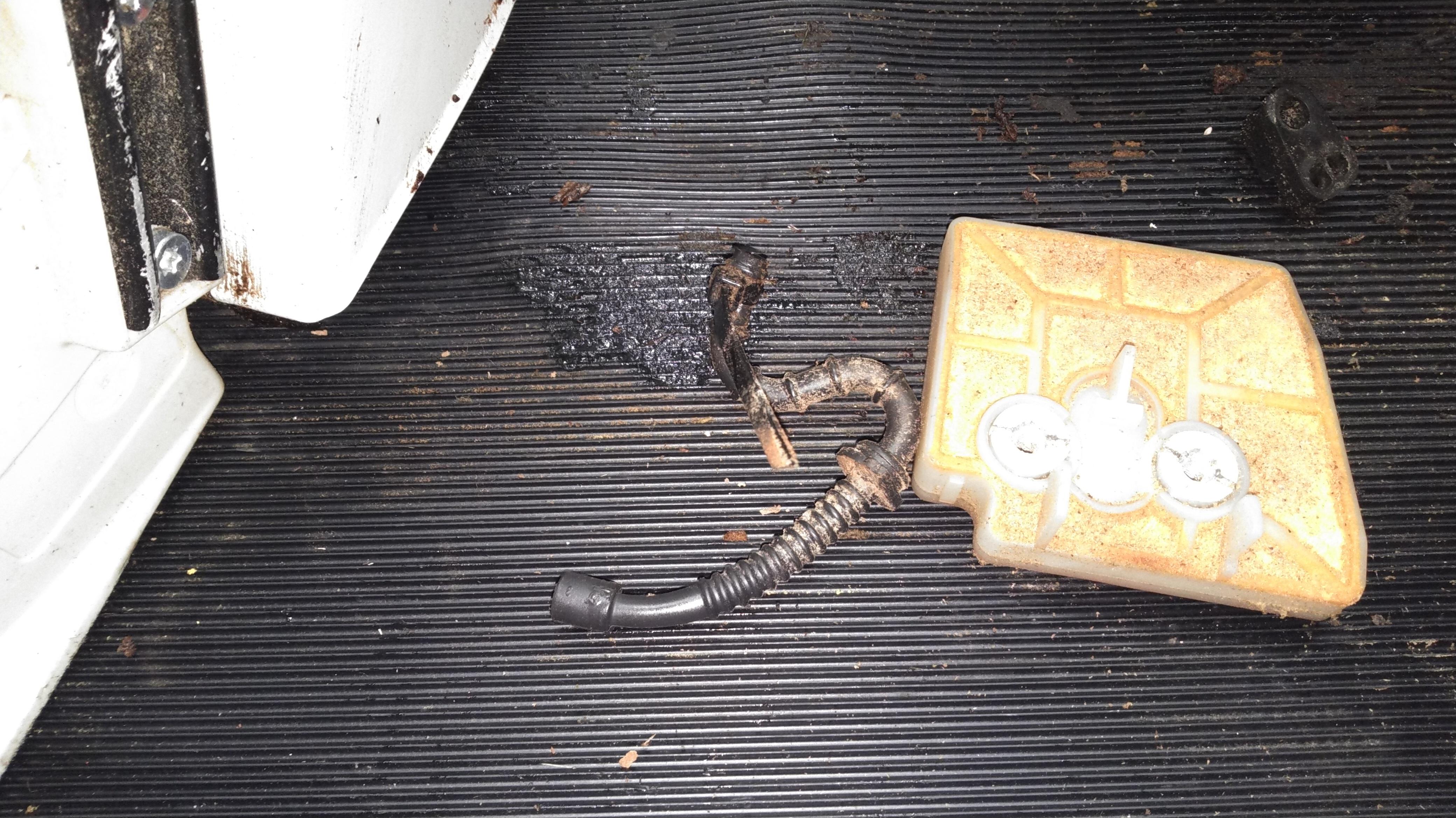

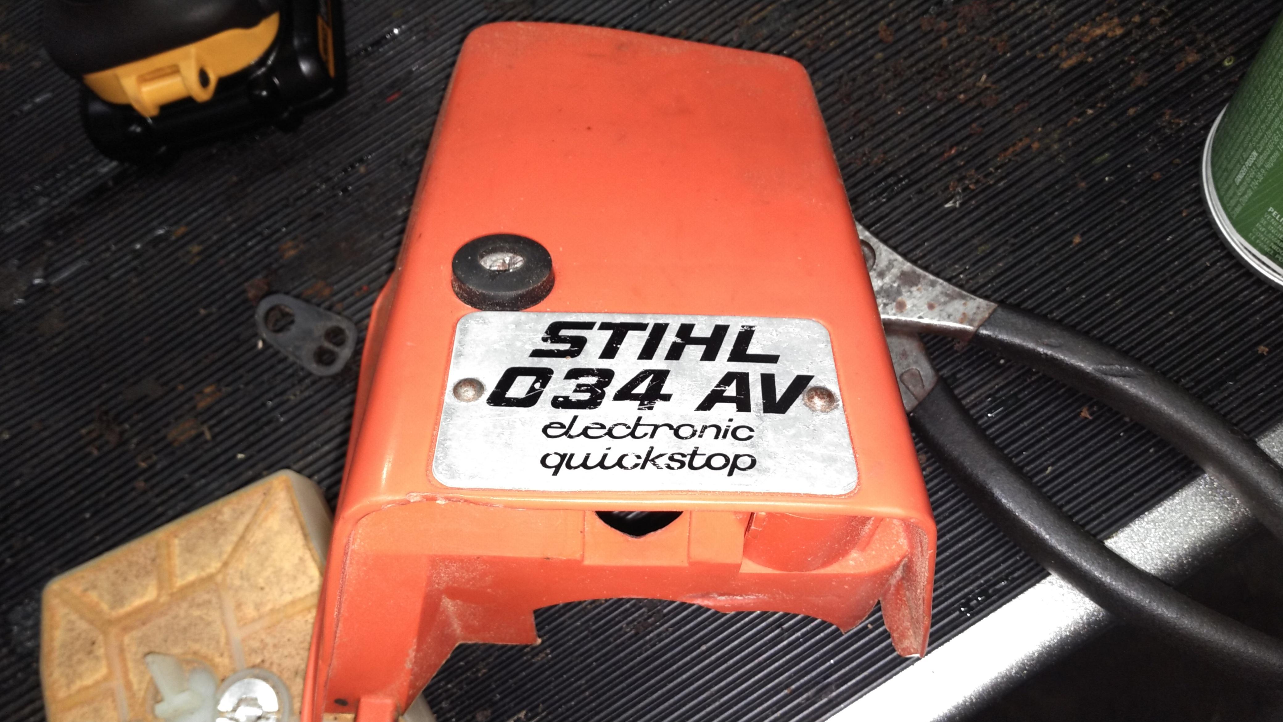

Did some cleaning, had a beer, and figured out the erratic running on my 034. Intake boot is leaking and some dopus installed a fuel line for the impulse hose which was loose on the crankcase nipple...gonna pull the jug and replace the base gasket as well.
Nice saw. I get all twitchy when I see them. The little saw that doesn’t know what it could be.

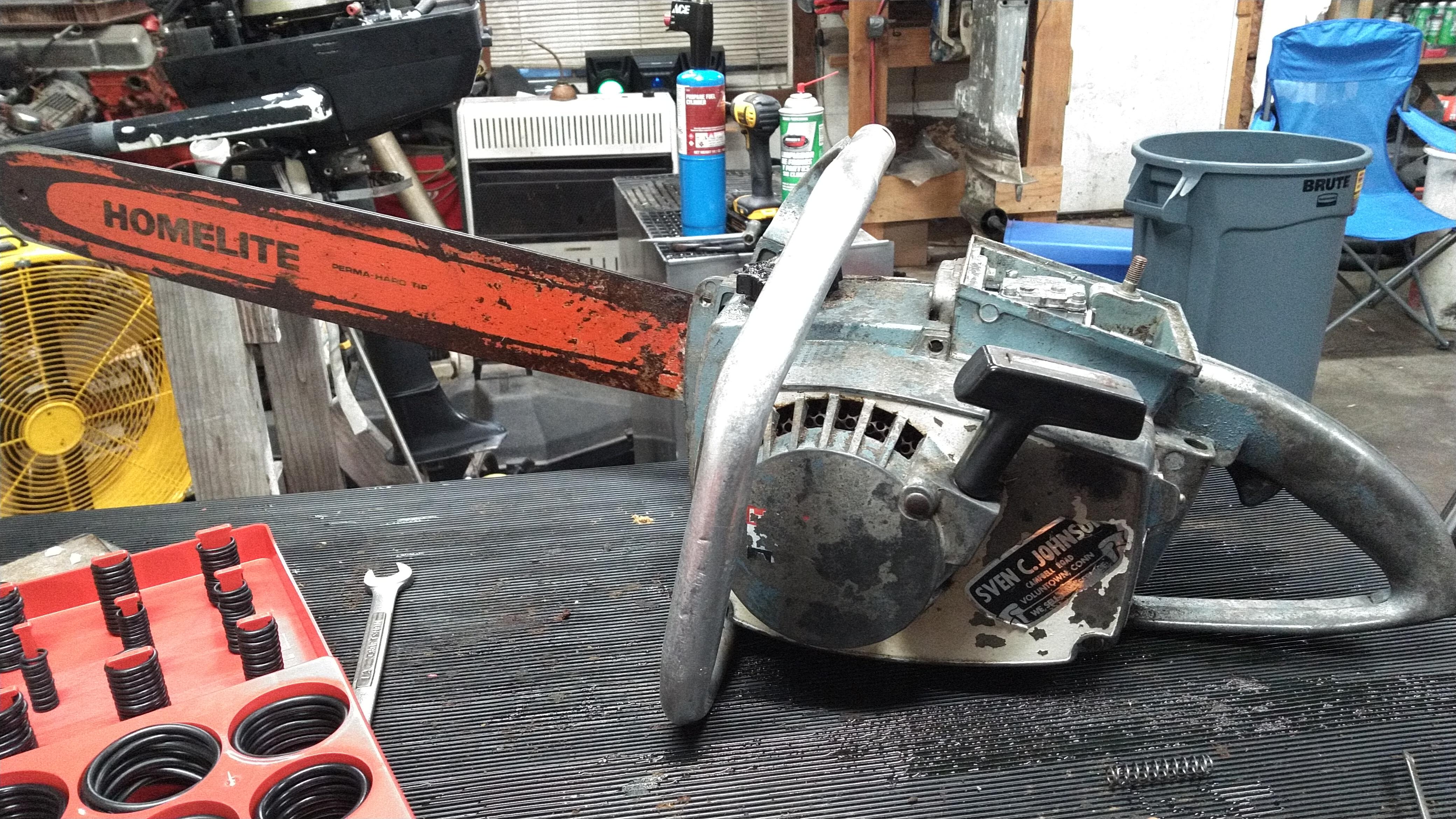

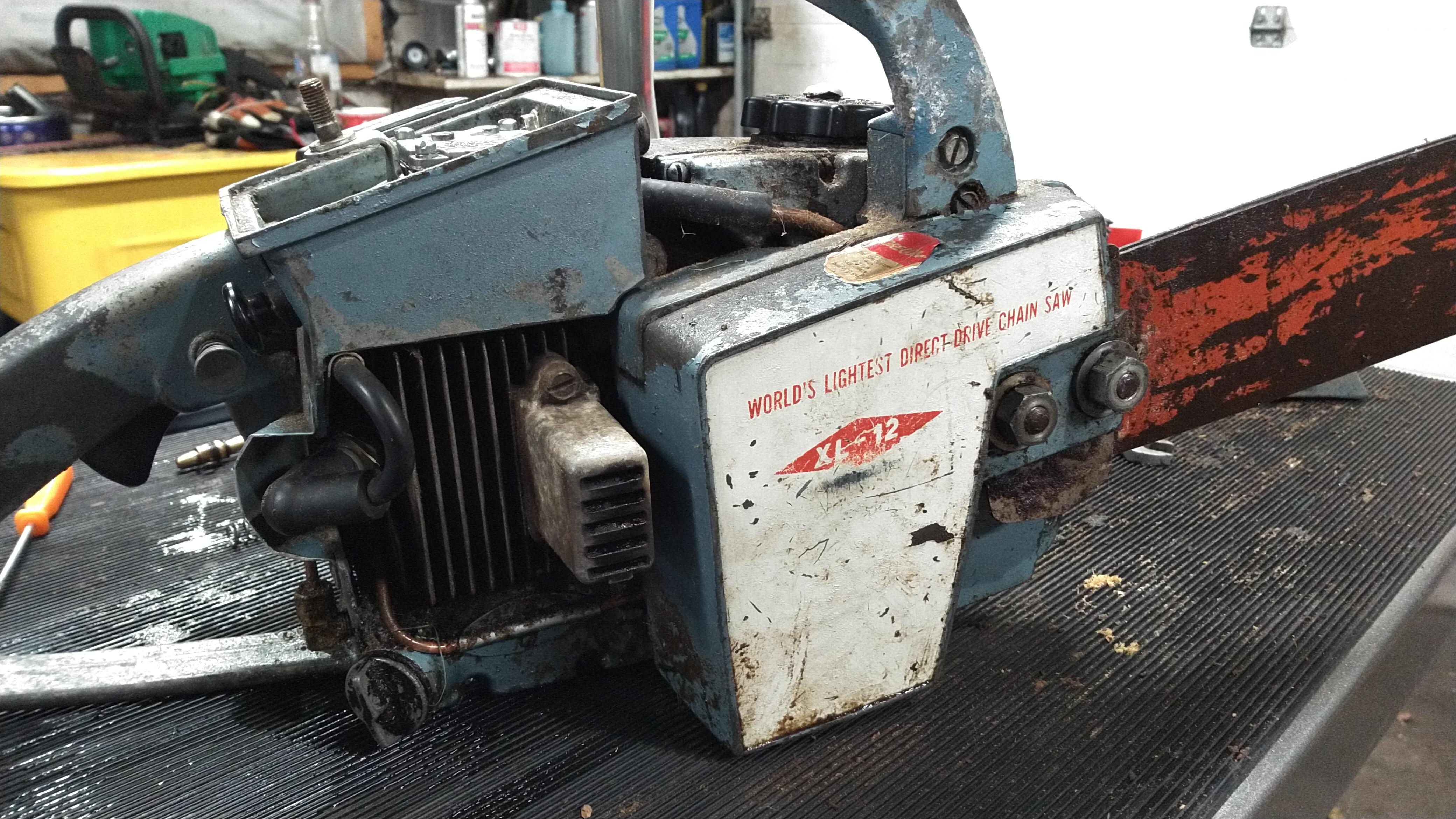

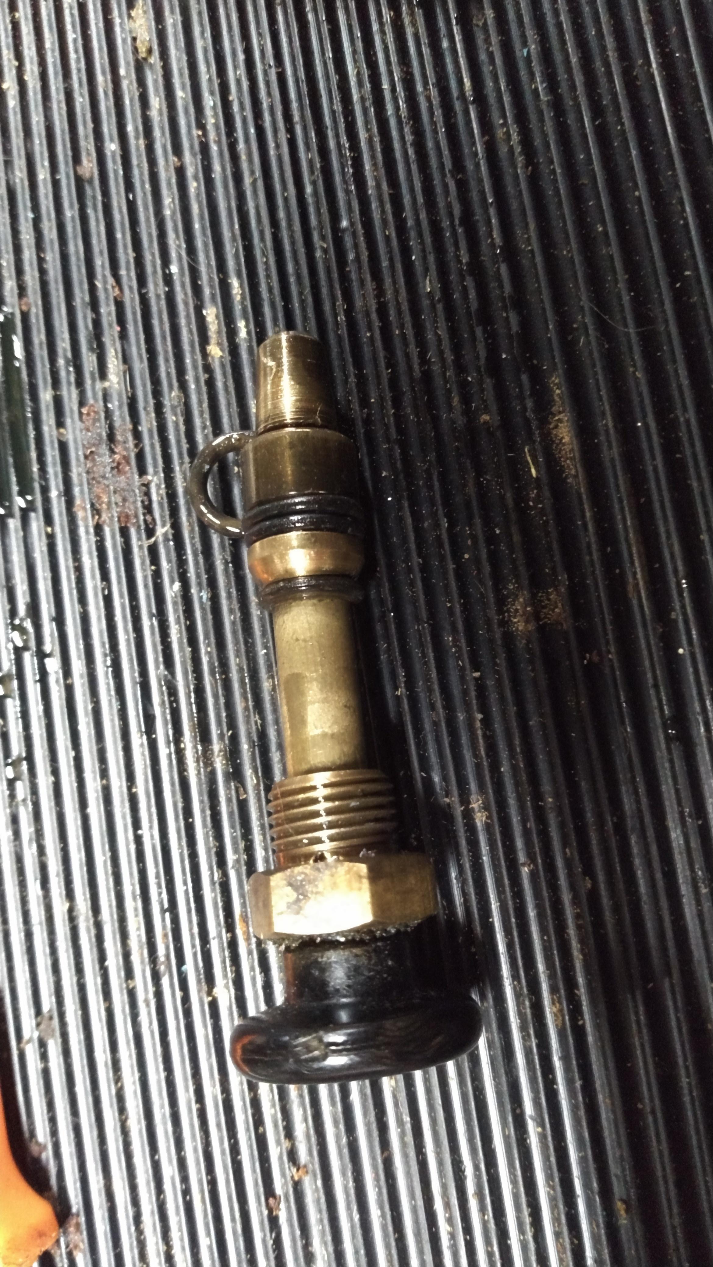

60s/70s Homelite Super XL. Replaced oil pump plunger o-ring with 2 new o rings. Manual oiler works excellent now. Tweaked the carb a wee bit. Running sweet. Ready for the big CT GTG.
