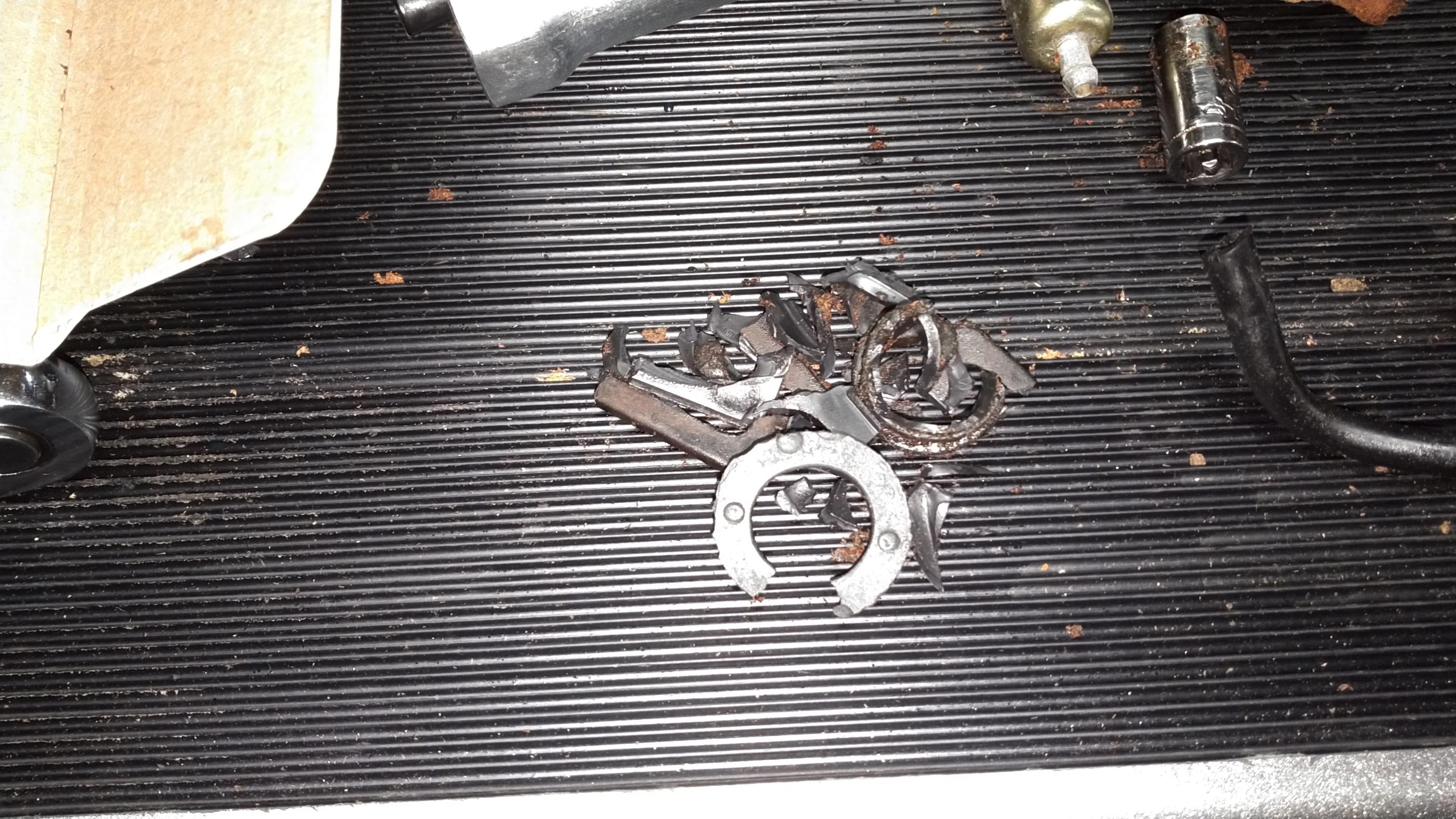

Finally feeling better after a week of in bed dealing with an upper respiratory infection I was able to get out to the garage today and start reassembling a customer's Homelite 330 I'm doing an intake boot on. Wasn't much left of the old boot. Installing new hoses while it's apart too.
