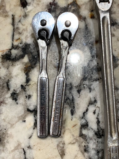

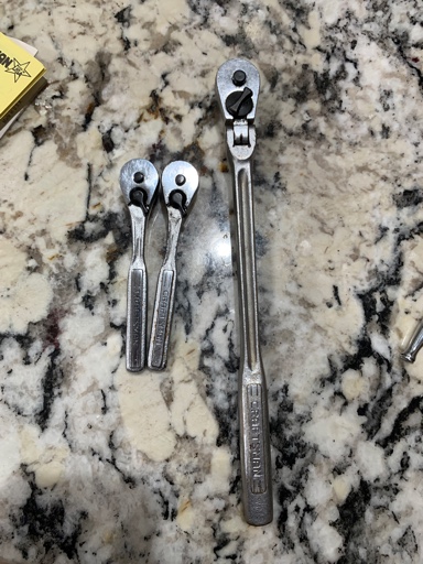

I didn’t get to work on any saws tonight but I did rebuild these three old ratchets. I could have warrantied then but by replace an good old American made ratchet with a Chinese one. These are the one with the “V” stamp.
