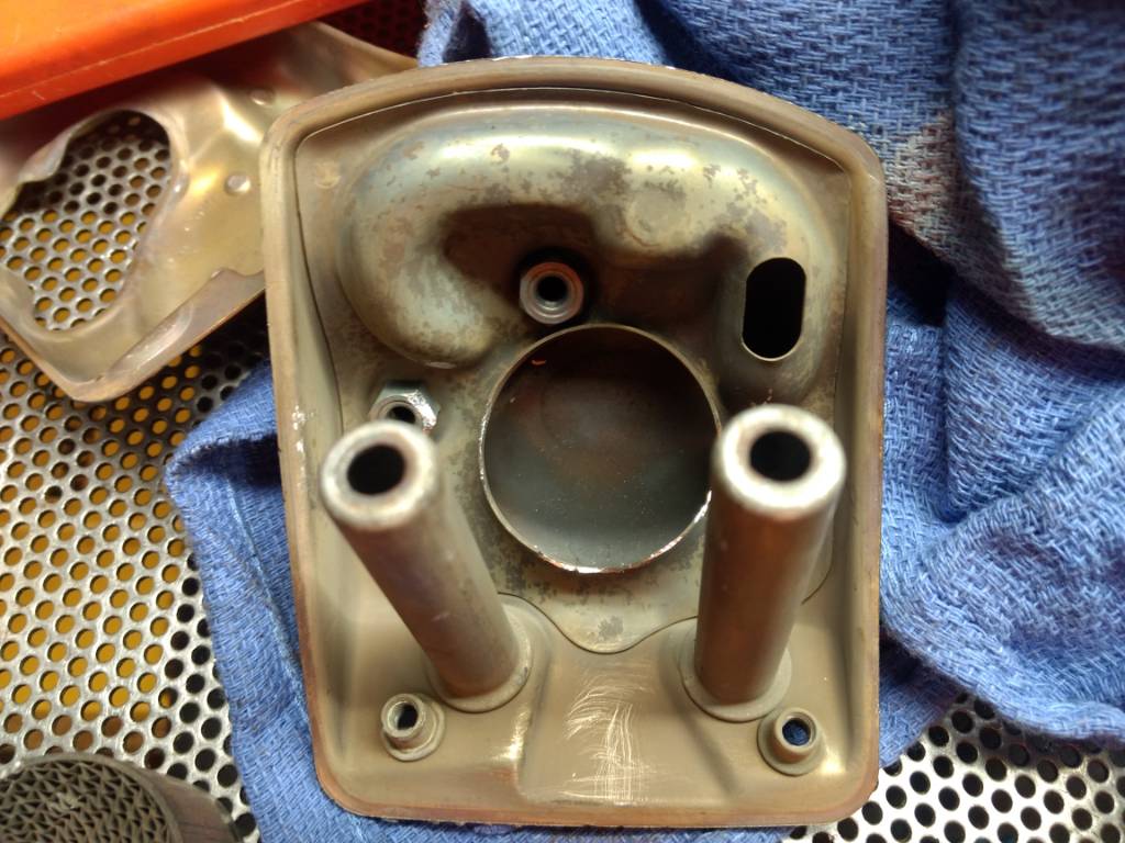

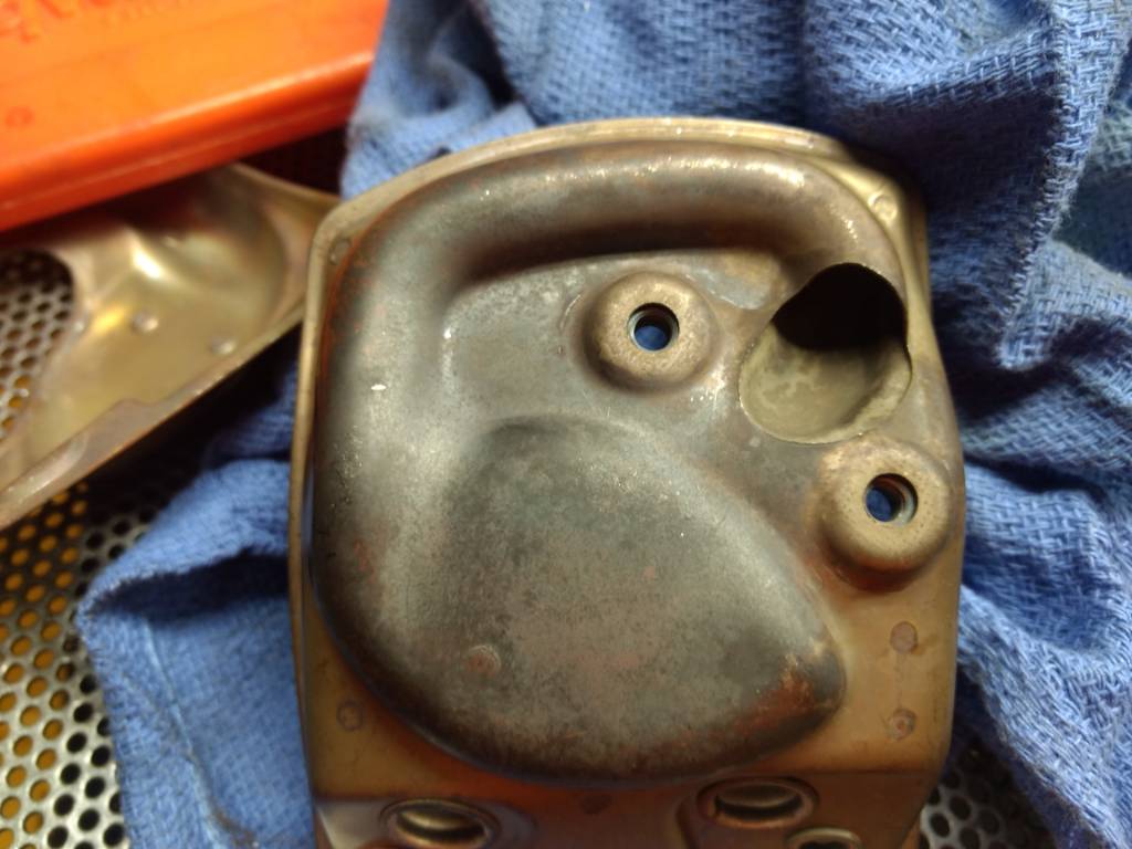

Yes understood on cat removal. The plumbing on these is not like the average bear though.
Open up that hole a little bit also.
I think I open up the exit side also( can't remember, it's been awhile).
Ok so kitty 86'd....
Just opening the area you circled would still have restriction through the "tube" to the exit and screen, no?
