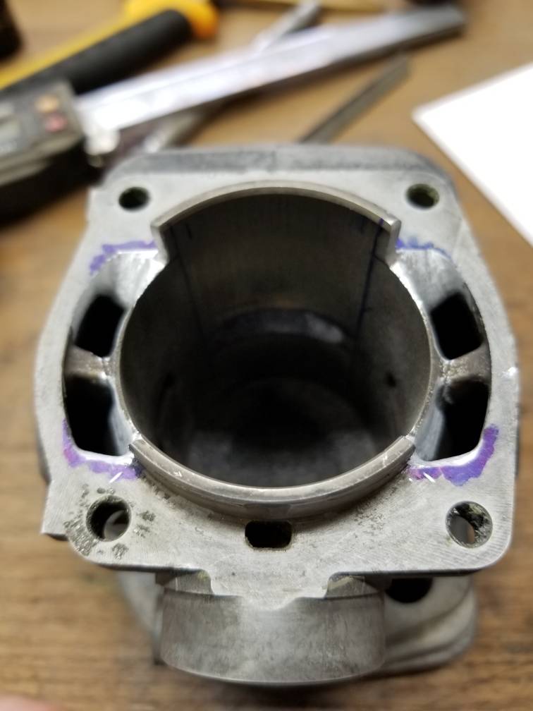

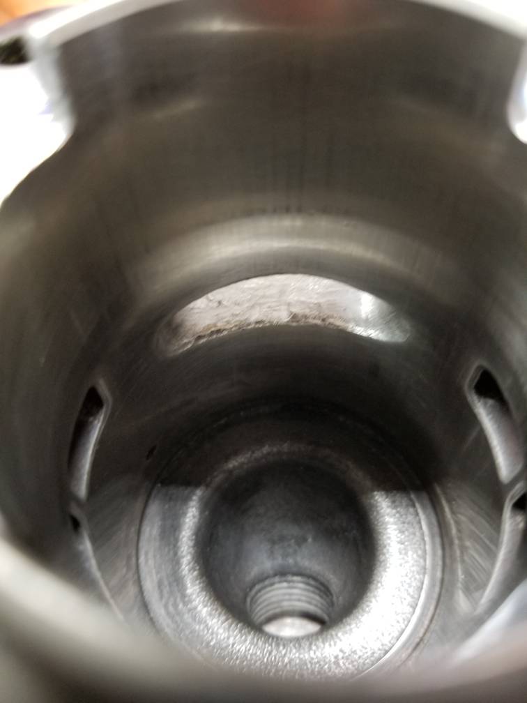

346xp porting done. Widened the intake and exhaust, took intake done to 77.5 maybe 78,kinda right at it
Ex.106
Trans.123
Int.77.5-78
No base gasket
Not as pretty as most ,but dang these cylinders are small.

Also case matched the lower trans. Forget that part lol

Yeah I agree, but without being able to cut base and squish or the ability to modify transfers your hands are kinda tied!
I'd leave the ex down. Just widen it out. Intake about 78
Id prefer more bd than he has. Not to mention I like my ex durations higher than most. Now that the intake is that long I would have definately given it more ex.
Do you think I should have changed the exhaust? I'm just learning bud,thas why I ask

Looks don't mean squat you did a outstanding job.

Thank you sir. Sucks I want get to run it till probably Sunday. To much family stuff gotta happen now.
Family always should come first but keep us posted on how it runs never herts to have something different on port timing numbers you could have made a monster you just never know and if it doesn't work out then try again with a different cylinder that's how you learn.
