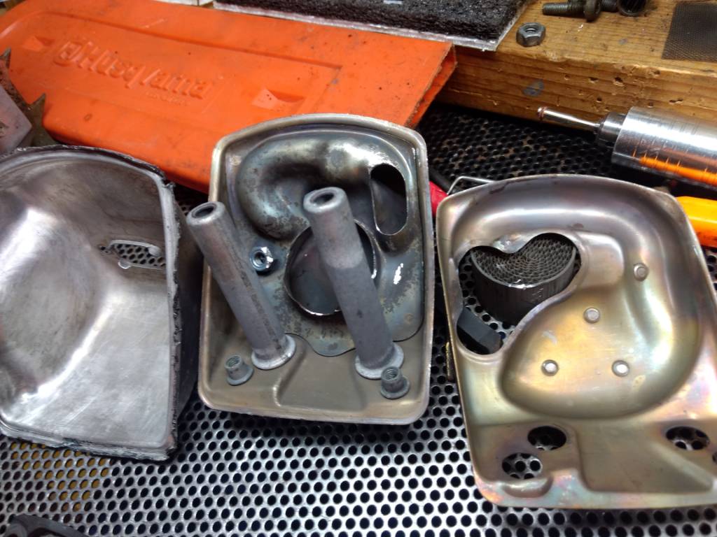

Ok so kitty 86'd....
Just opening the area you circled would still have restriction through the "tube" to the exit and screen, no?
Yeah you're probably right. I'd cut a hole for a straight through effect. There's not many dolmars around here. I've only worked on a pair of 5105's.

Numbers I got with no base gasket. What do yall think.
I'm thinking of going
Ex. 105
Trans. 123(cuz I cant move then anyway)
Int.78
And case match the cylinder ,clean up lower transfer angles

@Mkinslow
Just widen and square some, add a good bevel. Almost same numbers I had on my last one. Just skimmed the base and squish to clean and square up.
Thanks. I actually read that the other day about the exhaust
Ex. 105
Int.78
I'd leave the ex down. Just widen it out. Intake about 78
