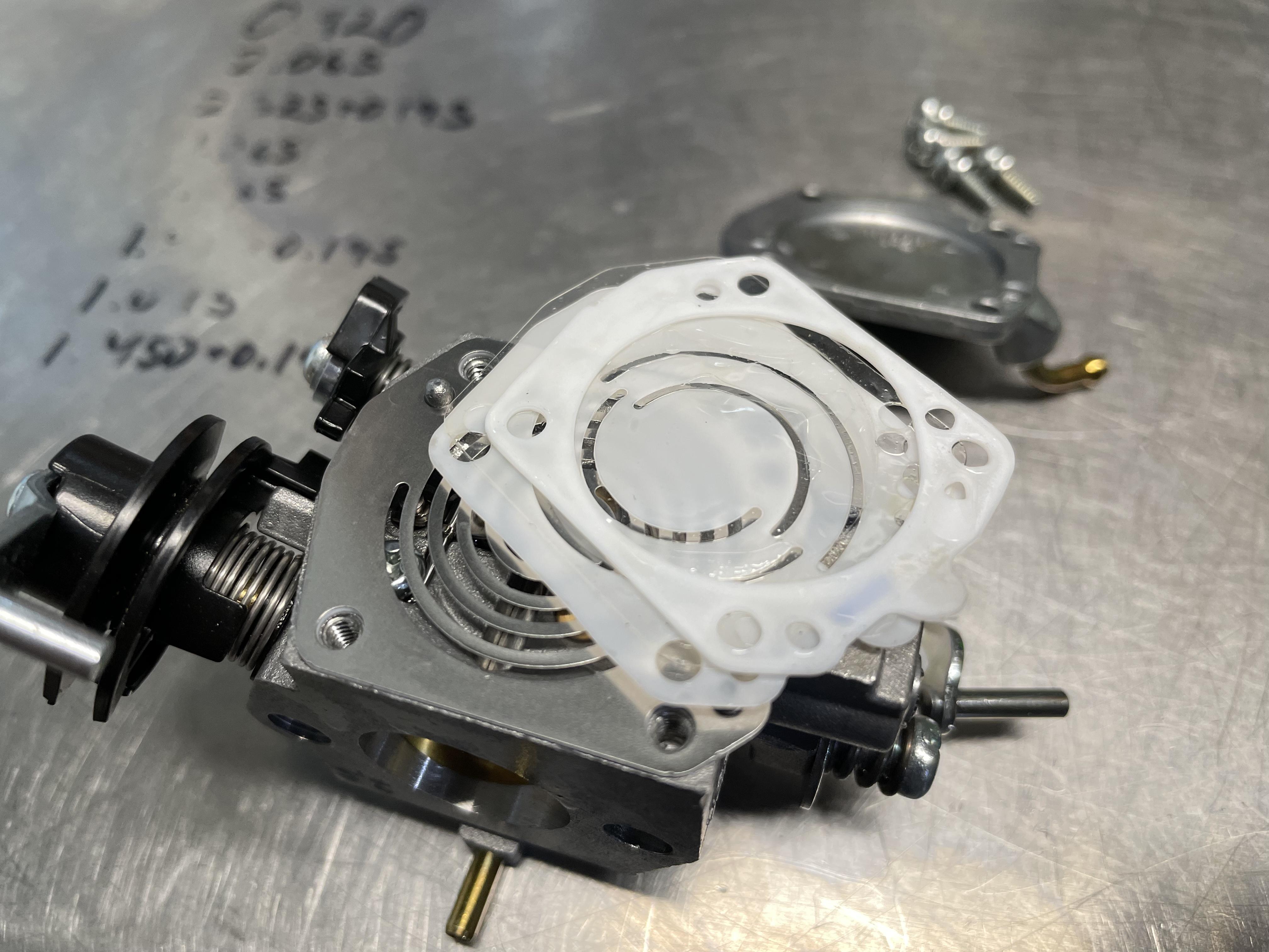

I was playing around with the 585 carb when I noticed both the 585 and 592 carbs have the high alcohol tolerant diaphragms. The pump side is also a clear membrane.
