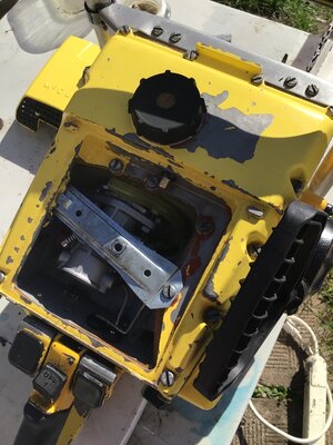

Like woodslasher my saw needs a serious bite, had a taste but bar/chain not cutting straight so worked on it and changed carb to a 090. Rumbles 👍. Have questions should have asked a long time ago. Does the filter get placed under the tank liner in a 797 ?. Finishing a grommet set up for fuel and want to get the run time it should have before done is done.
The other Question I have , is it all my gas cap allowing and causing the gas to continue to run through the carb and fill air box when off ?

If your airbox is filling with fuel, then it's likely the inlet needle not closing. It could be that the inlet needle lever isn't adjusted correctly or that something is holding it open. Old diaphragms can get sucked in and hold the lever down which keeps the needle open. The Mac gas caps originally had a check valve which allowed the tank to build pressure but disallowed a vacuum. So your gas cap shouldn't be an issue unless the needle is being held open. Of course, a lot of check valves in gas caps have rotted due to the passage of time so most saws aren't building much pressure in their tanks.

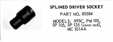

Does anyone know of a source for the special socket/splined Mcculloch connecting rod bolts?
You do need the special socket for the original Mac bolts. New nos bolts can be had as I have
found a few on ebay and keep a couple sets in stock. Terry Ives in Ca. uses allen head screws
with what he says better results as they don't break like the Mac bolts, But he is in the karting
world not the chainsaw world we are in. Not sure which screws he uses as I have never needed
them.

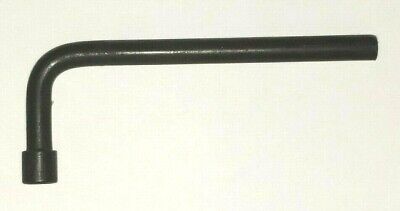

"Vintage Vixen was selling the "L" wrenches again recently under a new eBay name".( Mark )-----and she's selling them for around 50 bucks a piece for them . I have both the wrench and the socket .What I had done for a couple of people is cut down the head of a grade 8 socket head bolt to get the clearance on the stuffer . Nothing else I could think of would fit,low head, button head etc . I used "hollow chrome " bolts the toughest grade 8's I could think of at the time .
I have placed four different carbs on . Three of them have all consistently behaved the same, including the new 090 carb just bought new. I cleaned out cap and replaced valve and believe it to be working.
Then maybe the fuel line barb is leaking?
No just a steady second and a half wait for a tear drop amount to come from the back. Thankfully saw sits with a degree back so doesn’t go down the manifold. I am just going to disconnect fuel line from tank after use if keeping gas in tank.

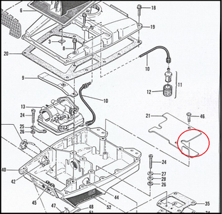

I had another question, fuel filter and placement. Does it go under fuel liner, my brain says no because it is there to protect tank from the weighted filter, just so much gas not able to be used confuses me.
I would guess that it would snake around the right side of the liner (circled in red) and the fuel filter would rest underneath it. This to me would seem to allow the filter to move around a bit, but not bang around the fuel tank and allow it to help maximize use of fuel in the tank rather than sitting on top and not being able to get to the rest without potentially putting the saw on its side.
Yes, that is how it appears to me. It has been two years since I began this project , wish I remembered how it came out. Almost sure it was on top though. Finished the saw yesterday and am happy with how well the tank is holding as well as grommet with seal all. First time I’ve completely filled the tank. Problem with slow leak fixed. The valve was completely shut, gave it a squeeze to pucker and no more steady drip.
Yes, I do the same thing, wishing I had taken more photos while pulling the saw apart! Glad to hear that your leak is fixed and that the saw is working as it should!!

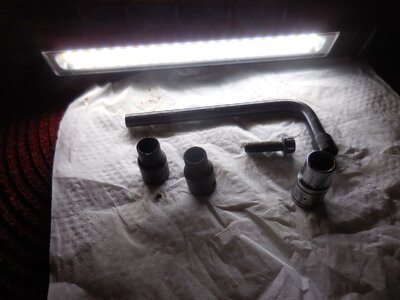

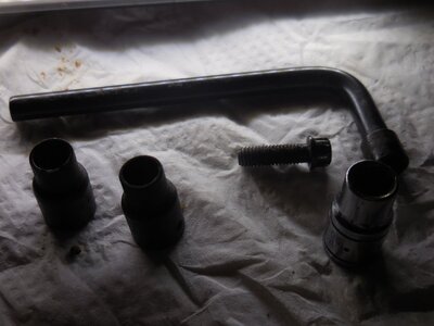

When I find the time I'll measure a splined screw and also if I can one a small 12 point socket .It may be the internal size could fit the screw with every other spline cut loose using a Dremel .It might work might not .
Al Smith
7:51 AM
537
Jan 14, 2016
6,728
15,074
North western Ohio
I found the two spline sockets plus the wrench plus a spline screw .Where that second socket came from I have not a clue .I also found reading over the splines is .261" .A 1/4" drive 1/4" six point socket fits nicely but I'm not certain you could gain enough "purchaase " to remove or install the screw .Numbers on the socket are 1620-09 .Numbers on the wrench I could not read them even with a jewelers loupe
