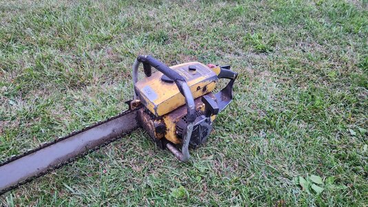

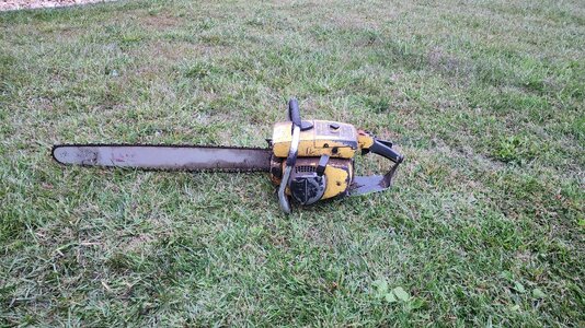

Hoping someone here will help me out as I did some searching, but can not find what I am looking for.
I recently purchased this Pro Mac 850 and fired it up today. It will not fire with the choke on, but will start is i squeeze the throttle a few times. Also, what would be "stock" settings for the carburetor? It is a Zama twin jet carburetor. Thank you in advance for any help.

Scott, I would normally start with 1-1/14 turns open on both H &L. The fact that it starts with throttle and no choke would indicate flooding to me. I would go through the carburetor and make sure everything is correct (holds pressure, metering lever setting, etc., and you may need to test the HS check valve if it floods out at idle.

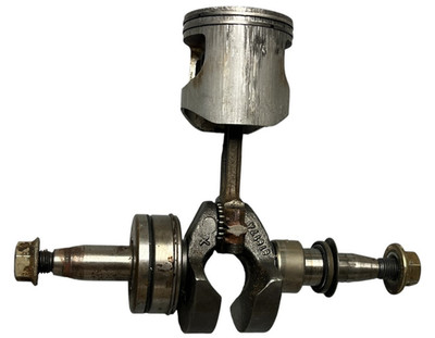

Mark,according to the IPLs I have,the PM10-10 & the PM55 take the same crankshaft,part # 87699 for both.I've got a 10-10 short block sitting around,but I don't know what it came out of.I'll have to look in the a.m.I did find a partial short block from a PM 10-10 on feebay for $13 + shipping.I'll have to check with the seller to see if it has a points cam.

I didn't find the short block for the 10-10 today,but I have a couple other places to look.The crank on feebay (according to the seller) is keyed at both ends,so that one won't work.I think this saw will be a winter project,if I even decide to do it).
These are all over ebay and lots of guys have them as the cranks didn't go bad on these saws. Best thing is to find a used one with decent bearings.
Did a search on ebay and this one would work with your saw. I looked it up and its a a left hand start with points. said he was running it so guessing bearings are good I'd replaced seals in case that was the cause.

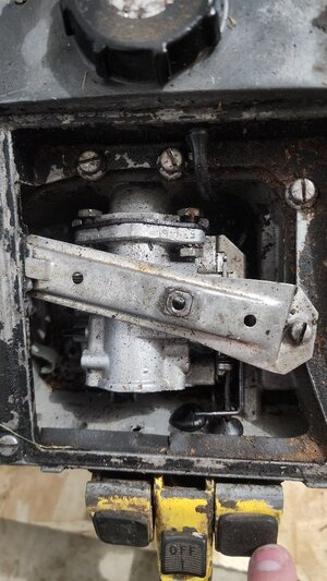

Wondering what you guys can tell me about this 797 carburetor. I believe it is a Mcculloch flatback? From old threads I have read parts are almost non existent and they are hard to tune. Can anyone tell me why?
Also, what are the issues that the primers have? Just wear out with use and time? Thank you in advance for any help.

Scott - I don't know if I tried to put together a similar thread here on OPE Forum, but there is a pretty complete thread on the Walbro/ MAC McCulloch flatback carburetors (including rebuilding the primers) on AS https://www.arboristsite.com/threads/mcculloch-carburetors.122113/
The MAC carburetors are a bit different from the cube type on more modern saws, but I find saws with the flatback actually perform best. Adjustments can be a bit more sensitive, but they do seem to work well on the saws they were intended for.
Kits are readily available these days, and for someone not inclined to rebuild the primer themselves, I have some rebuilt units available.
Brian Genrich (Old Saw Shop) and Jeff Fox (Cinci5) both have the gasket & diaphragm kits available, Jeff had his on sale last month (eBay) https://www.ebay.com/itm/1565372273...XFM01K&hash=item2472588881:g:0BEAAOSwOFNnbbtg
I took a look at this crank & piston,& the piston is pretty well shot - it's got some deep scoring to it.You might say "change the piston",easier said than done with me.My vise is broken,so I can't press the wrist pins out & in.
Hi Ed,
I wouldn't do a piston swap either...
I would remove 2 rod bolts and needle bearings and swap the rod and piston from your saw onto the new replacement crank. No press needed.
It's listed with free returns so if it comes in and the bearings are bad or the rod blue from overheating on the crank side its a free return.
Looking forward to seeing your resolution...

Hi Ed,
Brian
I contacted the seller & he said there's no blue to the conn rod,the keyway slot looks good,& the bearings have "normal slop".I'm not afraid to change the bearings if need be,I have a bearing puller & have used it to pull bearings on a 600 series saw.The thing I worry about is changing the conn rod fropm my saw to this one.I've never done a swap like that & all I can envision is the needle bearings all over the place.My vision is not good.I may do it in an aluminum roasting pan to save any needles that may fall out.I did end up buying the crankshaft.Thanks Brian!
If you swap the rods by removing the rod bolts and swapping them from the old crank to the newer one keep in mind two things. A) the rods are cold broken when manufactured. The rods caps are mated to one particular rod. Make sure you keep them matched and mated. B) use the same needle bearings with the same rod. Torque spec on rod both is 65-70 inch pounds wet.
What He^^^^^^^ Said!!!
Ed if it doesn't work out I think I have one. Let me know.

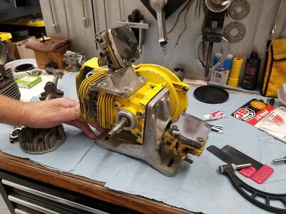

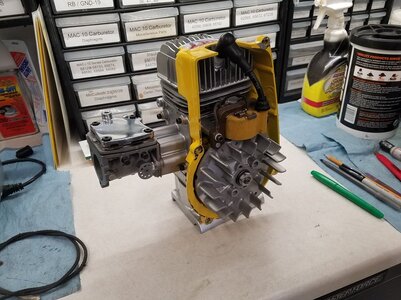

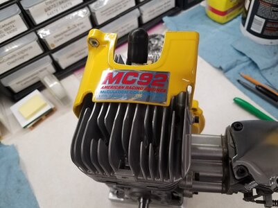

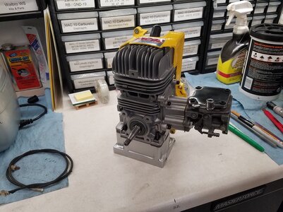

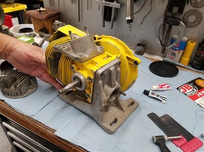

These came across my bench today, not mine and will not be, but nice to look at anyway.
MAC6 started life at 2.125" bore, now at 2.191". Has some port work, 5 degree flywheel with shaved fins, and a very special kart engine mount with crankcase stuffers and an extra intake.
MAC92 all dressed up with no place to go, well in fact I think it will go on an enduro (laydown) kart.
