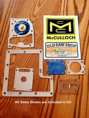

There are two 1/4" screws in the back and one through the side of the case (long screw goes into the carburetor area) and the entire housing comes off in one piece.
The breaker points are accessible under that cover just above the fuel cap.
The cover and carburetor are pretty straight forward to access, you can see the screws all around.
If you have to get into the fuel pump that is more work, the bottom of the fuel tank has to come off.
Ralleyguy has a complete fuel system set including the tank gasket available. Old Saw Shop on eBay.
Once you work your way through them, the 33/35/39 model saws are some of the most reliable starting saws you will ever find. Loud, slow, heavy, awkward, but very reliable starting.
