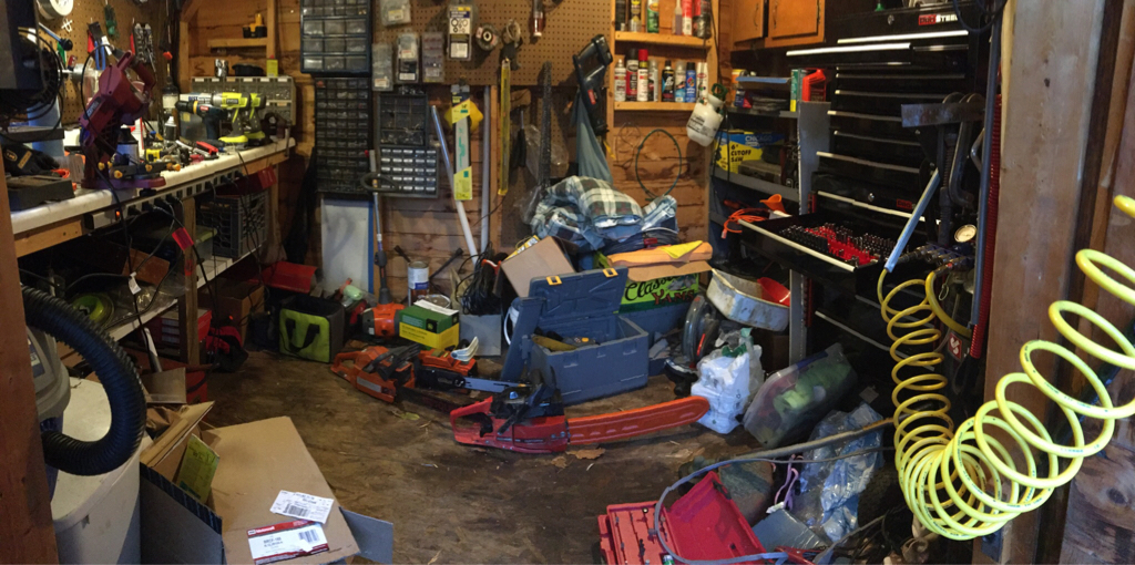

Painting the ceiling and walls white helps a lot with the lighting. I went with 8' H.O. fluorescent fixtures and had to split my lighting into three circuits for the workshop (2) and garage (1) to avoid overloading the circuits. I added quite a few hanging outlets so I didn't have to string cords across the floor, went with a lot of gang outlets around the perimeter as well.
I also painted the floor of the workshop with two-part epoxy; really helps when it comes time to clean up.
But one feature that I use the most is an air hose on a retractable reel just above my workbench. Reach up for air and store it out of your way when you are finished. I also hung a retractable electrical cord with a drop light, the light doesn't get used much but it does have outlets as well so their is power right within reach.
