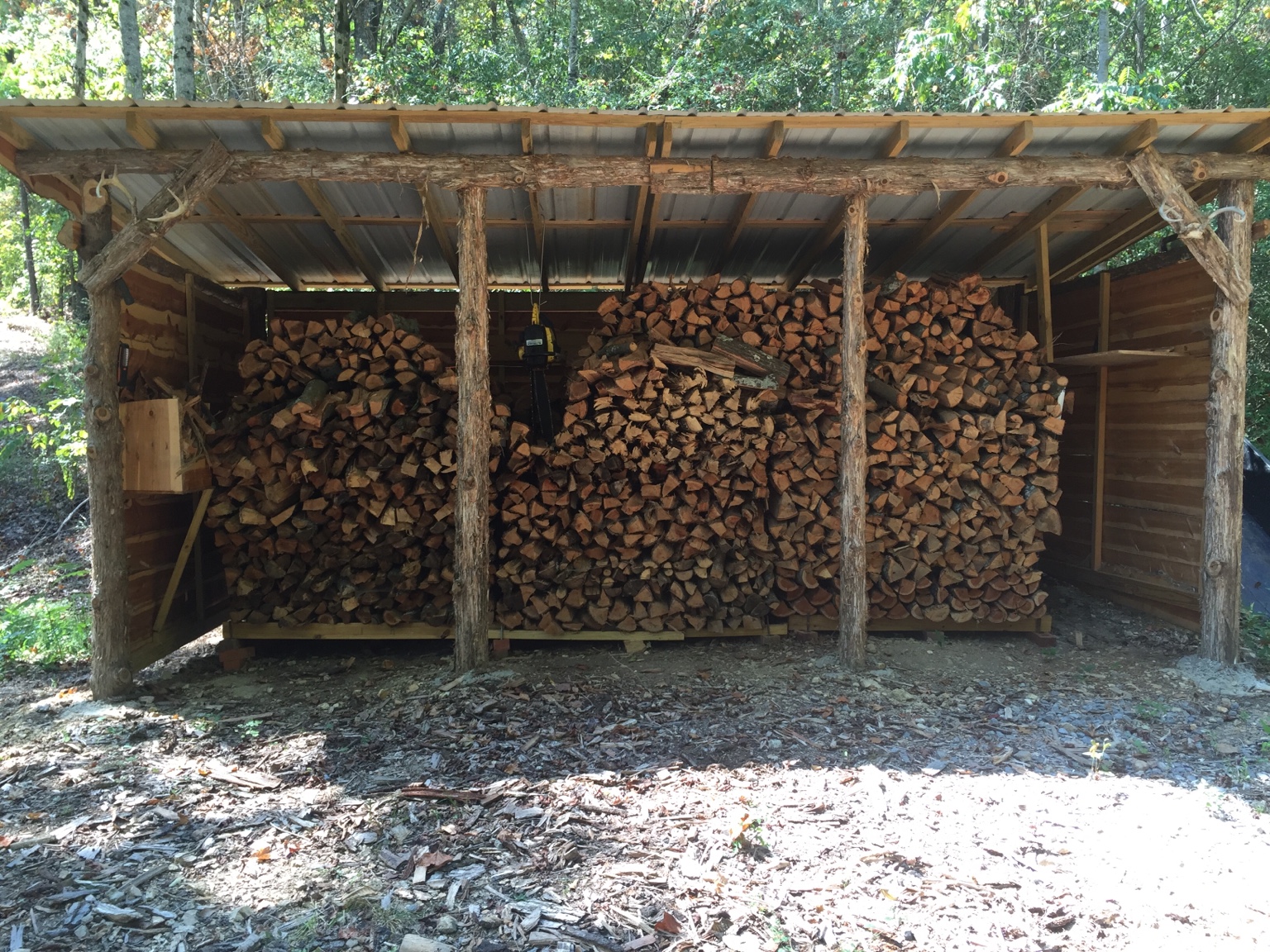

I may be a hoarder, but I use them all the time. These McCulloch chainsaws built the woodshed and put all the wood in it!
