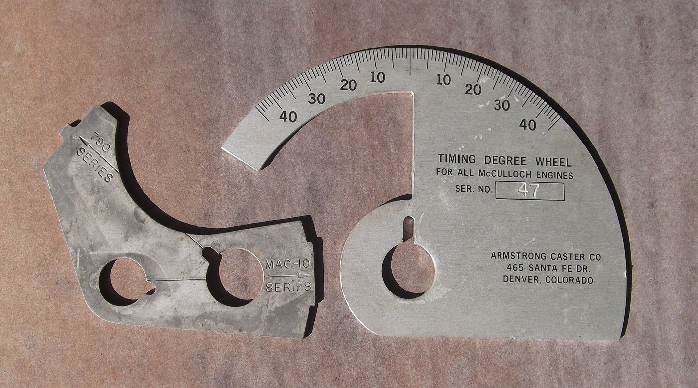

There were also timing tools that McCulloch supplied for the large frame saws and for the PM6/MM models. I didn't find a photo of the LF tool but this is the one for the small saws. You put it on the key on the crankshaft and observe the position when the points open (ohmmeter goes to "0").

Here's the timing tools I have. I've used the one on the left a few times when assembling projects that came in a box. If any of you guys want to borrow one or both of these, let me know.
Jacb,
What do you line the degree wheel points up with on the armature?
Are those totally flat steel?
