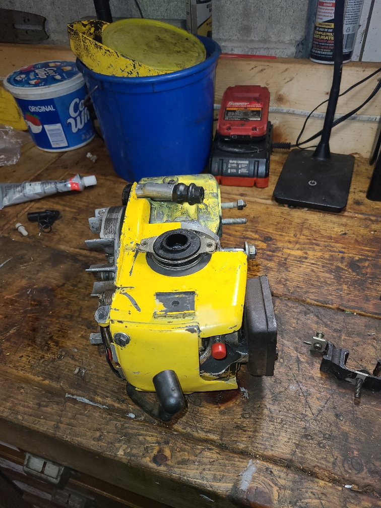

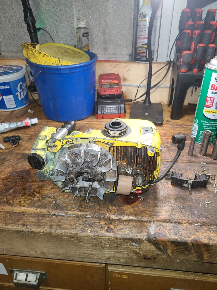

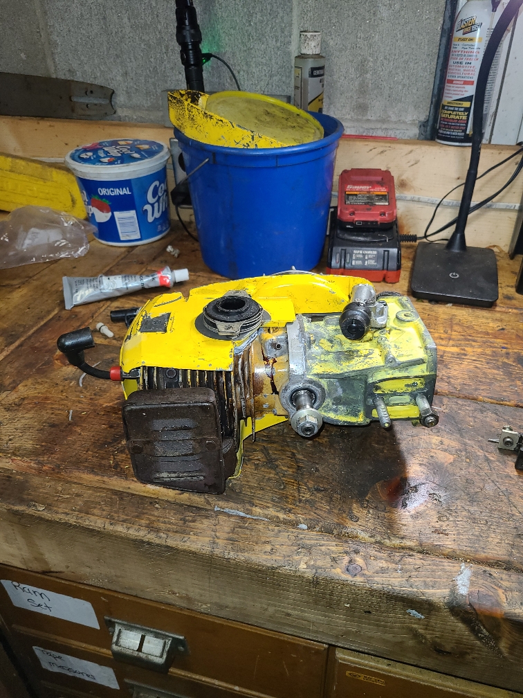

So I worked on the PM6A today. Thought I had a fuel delivery issue. Nope. Crank seals are gone.
Has excellent compression. Piston and cylinder look really good. Glad I ended up taking it apart though. There is a ton of vanish and crud in the clamshell cover. That probably would have done some damage if id kept running it.
New crank bearings and seals are in order. Anyone know a cross reference for these?

I don't have the information in front of me right now. Just measure the shaft and the bore, I am sure you will find they are standard sizes and you can find them easily enough through a good bearing shop or by searching on line.

Seal part number 67175 .Could not cross reference but there are several on flea bay .Bearing number 66854 .No cross either but it looks like a roller or needle bearing .Shouldn't be a problem

Thanks guys. I can see a Torrington # on the bearings.
Nothing on the seals. I will get measurements. There's a bearing supply here in town that may be able to help.

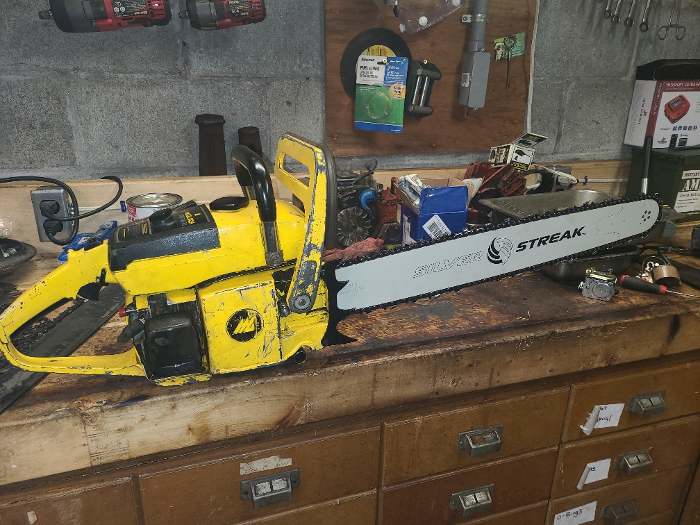

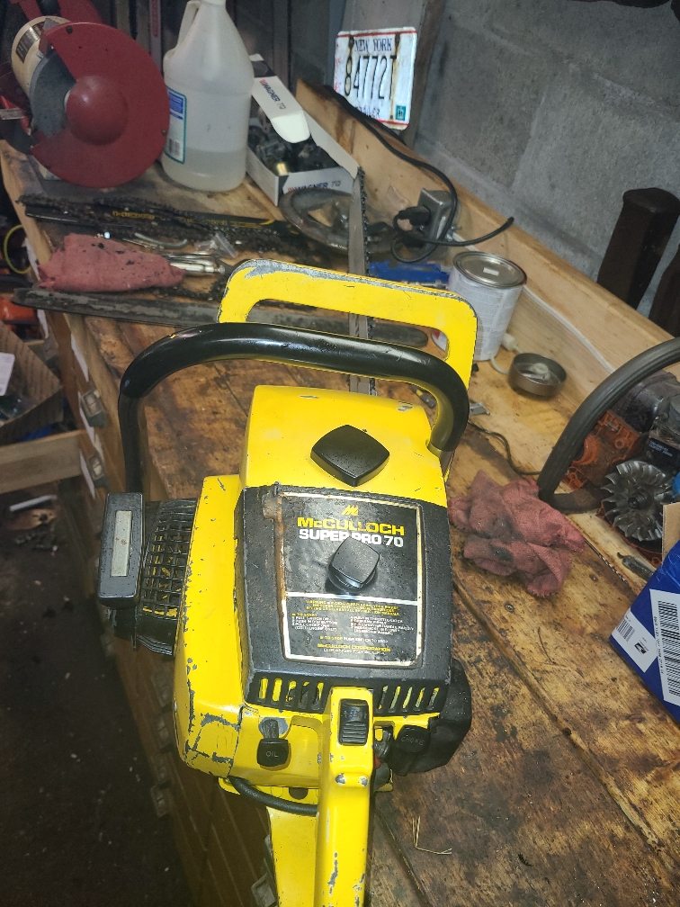

Hi guys, I thought I'd pop in and show you guys what I've been up to. It's been a minute lol.
I just finished up this SP70 for a customer. It is a really clean saw and runs great. He should be happy with it.

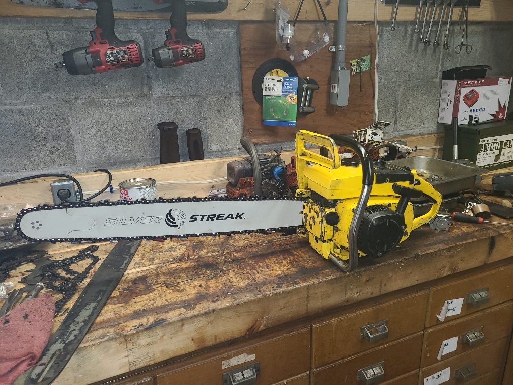

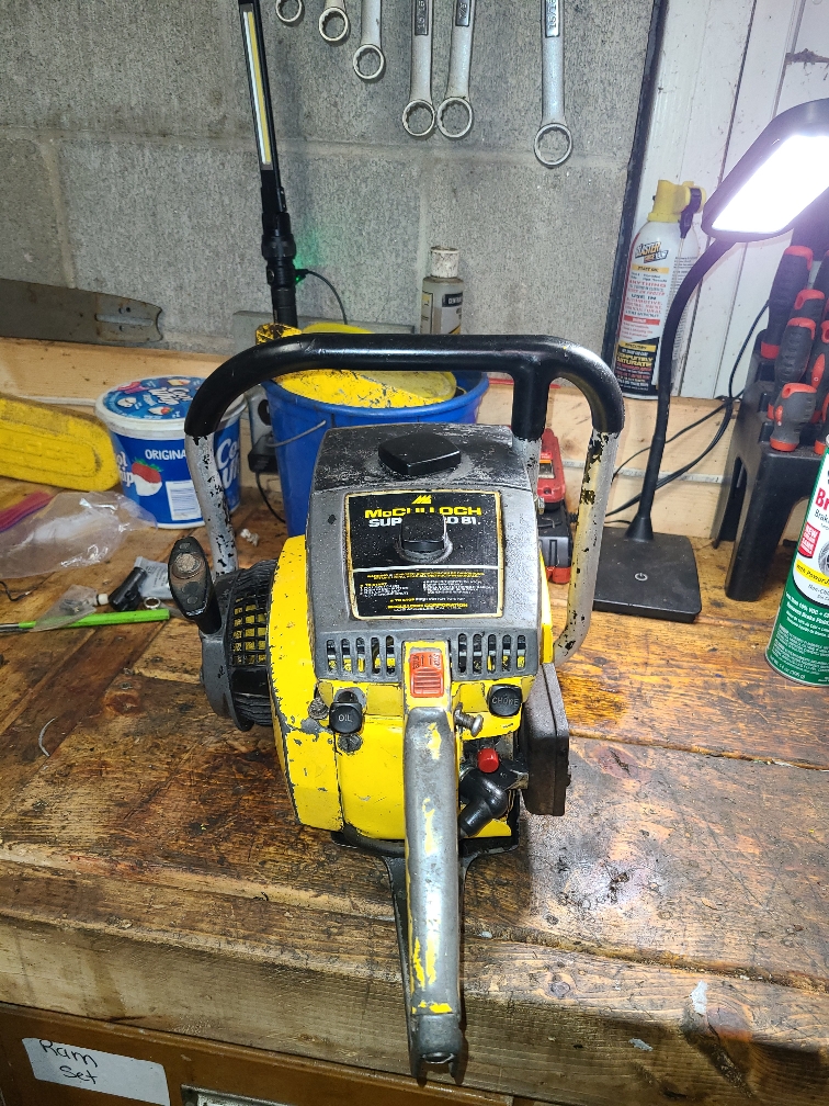

Next in line is what I will refer to as project "Scrap Heap". It is an SP81 that I built from a pile of parts from at least 3 saws. It has an infamous LRB piston and rings in it that was uses for no other reason than it came with the box of parts. The oil tank is cracked and I could use a replacement if anyone has anything,it is the "sideways" oiler tank with the snap ring Grove on the clutch side vearing. also needs the rubber grommet to go around the adjustment needles. And I would like to find a nonbrake clutch cover.
Willing to pay for parts is someone has something.

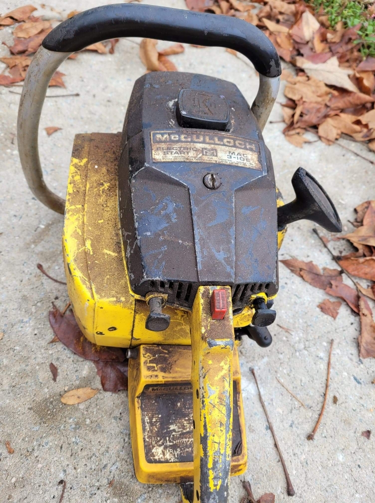

Next on deck we have this 3-10E. 145PSI compression, no spark. Hoping to get it.running and the E start working as well.
Sent from my SM-G981U using Tapatalk
That's sweet. You have the rarest part which is the battery box. Most of them where thrown away and replaced with the normal strap that was there.
