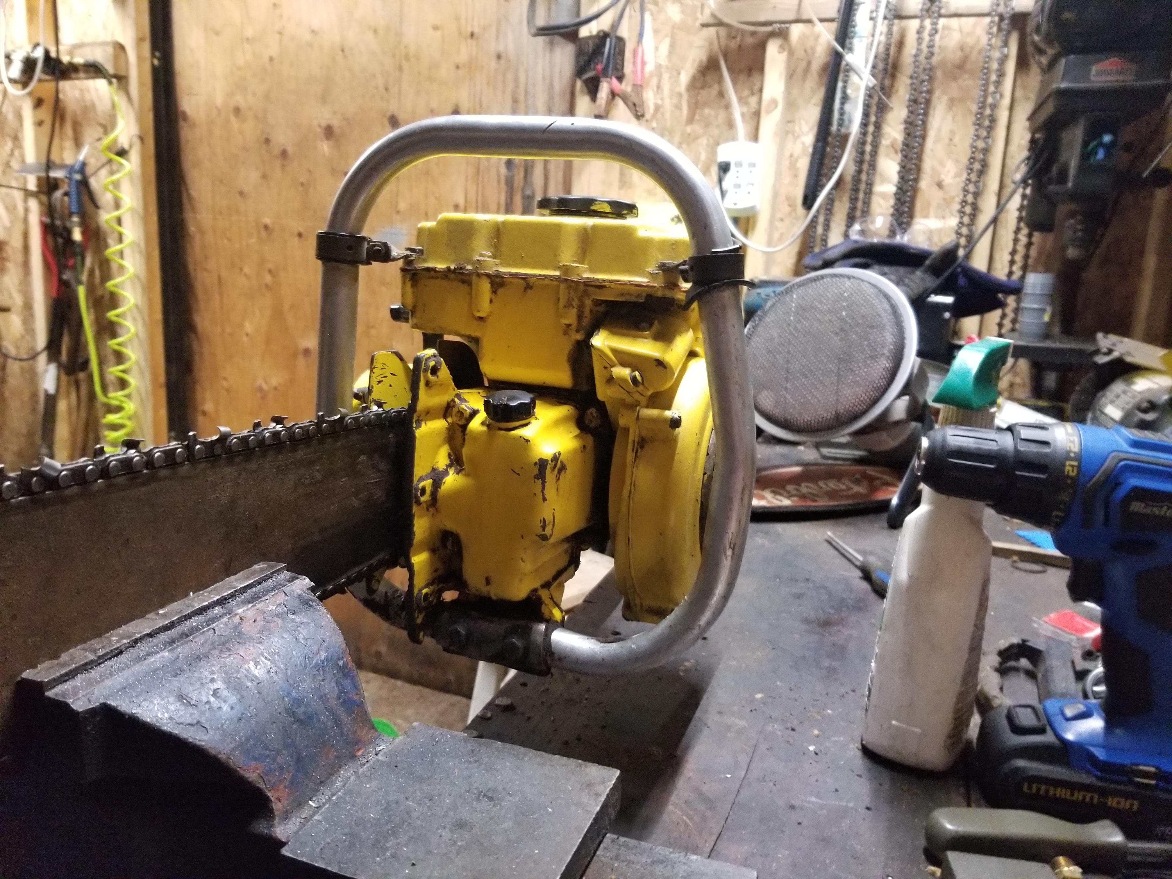

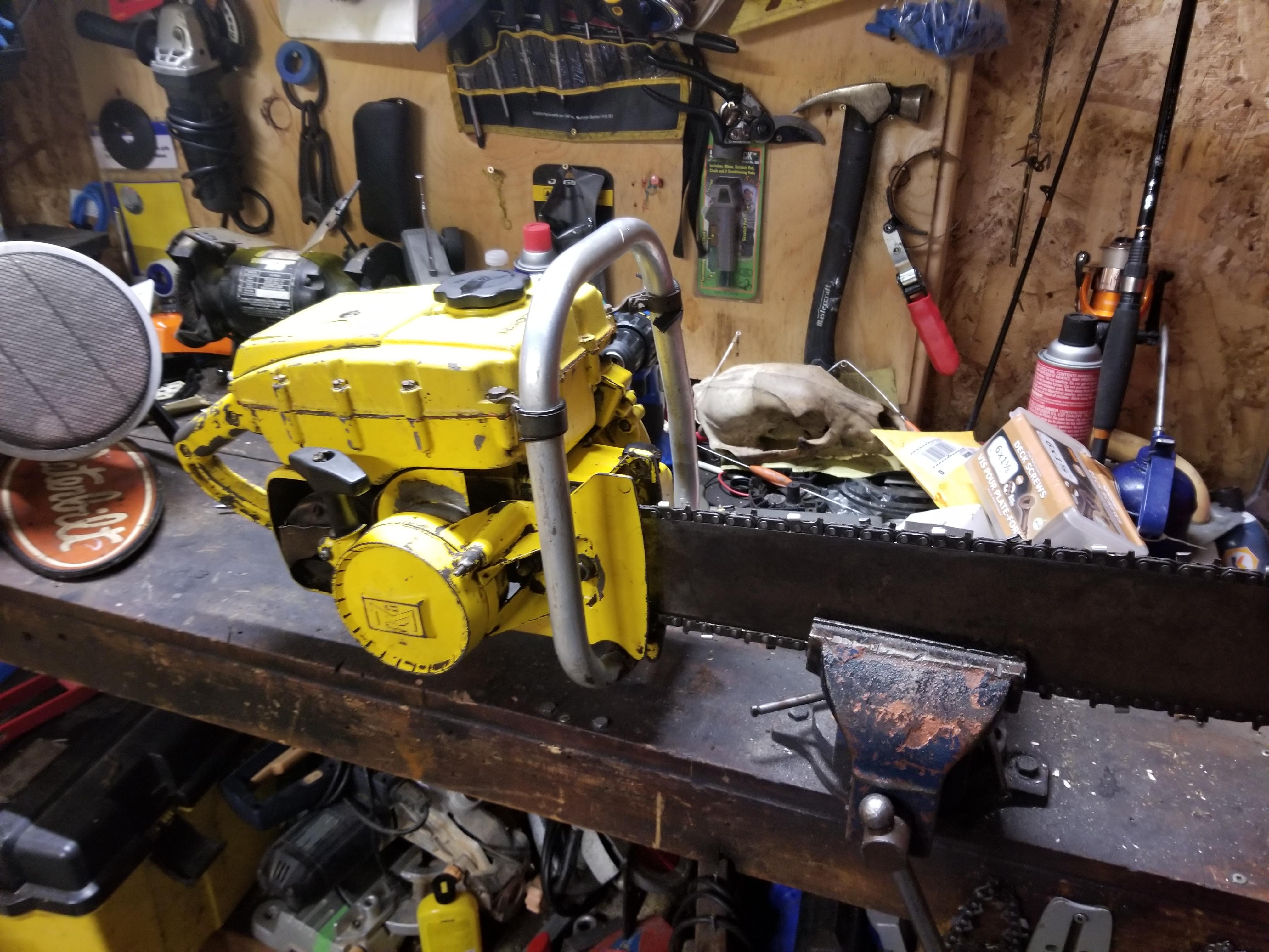

Gave the D44 a little cleanin and chain sharpen today. Should have taken a befor pic but it was pretty bad.
Like that little catalytic heater too.
Ive got one about like it.
Coleman Black Cat?
That little heater is great. Wont heat my not insulated shed but gives heat where im working. Its a coleman but cant recall the modle.
