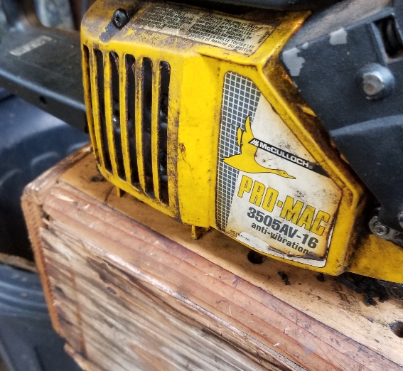

What was story on these??
A guy gave me one that was not uses much , hasn't ran in over 10 years .
Fueled it up ,
Started on 3rd pull.

A lot of those up in Canada. They seem to run well and spew bar oil.
I always felt like it would fall apart if it hit a knot in the wood.
Weak spots are the oiler hose and the oil tank filler neck.

Machine - those saws were built by McCulloch after the move to Tucson, the assembly plant was in Hermosillo, MX. They usually require new fuel and oil lines, might as well replace the snap in primer too. Replace the gasket in the oil cap so you don't have to strong arm it to keep the cap from leaking. Many of those saws were killed by overtightening the oil cap and pulling the threads out of the filler neck. If you keep in mind it is only 35cc, it is not a bad little saw and you won't feel too badly if you drop it out of a tree or run over it with your truck.
