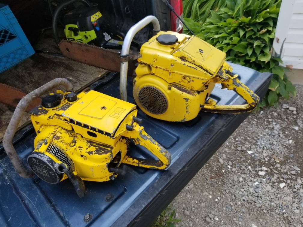

The 44 is indeed a 44 with a 44-A air filter cover. The 44 and 55 were the same engine, 44 direct drive and 55 gear drive. The give away is the spark plug in the center of the head, the 44-A and 44 Super A have the spark plug off center to the flywheel side.
The 44/55 have a stamped steel air filter cover, the A and Super A have the cast air filter cover. All of the Super's (44 and 55) I have seen have the hockey mask cover on the flywheel side but the flywheel cover can be swapped.

I had a few mins to mess with the macs tonight. The 44 has no spark so it will wait for a bit. Got to finish up a couple.other saws first.
The 1-21 (i think it is) has spark so figured giver a whirl. Put some gas in it. Few sqirts down carb and it fired up. Wont hold an idle but will rev up. It needs a carb clean and a kit. Tried adjusting low needle but never made any difference. Will put on shelf for now. I ordered a few kits a couple weeks ago so they will be in in a month or so on ebay lol.
Hey anybody know if these two saws share the same coil points and condensor. I have a spare 1-21 carcase kickin around to rob parts off.

So i am still kinda confused about this mac d44 that had no spark so i thought. Here what i found when i played with it tonight.
Pulled new plug out of saw that ran. Put in plug boot then plug on motor to check spark and nothing. Got out cheap inline spark tester and nothing. Then for somereason i tried in line tester in plug boot but put the end that goesnonnplug just restin on sidemof motor and it lit up like crazy. Confused....
Went through a few new unknown plugs i had layin around and put in plug boot and one of the three new plugs sparked. Sweet so i put it in and she fired up after a few squirts down carb. Once it was warm i grabbed the original plug i tried retested for spark and nothing. Now this is what gets me. I put it in anyhow and it fired rite up again. Any idea whats goin on with that?
