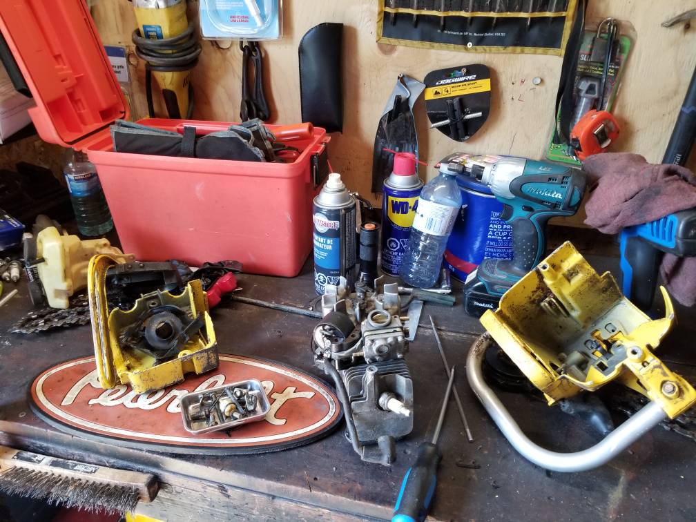

Got the mini mac on bench tor apart to put fuel line and carb kit in. Also has the broken recoil so gonna try a fix i seen on youtube. I tryed supor glue but didnt work and i was to impatiant to let it dry i guess.
