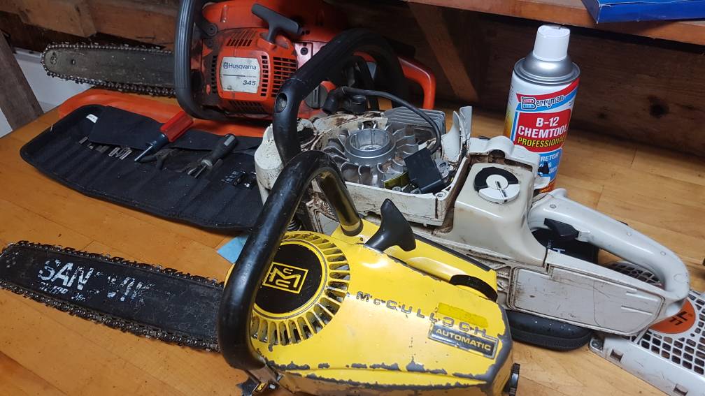

Cannot get my Mac to idle, runs fine but will not idle , carb apart 2 times...

Low port got some gunk in it maybe, or seals as I understand on them.

Power Mac6, though still somewhat annoying to repair, is nowhere near as curse-inducing as a mini mac ive found. Also a light and well balanced top handle saw. Much better feel than the minis.
Also, nice and LOUD!!
Machine, I know you said you cleaned the carb twice. Did you install a new kit as well? I cant remember if these have Welsh plugs in the carbs, but if so, pop them out and then soak the carb overnight in a commercial carb cleaner. I bought my 1 gallon bucket at NAPA. It comes with a parts basket to keep from losing the small stuff.
Rinse everything out with clean running water before blowing out with compressed air. Dont put the parts basket back in the bucket with any water in it. Water settles to the bottom and rusts a hole in the bucket. Dont ask how I know.
I have cleaned a lot of carbs that someone else "cleaned" before. It just takes a little more than a squirt of carb cleaner to get some stuff to let go.

I had a few mins to mess with the macs tonight. The 44 has no spark so it will wait for a bit. Got to finish up a couple.other saws first.
The 1-21 (i think it is) has spark so figured giver a whirl. Put some gas in it. Few sqirts down carb and it fired up. Wont hold an idle but will rev up. It needs a carb clean and a kit. Tried adjusting low needle but never made any difference. Will put on shelf for now. I ordered a few kits a couple weeks ago so they will be in in a month or so on ebay lol.
