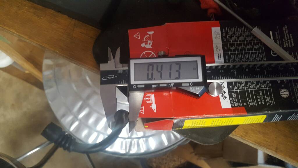

.416 is what I get for the diameter of the panel opening on a Pro 10-10 tank. That's gonna be a mighty tight fit regardless of the lube. Only place for it to give is the inside diameter where the new fuel line needs to go. Another approach may be to cut off the wall collar of the grommet that'd otherwise go inside the tank and hope the friction fit will keep it in place once the new fuel line is pulled through..., if you could even get that through the hole.
Just thinkin' out loud...
