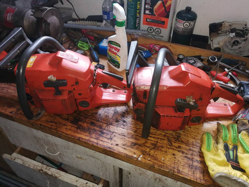

Might as well add mine to this post. These were my dad's production saws, left is a 1994 242XPG purchased in 95, right is a 97 246, purchased spring of 98, which started life with XPG labels. I'm sure it was just badge engineering as I have not found anything different than a standard 246 yet, but I have yet to pull the cylinder.

nice couple saws you got there!
Its tricky to know if there was a pure 246XP/XPG or if it was just a badge.
I've seen 246XPG s/n badges in Japan + 246XPG start cover decals + 246XP top cover decal.
In Europe I've never seen them.
It's also difficult to know if there was a difference or not since Husky never got all their part & part numbers printed in any of their IPL's. There isnt a part number for 246G start cover decals as example, I do own two of them so I lnow they exist.

I wrenched at a dealer back in the early 2000's, I am all too familiar with having a part in hand and it not being in the parts list. I think that alot of the information from the old microfiche didn't make the transition to digital.
I don't think there is anything really special about this one other than the label, and I was with him when he bought it, so I am sure it said XPG. I know the owners manual only said 246/246g, but unfortunately all of his manuals were gone when I picked up the saws.
