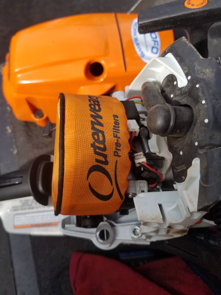

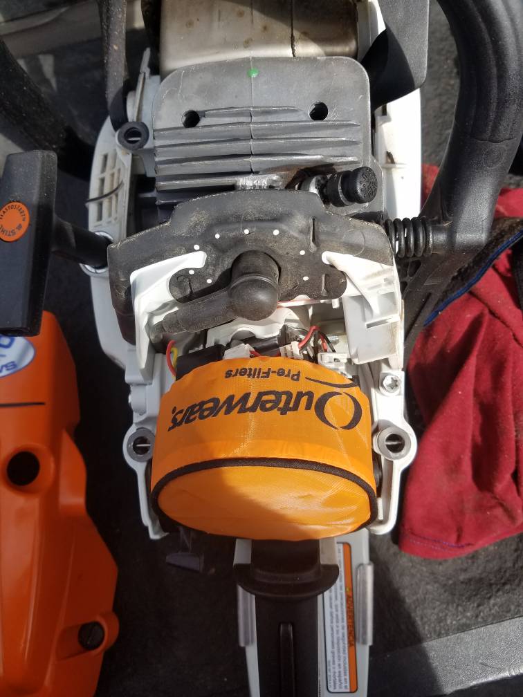

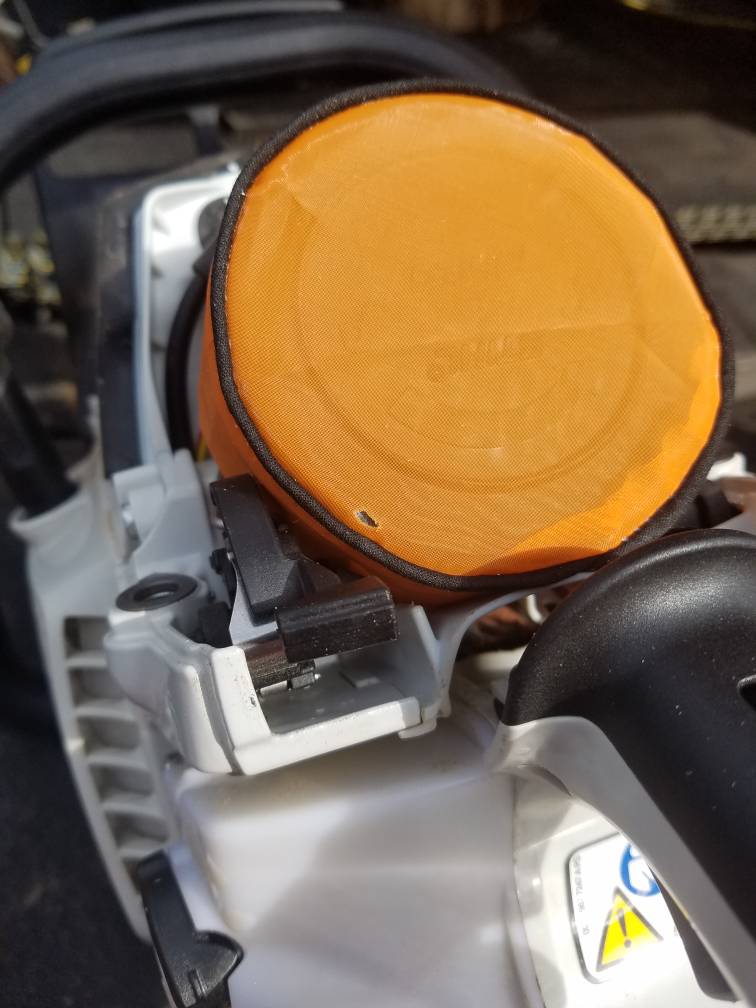

My 261 with outerwear cover.
This cover is brand new. I only used less than a tank putzing around and already a hole. [emoji52]

Yup. I noticed that a fellow member posted a pic a while back that looked exactly the same.

Mine has a hole now too :( but I'm gonna do some shaving with a dremel to remedy that.
Or maybe it's been there for a while and I just didn't notice it, last time I checked it over good when we were talking about it it didn't..idk..

I just got done sanding the spot down that I think was rubbing on it.
Here's a weird one...
My OE 261 which I've used the most with the outerwear has no holes.
My new 261 does...figure that out.
My 241 has no holes, I use it a good bit.
I'm sitting at my bench looking at this *s-word as I type this.
