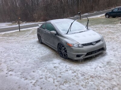

I’ve been pretty well stuck inside since Friday. I have to wear spikes on my shoes to get across the yard but I did thaw out my Element in case a neighbor has an emergency. The roads aren’t decent but everyone’s driveways are brutal. IMG_5629.jpegI should start listing parts for sale on here but…

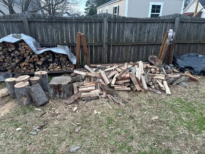

Cut a bed load off the pile, took it home and split all the maple. Not sure why I brought home the gum. I’ve split several face cords of it green and it’s fine. This however is not fine.
All the wood goes in my firewood stand. I donate all the proceeds to children and young adult Autism programing at a local branch of the NC autism society.

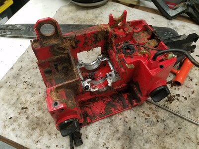

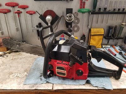

I went through a Stihl TS350 for a guy a few weeks ago, when he picked it up he left a Jonsereds 520. It was a filthy little saw...
The oil pump is literally inside the crankcase, and to replace the oil line and the impulse line you must disassemble the engine from housing.

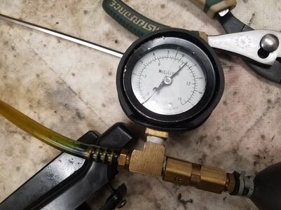

I did have the crankshaft seals on hand, but there was a bit of a leak at the intake boot under pressure so I applied some Dow Corning 732 and reinstalled the boot. Seems to be holding pressure & vacuum now.

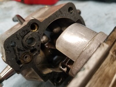

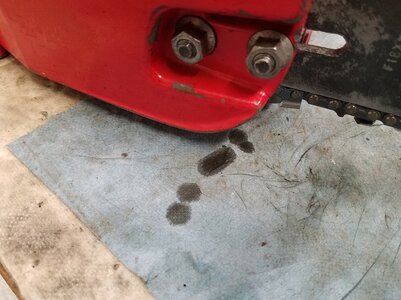

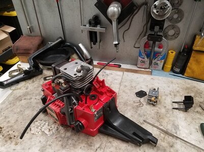

I had to take the Jonsereds 520 SP all the way back down to correct a non-oiling issue, when I replaced the oil line out of the crankcase I did not get the brass insert properly seated and it was preventing any oil from coming out. Here it is after we seated it fully.
Oils now...
