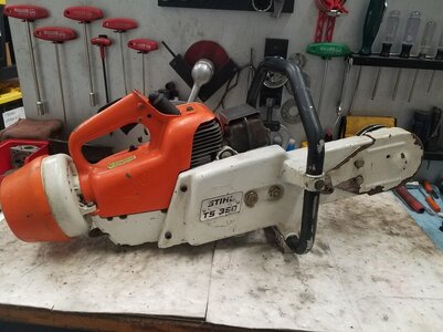

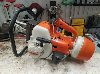

I did notice while taking this one apart that the air vane mechanism is all missing, or did they not equip the cut off saw with the air vane/choke governor?
Mark
I have the ipls for them at home but that’s a newer one and if it’s electronic ignition it’s limited rpm by the coil. Same as the newer 08s chainsaws with electronic ignition. Some of those saws had the sem ignition that’s the same as the 056 and they had a habit of failing.
Mark
Not sure if this helps, but I rebuilt a ts360 (same engine, cases, etc but different plastics and air filter) and it didn’t have the air vane governor.

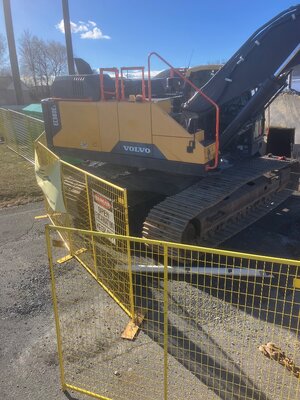

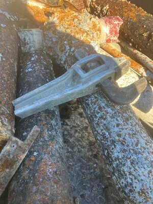

That's one way to do it. I can't say I've ever seen a pipe wrench set up like that.
I got a lifting lug stuck in a 4” bung. I’m pretty sure pulling on the lug hard enough to lift the back of the excavator was enough to trash threads. The tank was 9400 pounds plus it was still partially buried. The hole keeps falling in and there’s no access to the other side so just pull until it comes out.

This is a TS350 if I can read it correctly, points ignition.
Cleaning the old concrete off these is a chore. It will look much better when I am done, I expect it should run O.K. with 150 PSI compression. Piston looks pretty good, a few scratches on the intake side, exhaust if pretty clean yet. I should have it running tomorrow but I will need to get a new v-belt before I try and spin the wheel.

It is back together and runs, but has an unusual miss at higher speeds. Sounds to me like an ignition issue but I've been over the points and wiring, points are set at .015" and the wiring all looks good. I did run it with the stop wire disconnected and no change. I replaced the spark plug but that didn't change anything either. Almost acts as though the points are floating but the spring seems to be very strong yet. Any idea how one would actually change out the condenser on one of these? It looks like the condenser is pressed into the stator plate.
Mark
Are you sure this doesn’t have a harmonic fuel limiter in the carburetor? Most concrete saws have a limiter on the carb or on the ignition system.
