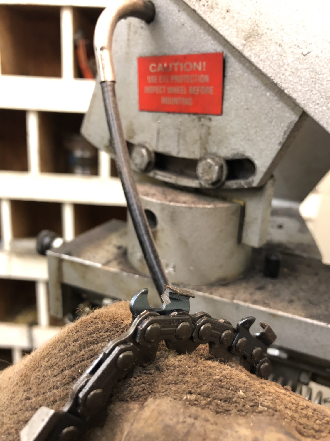

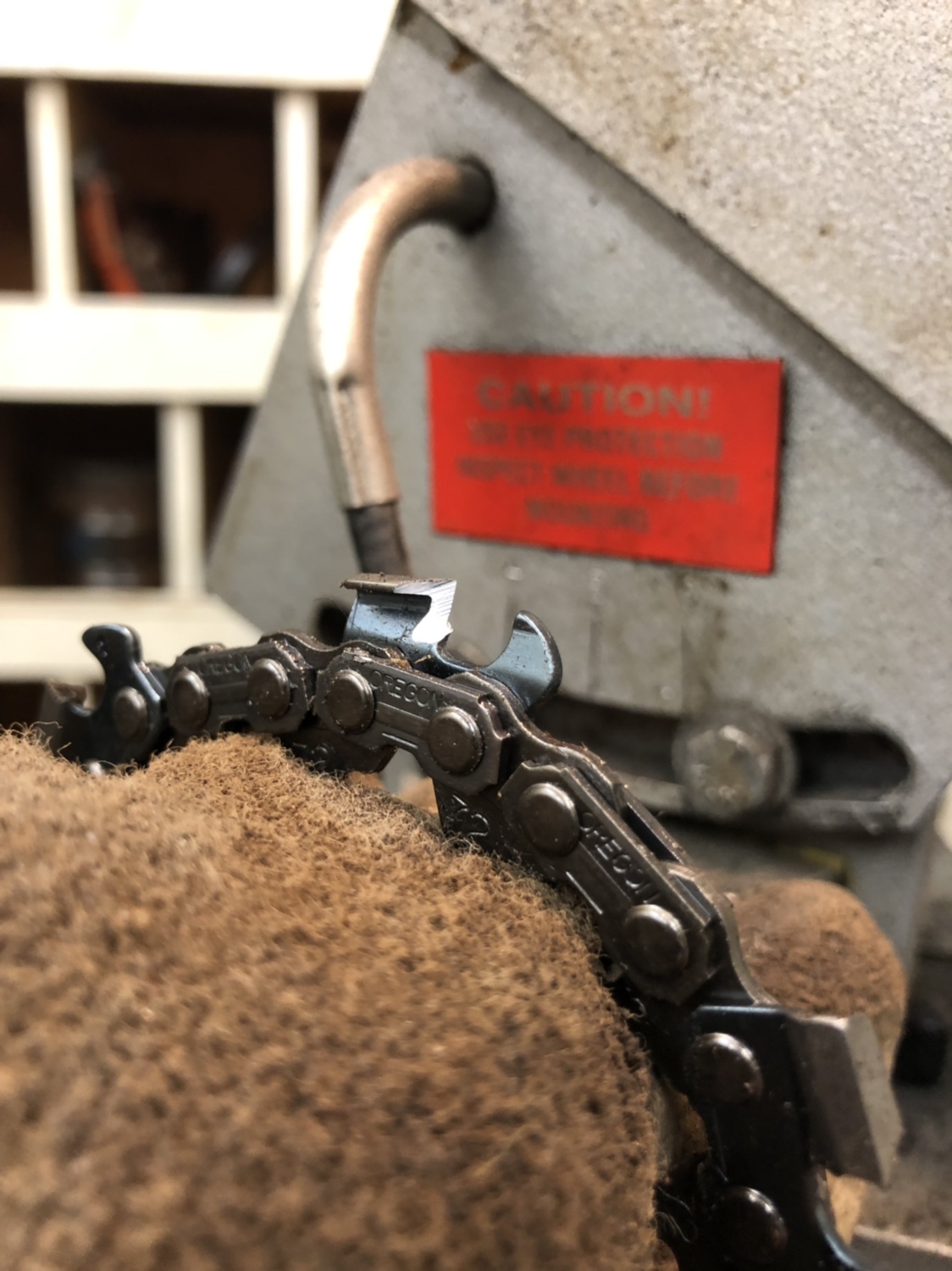

Its decent work chain
Skeans1
12:47 AM
6510
Jun 24, 2018
1,735
9,537
Oregon

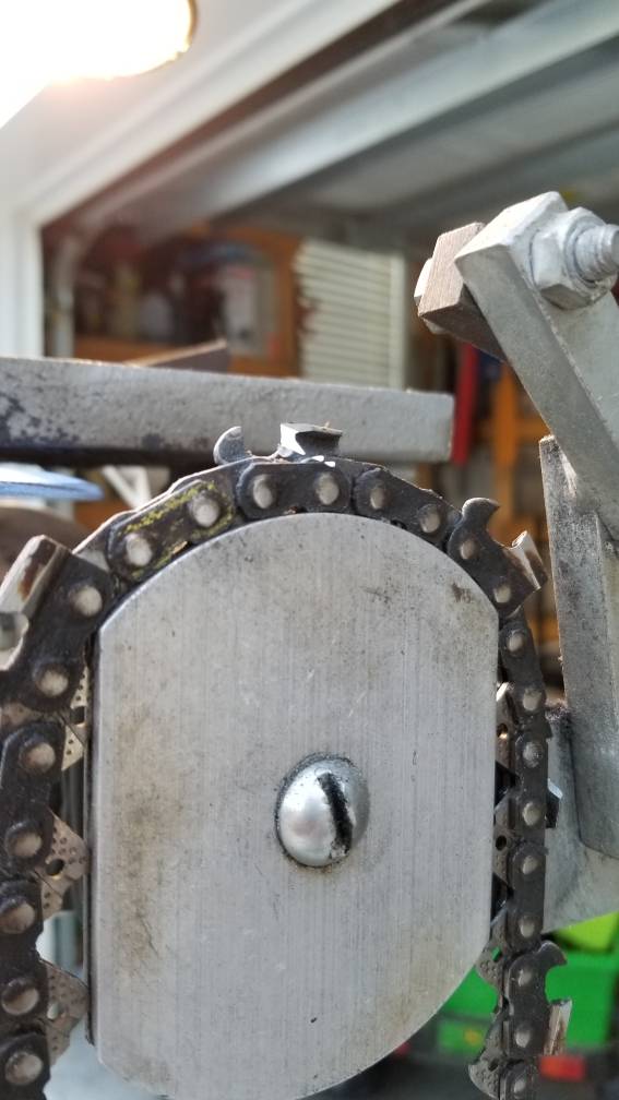

I've been liking that chain a lot.
What kind of top plate angle do you have on that.
42 inner top plate
20 top plate
2 degree side plate
I’ve played around with the settings on the slides and dressers but always end up right back there at the factory settings.

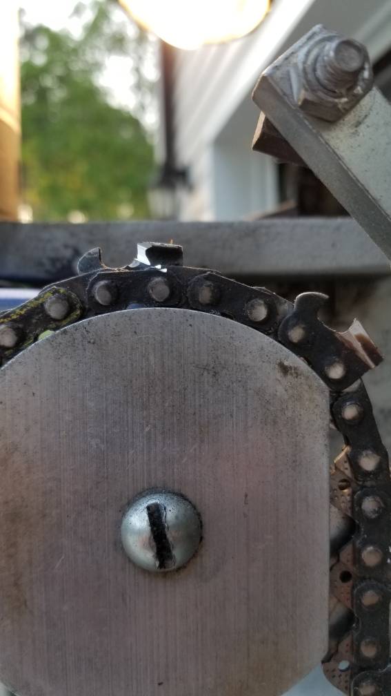

42 inner top plate
20 top plate
2 degree side plate
Thanks, I'm around the same, usually a bit more on the top at about 25, cuts great and smooth as silk.
