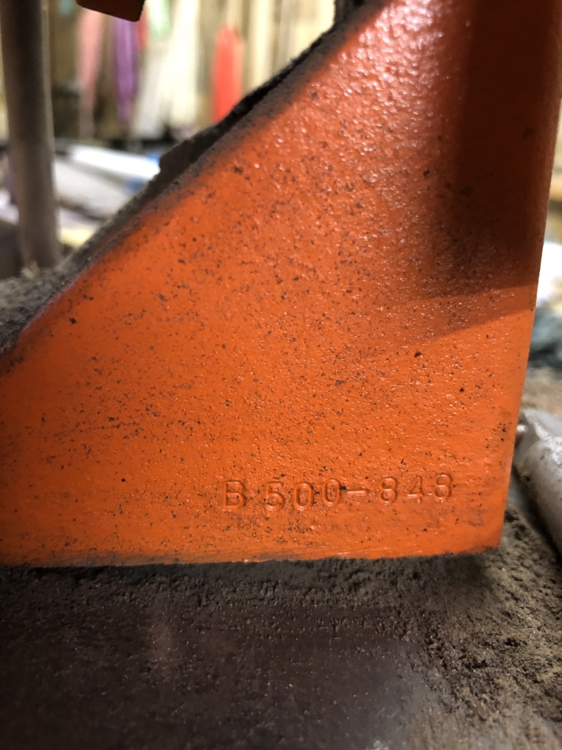

Check out the serial #.
I don’t know much about simington grinders other then we see Kelly down at the show again after about a 15 year break. I’m not sure how early they started doing the 12 volt ones.

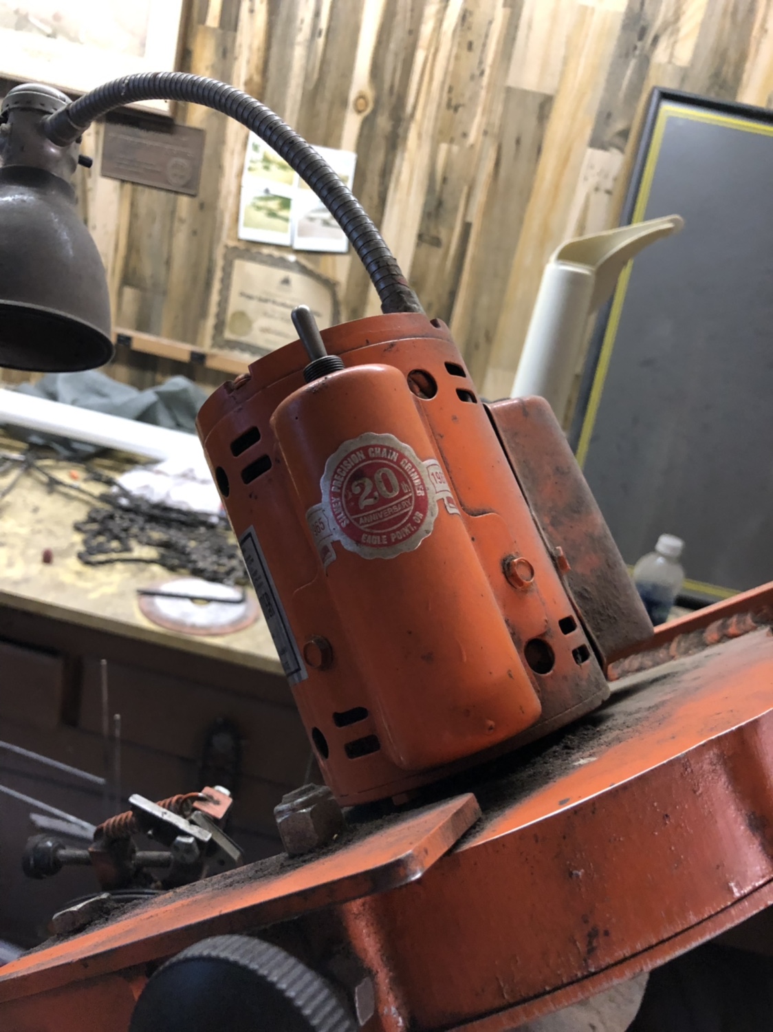

I have a 500 with the rounded chain holder with the small motor.
Here’s a 1985 500

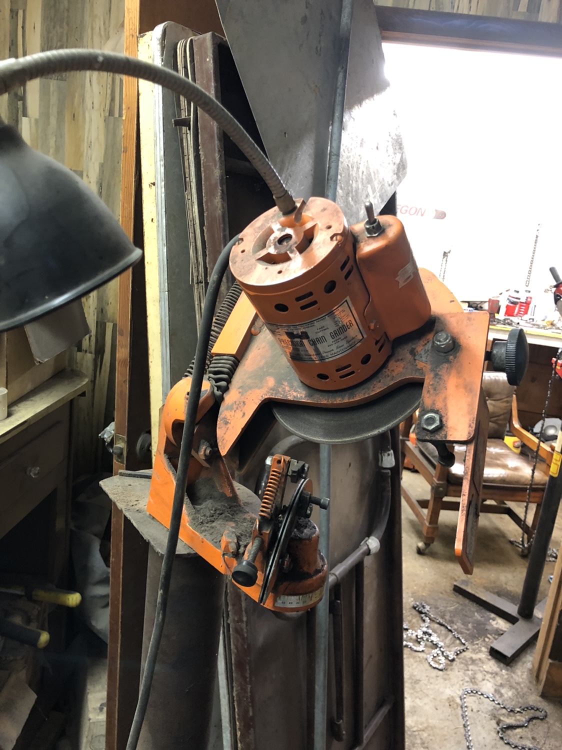

I ended up milling the box off, boring the hole out and mounting a motor like the new simingtons have on it.

Same as mine. While they are smaller than the motor on the new Simington, the motor on the one Brett is dealing on does look smaller in diameter.

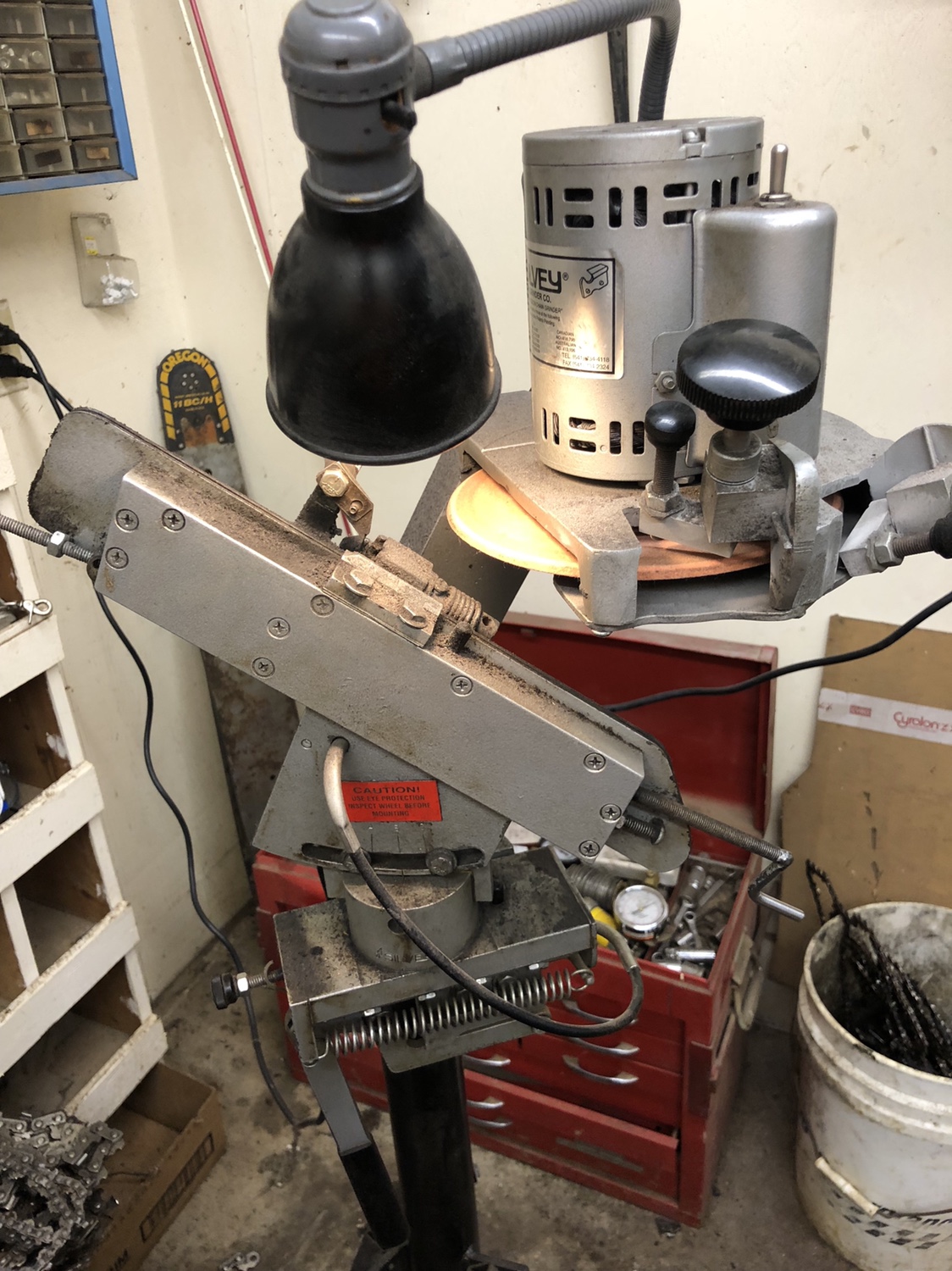

My P&D and pro sharp all use the same motor that’s the larger motor that Silvey put on.
