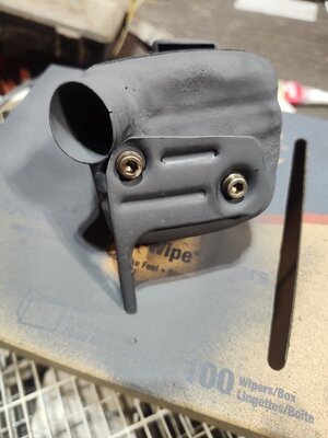

395XP with @tree monkey large deflector with a Husqvarna screen and Stihl exhaust gasket. All three line up perfectly and work together perfectly. The gasket ensures a better seal. as well as reducing screen vibration, this increasing it's longevity. Attached with 5mm rivnuts and stainless steel screws with a dab of hi temp loctite.
What I like is that it looks like it came from the factory that way.
