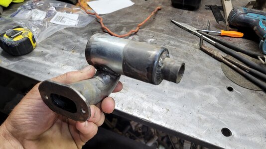

I made this. I can picture it turning into a muffler with packing in it. Its got a 3/4" outlet. This fits the 372 385 saws. Ive never really tested it because my 372 pipe works so well20250613_213124.jpg
Tested the #2 muffler. The deflector muffler just put so much heat against the log and into my hand.
This 1" outlet tube fixed that.
