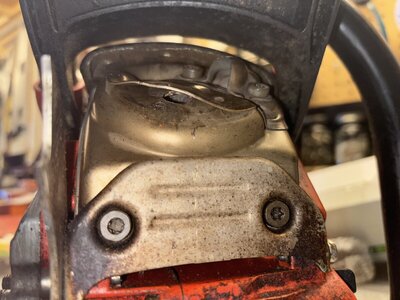

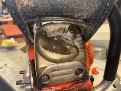

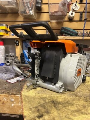

Hello! Has anyone done a modification to a Stihl 056 Magnum muffler? Looking for a few ideas for the front. The original design isn't really inspiring the addition of round pipes or tubes. This would be on the lower half, where the top cover cut out is.
Thanks!
After a few attempts with round pipes, square pipes, and all sorts of odd protrusions, this seems to be the answer. Looks good, sounds great, and doesn't hit anything. The 056 is a very "square" saw, so anything round didn't look right. Stock mufflers tend to be fairly bashed up, and decent covers are hard to come by. This fixed a few problems in a close to stock look.
This is on an early 056 Super, without the factory side pipe.
R.

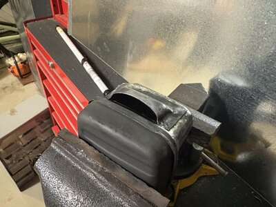

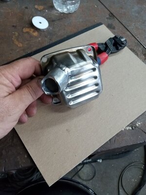

First time trying Mapp and silver solder with a Dukes medium wide deflector. I used to use bronze brazing rods but haven’t had good luck using it lately. This came out great though. Husqvarna 346xp.

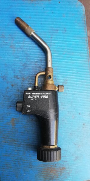

Is that using the standard tip, or is there a soldering tip for the Mapp?
Partner
7:18 AM
11875
Mar 2, 2020
2,332
6,388
Poland
I have a burner like this, only with a small thread for cans that are more popular in Europe / I'll see what the symbol is/ German but looks the same. The Chinese also learned to produce them 😉

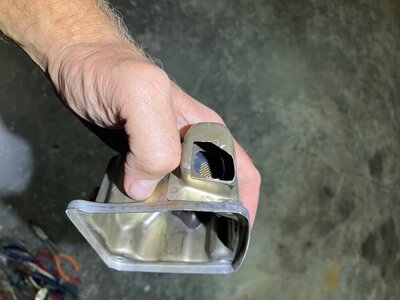

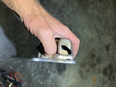

Da dog man
1:18 AM
28881
Apr 6, 2024
141
343
Indiana

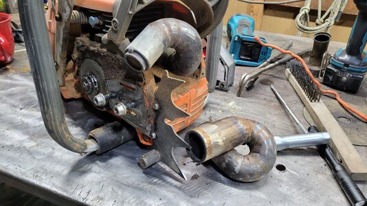

Thanks that stainless muffler cover will evaporate quick if you ain't careful stole the screen idea from a few posts back jus sandwiched between another section an welded an blended
