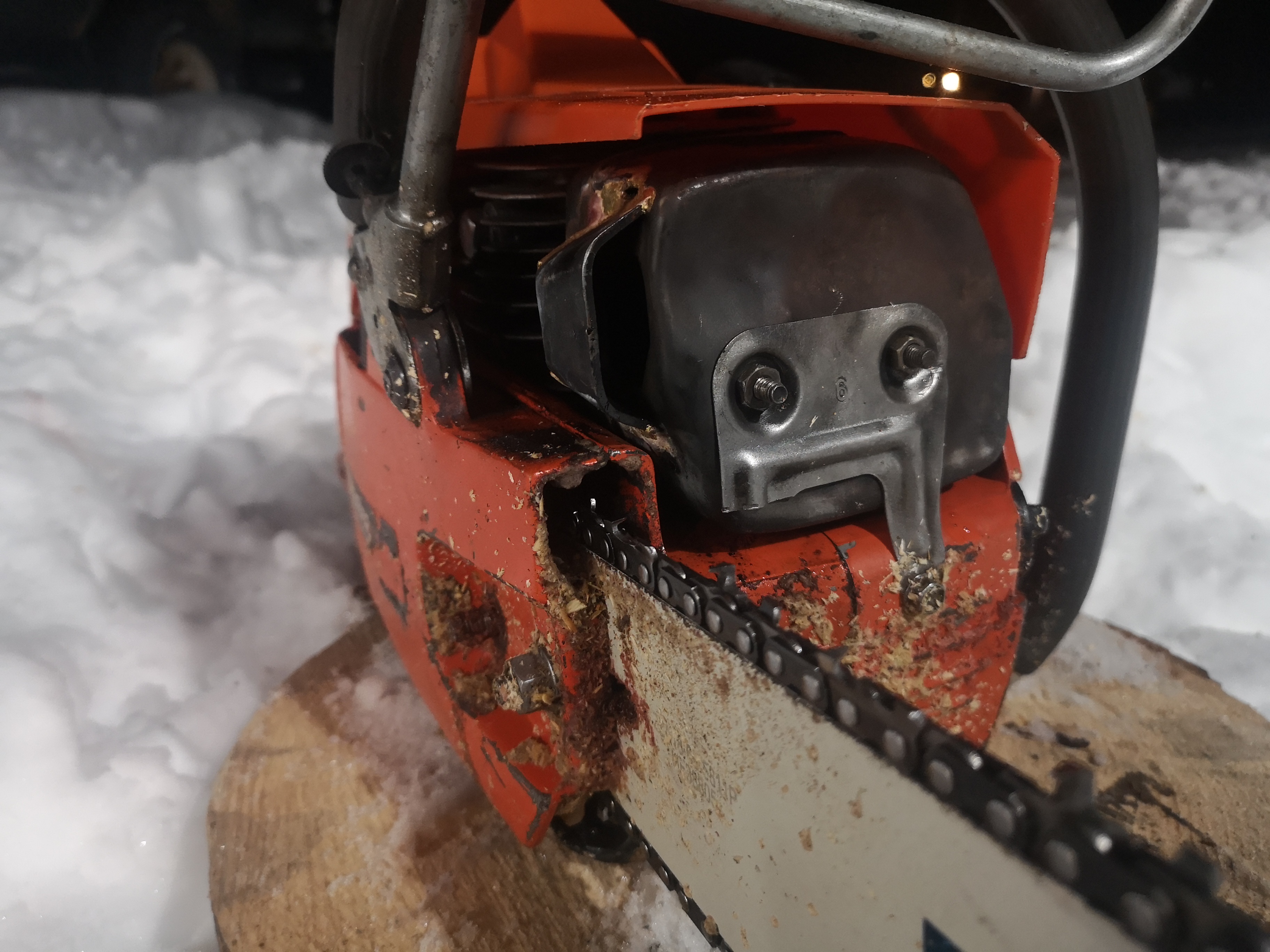

I cut the bottom open like a banana. Cut out all the junk inside and welded it closed. Cut the stock deflector off and opened the outlet up to approx 7/8” hole. Welded on a medium sized Red97 deflector.
Painted with VHT header paintView attachment 282826View attachment 282827View attachment 282828View attachment 282829
