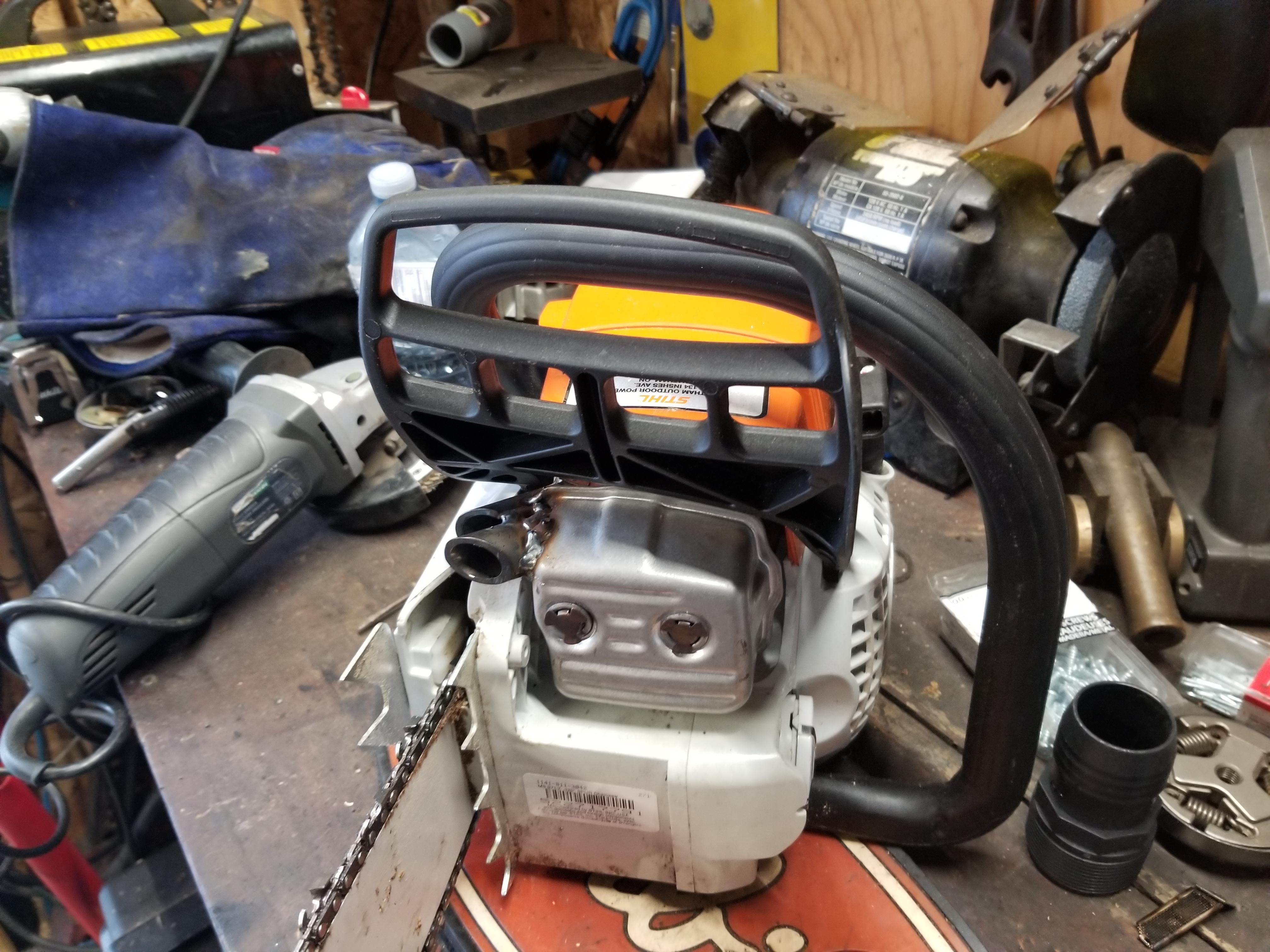

Grinder and paint well... you fellas know the rest
View attachment 272467 View attachment 272468
That sure looks a lot like the one I'm playing with currently!!

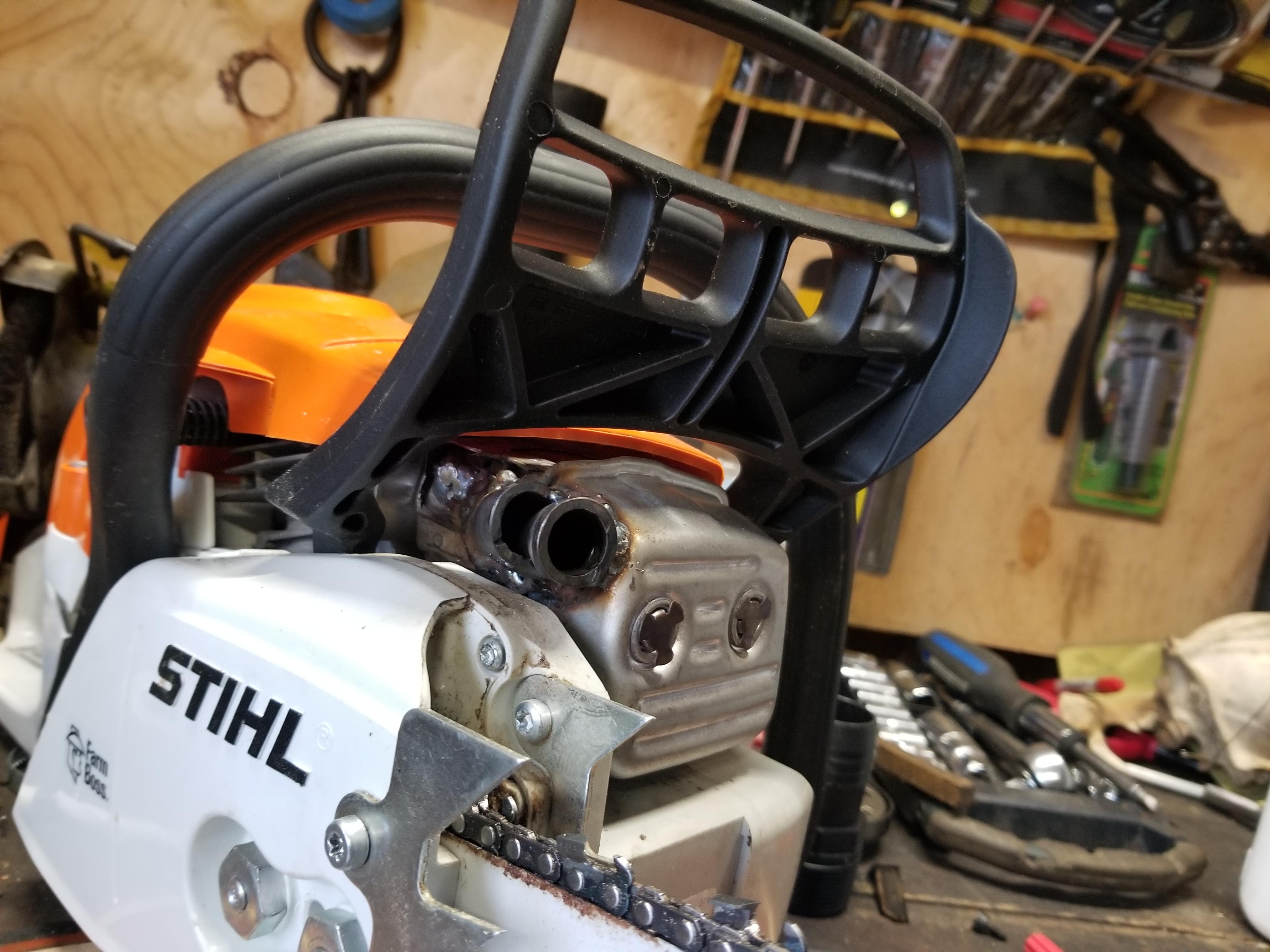

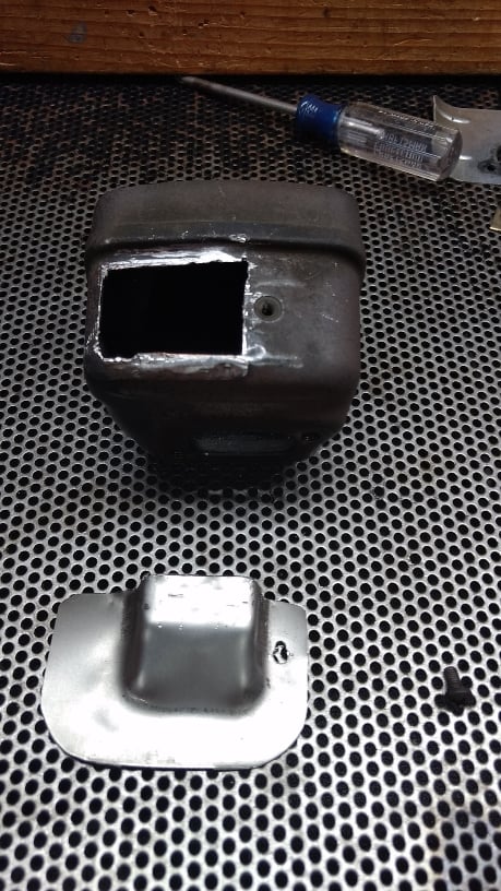

2159/359 Muffler... Split it, gut it and started to weld it back together. Couldn’t finish it tonight because Ma was done with spaghetti and the warm house was calling my name lol. Fugly aint she? There are some pretty significant gaps because as I was peeling up the cat it was also peeling off part of the muffler‍. 5C617490-F73F-482D-89A2-D9543D5CB4D0.jpeg7551708E-2C46-427F-AE56-395DB2393A54.jpeg65960079-1C44-4906-9D1E-B9759B484408.jpegFFB0834A-5DEC-4CE6-8967-435C8E6D7F11.jpeg

May we ask what brand it is -- so we can steer away from them :D
Not sure to be honest. It came with the saw as is. It’s weird though the husky aftermarket mufflers are usually thicker than oem.... but it seems to be the other way around with the stihl aftermarket mufflers. Not to mention the aftermarket brazing/welds are rather poor too. It’s still hit or miss with this aftermarket stuff in general though.
