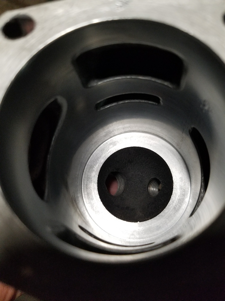

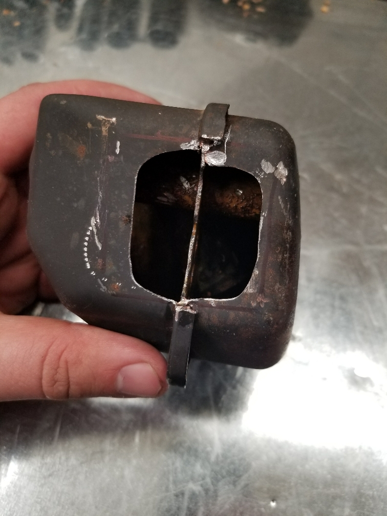

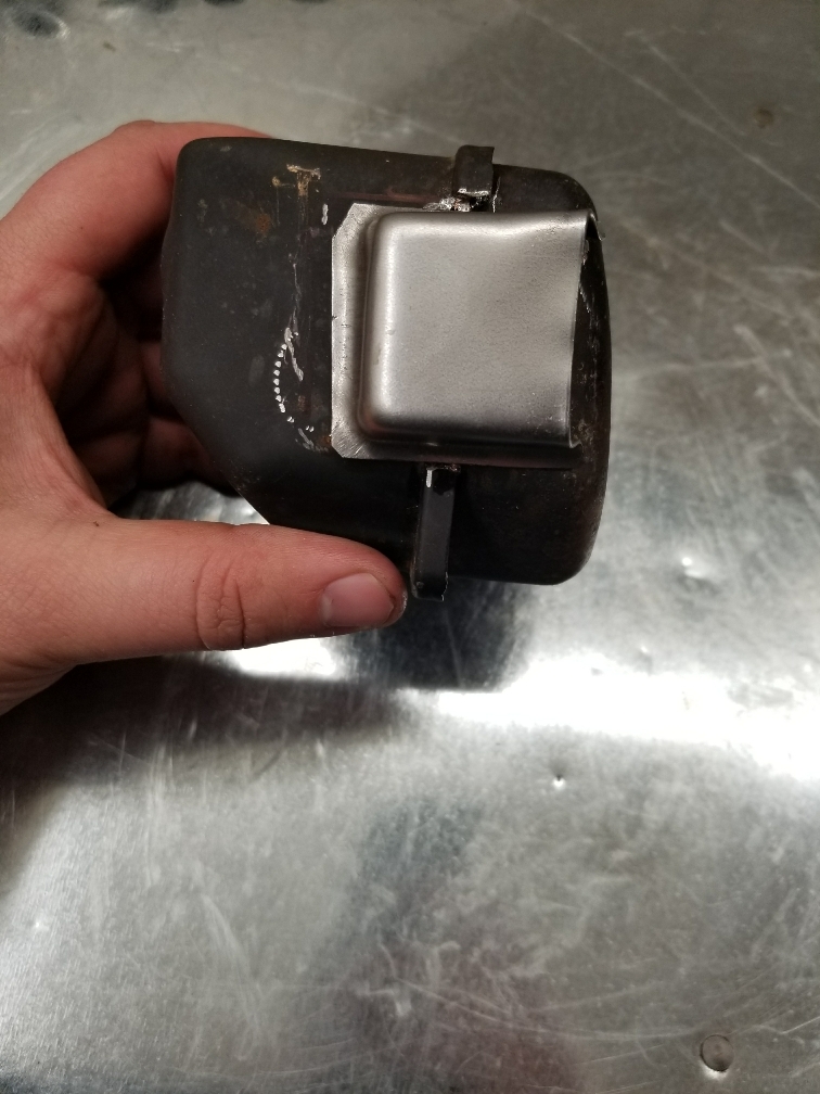

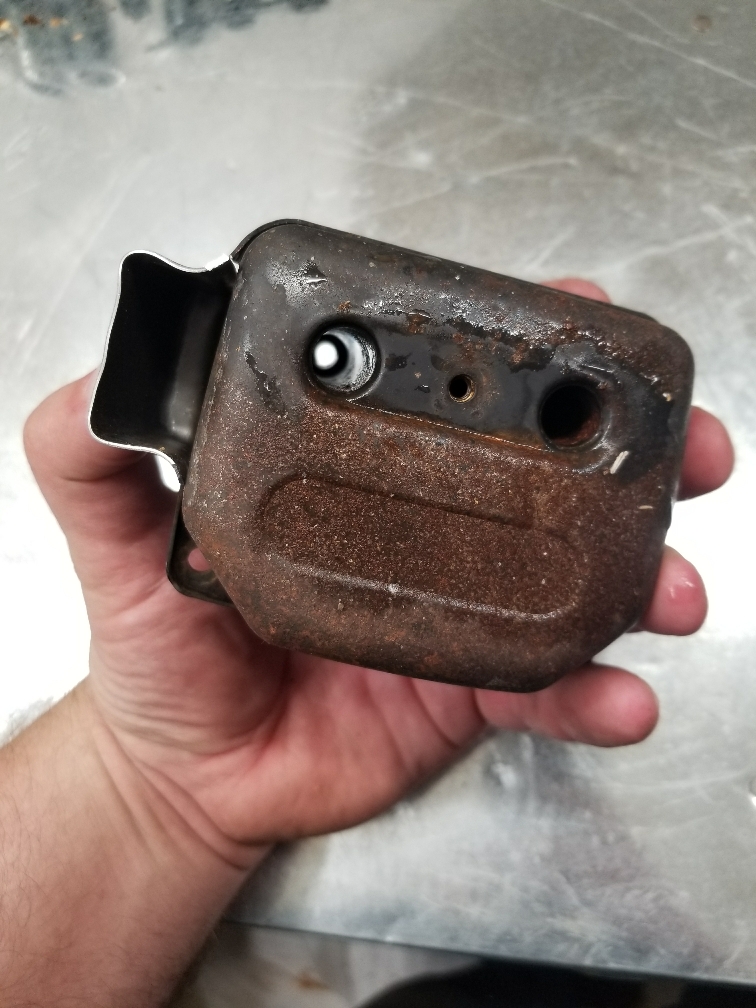

Quick and healthy muffler mod, one of my large deflectors. Will cap the factory top deflector, as it is touching the top cover.

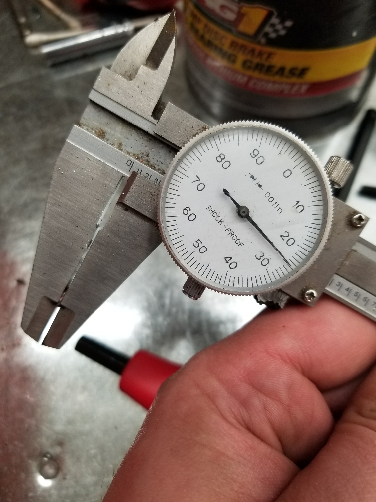

Squish cut, not bad for a wild guess on how much it was hitting at first.
Depending on where the compression comes in I may try a 064 piston...
