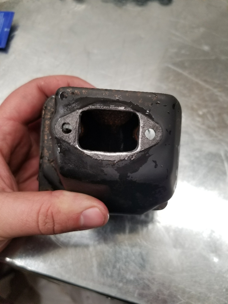

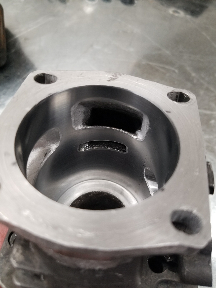

1st round or porting roughed in and ready to stick down..
Matched the muffler.
I plan to run this with the stock carb/air filter setup for the short term. See how it stacks up against my other 73cc echo hybrid.
End goal is larger carb, probably wj, with a maxflo filter setup.
Oh yeh, and a 54mm version is going to get her soon. See how well 86cc likes this chassis.
@lauren thank you for the motivation, and pointers along the way.
