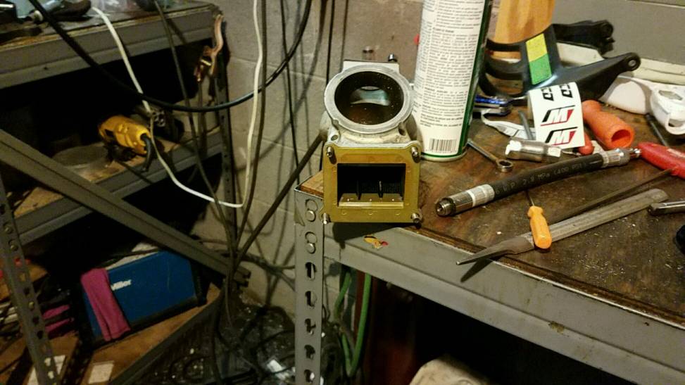

mdavlee
Hillbilly grinder
11:36 PM
279
14,194
64,635
TN
880 cylinder Adam Clarke welded the reed valve on that I have now
