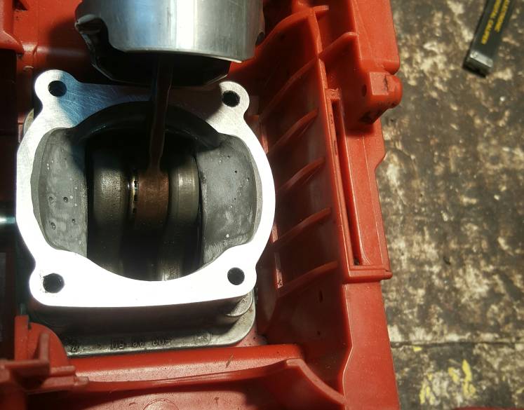

The first husky 350 i did I hogged out the lowers and it had alot of rpm but not much torque. The second one I filled the riser with jb weld and you could really lean on it.

You added a lot. What numbers did you end up with?

You using the 350 jug or 346? I ask as the one 350 I have that I ported is a stock 350 jug with a meteor flat top piston and it has the most open lowers you could have without grinding into daylight and it has really good trigger response, good torquey powerband but not quite as much rpm as my 346's do. Its a sweet little firewood saw but I like the 346 better for straight-up limb work.

Using the 45mm jug, hlsupply 353 piston with caber rings. I had a 346 here I ported and that saw was right on its heals. I was trying to find a way to get the 350 to run as good as the 346. Imho, I think the 350 lowers are to big and you lose to much case compression.

Another thing I've been messing with is staggering the transfers. The last 2 346 I did, the clutch side trans open 1 /1.5 degrees before the fw side. Both have alot moregrunt then the first saw I did with the numbers / grinding being the same for all 3.

Entry angle and direction is huge.

There's a cheesehead, 2 guys from Canaanada and a logger from the west coast that I'd love to hear their opinions on transfers.
What I strongly believe though is direction of flow is equally if not more important than volume. Air is a fluid as most of us know, and with oily liquid in suspension is even more fluid like.
Speaking for fun, I bet that if the transfers were aimed "correctly" you could reduce blowdown buy 3-7 degrees.

This^^^. I try to visualize what transfer angles will kick out the rest of the exhaust without blowing a ton of fresh charge out with it. On a quad port, I think getting a flat entry is beneficial in that it lifts the exhaust toward the exhaust port rather than mixing in turbulence. Also, pointing the entry angle of the intake side transfers toward the intake continues pushing the exhaust out but keeps the fresh charge away from the exhaust port for maximum retention if you don't have excessive case pressure. Next is the exhaust side transfer window, I think that straight in is a good approach, perhaps open it a degree after the other transfer port so that as the exhaust is being lifted the second transfer window opening forces it out. I also think dual ports should be pointed toward the intake. Just a theory. Sorry if that's not clearly written I'm tired

I like the primary flat and pointed directly at the intake. And the secondary aimed upward and also toward the intake
