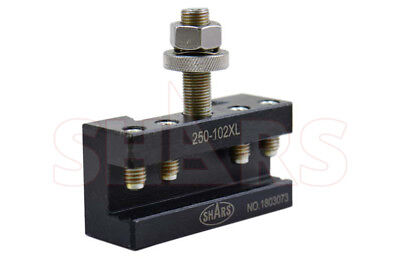

Side note: if those turning tools are too thick, I can toss them in the mill and machine them to a specific thickness.
Those were for an AXA wedge style tool post
They make XL tool holders that will hold 5/8" tooling in the AXA size.
