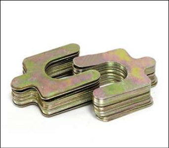

I just got a full set of these tools and used them on an old 066 yesterday. Very sweet! Beats beating with a hammer. I think they could be adapted for pulling bearings into case halves as well. Heat guns do work well but these might be worth a shot too. Thanks again Matt.
Can't help but wonder if something along the lines of auto body shims could be made for centering the crank during assembly.?
It will center itself, if you let it, by doing the flywheel side first and placing the bearing fully in the pocket. This will automatically index the crankshaft in the case and the PTO side bearing simultaneously.

Oh, I have those crank tools from Matt...yeah, they are awesome. I was wondering how you would use the autobody shims. As for pulling the bearings in, I just use a bolt, nut and about 10 washers (sometimes I can get away with less than 10). Once I get the bearing set initially as straight as possible, then I assemble the bolt, washers and nut and just crank the bearing in with the ratchet drive.

In the video he uses a small piece of cardboard as a spacer to let him know where to stop when pulling the crank through the first bearing. I was thinking auto shims would work better.
