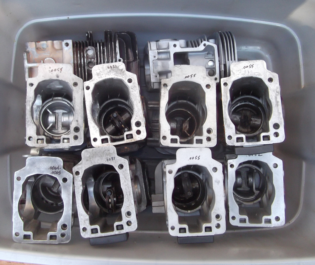

Dang JJ! That’s a lot of cylinders! All yours?
I had to mike-out some cylinders and pistons today as well.
Interesting - the opening on your muffler is a lot smaller than others I've seen. I don't think it'll be too much work to port match it though - is there enough meat on the flange to do that?
Yep - all cylinders for builds I'm doing this spring/summer. .030" over 125 x 2, .010" over 125 x 1, stock bore 797 x 2, stock bore 101b x2, stock bore 125c x 1, and .020" over 125 x 2.
