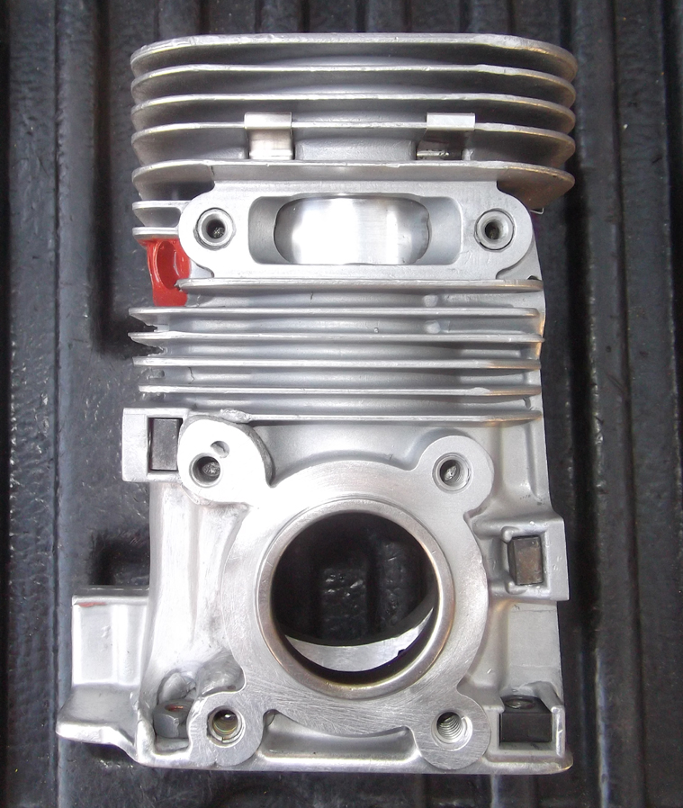

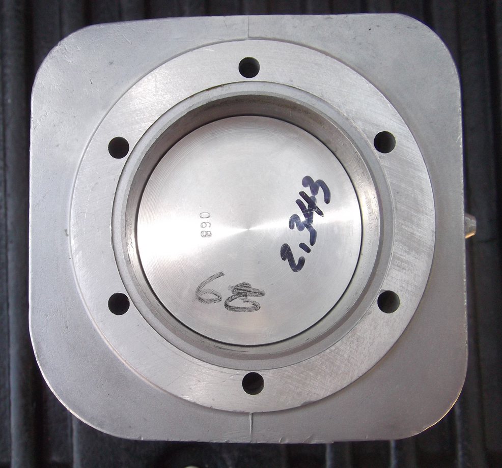

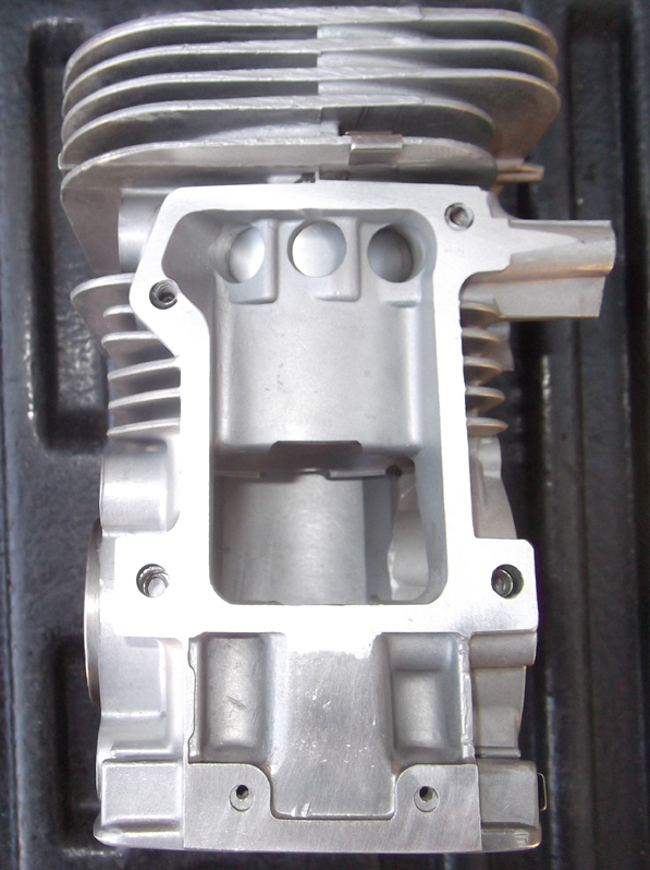

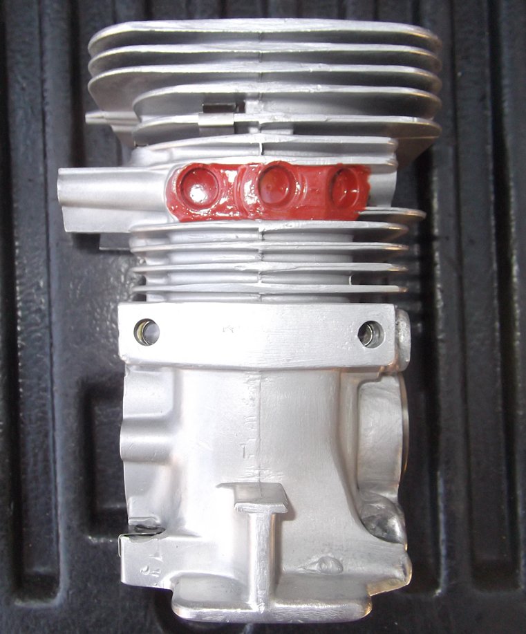

Is this one of your dad’s old cylinders? And is this going to be one of ones you powder coated?
Nosir, the largest bore my dad's kart motors have is .020" over, but I'm sending that block in to take it to .030" over. This block I paid $18 for at a swap meet in Salem
a couple years ago. The old guy that had it didn't even know what it was. The bore was around .050" over but was in real bad shape with a lot of pitting. I had a NOS
Wiseco .080" over piston I'd bought years ago but Terry found this Burris .068" over slug and rings which put the bore back in good shape. I did some porting on
the block prior to having it worked over.

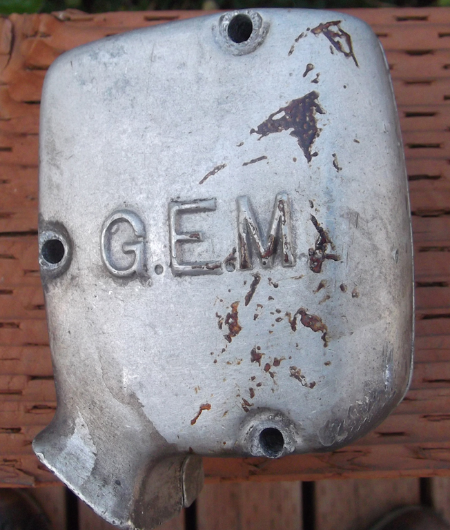

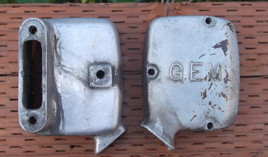

Got a couple gem box mufflers to test out, Eventually going to try a back to back test versus the park muffler, will be interesting to see the differences. View attachment 236630
I've got a similar one - a version that was popular in the 70's on the Super Series engines.
